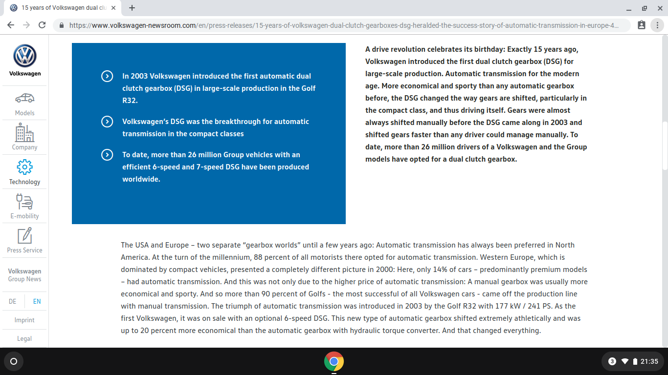

Surprising that the lady at Skoda UK is not saying that they introduced the characteristic last year in celebration of the decade and a half anniversary of VW's DSG production.
Vorsprung Durch Technik, 'never learned not to treat paying customers like morons' especially in the age of Social Media..
