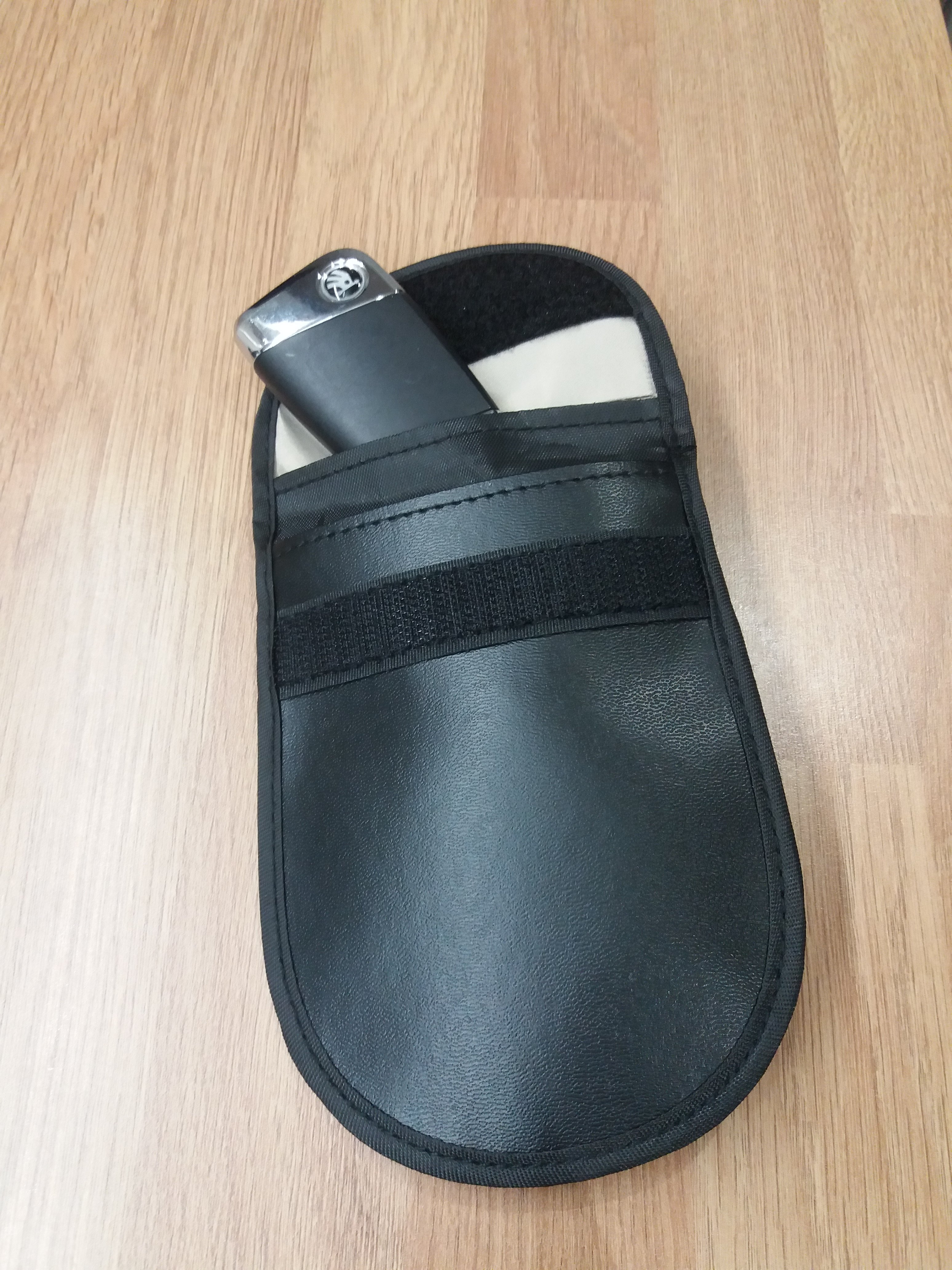

As mentioned, my £6 snake oil covered Faraday bag works a treat.
The best bit, it required zero effort, was delivered through my letterbox, and the £6 was for two.

I didn't read the reviews. I popped my key into the pouch of snake oil, stood next to my car and discovered I was unable to open the door.

BTW same snake-oil I bought for 1.5USD (free shipping) for testing.
But if course on even greater mastermind than myseld could protect itself for free burying head in the sand.

I don't follow you, burying your head in the sand isn't going to help.
My greasy pouch however, does exactly what it says it'll do, and block the key's signal.
Thiefs are using amplifier to rely the signal. Car is not using amplifier. So it is not sufficient that you cannot unlock the car door. Thiefs can sense and amplify the week signal (escaping poor protective  casing) even car cannot get it. That is the point of this attack.

It blocks the signal to your car. That is what you prove if you cannot unlock the car.
But if you read the article and learn lot of electromagnetic and inspect your bag and perform spectral analysis and investigate Chinese hacking electronic... you will find that weakened and distrorted signal from your bag (which is distorted in such way that car is not recognise it - that is what you tested and you think it is sufficient) still carries information (signal in border or partial spectrum ranges) which can be acquired, amplified and rectified and then relayed to car.

You're assuming my pouch isn't effective. As with everything in life, some versions of the same product work better than others.
