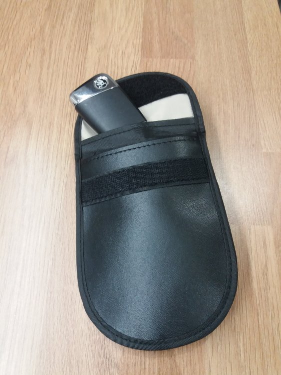

I purchased Defender signal blocking pouch RIFD from Amazon £8.99 for two. I have three yale size house keys and a small padlock key attached to my fob and a couple of small barcode tabs for screwfix and petsathome, it all fits inside the pouch. I used the other pouch for my spare keyfob, stored with the skoda document wallet.

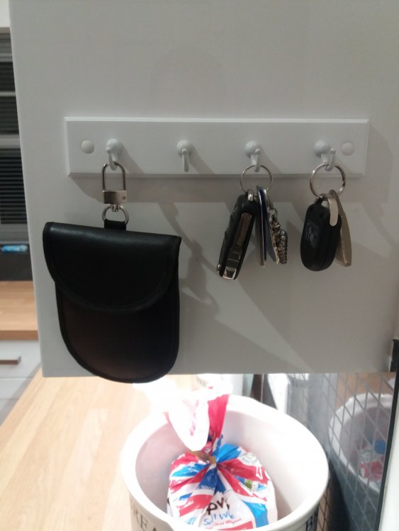

We have one of theses in our key draw very effective I’ve even put the key in it and stud next to car and it won’t open
very low tech

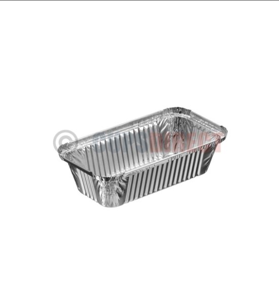

Here is scientific paper with forensic tests of different Faraday bags and other protection for RF / Keyless transmitter
https://www.google.com/url?sa=t&source=web&rct=j&url=https://ro.ecu.edu.au/cgi/viewcontent.cgi%3Farticle%3D1165%26context%3Dadf&ved=2ahUKEwim2smO7rjgAhWJl4sKHTdABFwQFjAMegQIAhAB&usg=AOvVaw2WQjZIUDsbiiJYskXjQRo7
Clearly, plain Aluminium Foil (used in kitchen) offers best protection.
So don't waste your money on bags or cases.
Especially that most of these don't offer protection at all (any success rate greater than 0 means that thief's will be able to steal your car if they wait few minutes - maybe they will fail first attempt but in next few LR/RF key validitycycles - each is 1 minute - they will get access)
