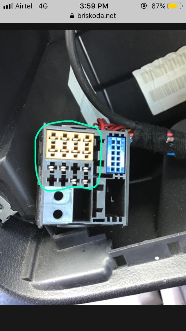

The adapter for the dance radio is different from other skoda radio. You will have to find quadlock to iso connectors, its simply plug and play.

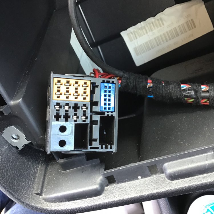

This is the connector in the car, it would appear that it is more a case of the canbus being different and therefore not plug and play, hopefully a canbus simulator will solve the Bluetooth issue but I am keen to keep the reverse sensors and illumination so I’m keen to hear if anyone has got it working ok

If yours is a 2011 car then it is running a different canbus, the earlier models they are not plug and play despite having the same connectors

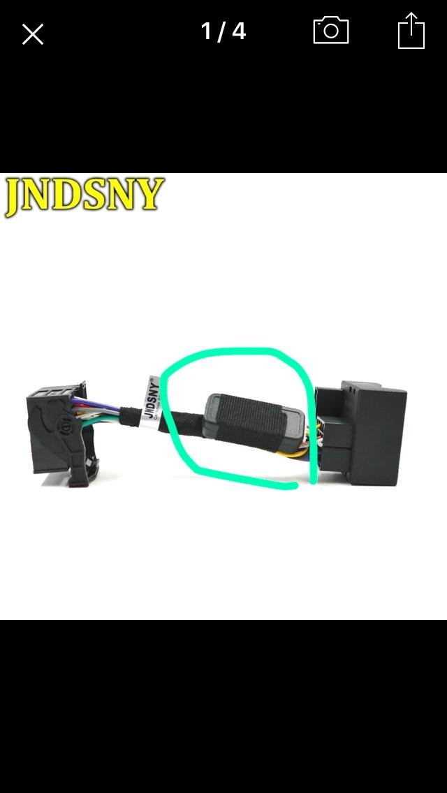

Highligted is the canbus simulator.! It will take care of battery drain and backlighting of music player.
The only demerit is you cannot set the clock in the music player.
4 minutes ago, Kumarrjayant said:
Thats the whole point, The connectors are equipped with canbus simulators, iam not a mechanic by profession, until my car was taken to the garage to connect canbus wires to the bcm i used these adapters.!

I bought one of those and it’s not a canbus simulator, there is no canbus socket on the BCM on the pre 2010 cars to talk to the RCD330.

The canbus simulators will simulate the functionality of canbus in a non canbus equipped car like a 2008-2010 fabia.
Not this, the wiring part is pretty much very complicated .! Try using this.!
Rs. 1,796.91  6% Off | JNDSNY RCD330G RCD510 CANBUS decoder CANBUS simulator multi-function steering wheel simulator for VW Golf 5 Jetta MK5 Passat B6
https://s.click.aliexpress.com/e/ccL7oiOc
or
Rs. 1,419.55 | RCD330 RCD510 MIB Rcd330G Multifunction Steering Wheel Button Control Canbus Gateway Simulator For VW Passat Golf 5 6 MK5 Touran
https://s.click.aliexpress.com/e/fLaVK5E
it will surely work .!

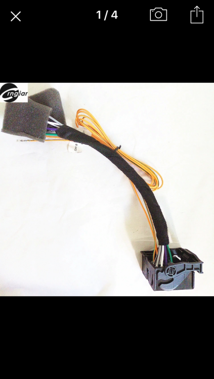

This is what which is used in canbus equipped cars example fabia 2011. Do you see the yellow wires you have to connect them to BCM CAN+ and CAN-
For vehicles without canbus a simulator is used to simulate the functions of canbus.! You do not have to connect anything extra other than connecting your dance radio pins to the female part of the connector and then connecting it to RCD330G

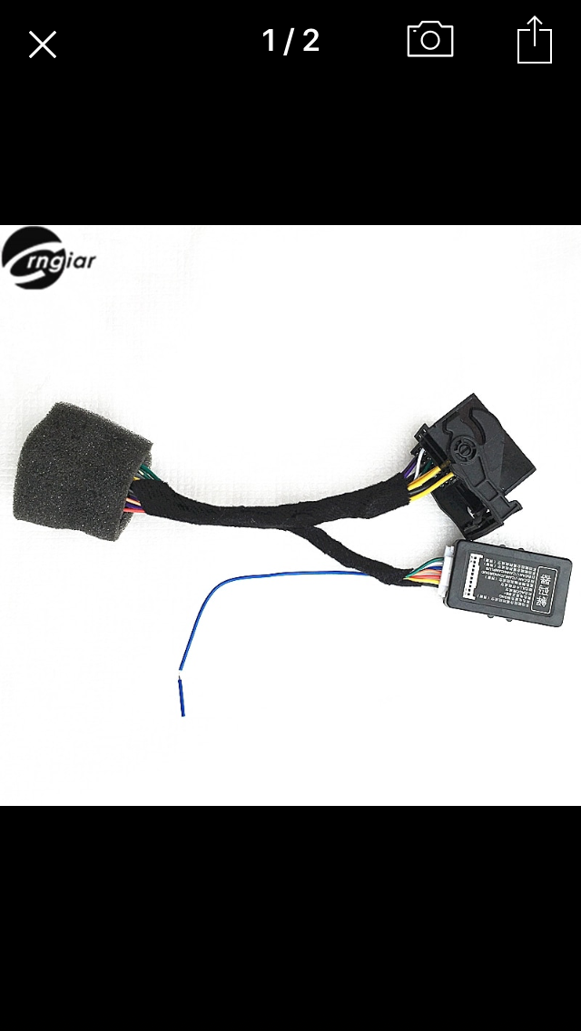

What does the blue wire connect to? Is that the one marked as illumination? I’m guessing that’s to connect to a feed from an illuminate dash light to turn the stereo back light on.
what is the connector under foam end?
The connectors under the foam end are these.!
The blue wire connects to the rear view camera.!
You do not have to worry about backlight illumination as the Canbus simulator will take care of that.!
