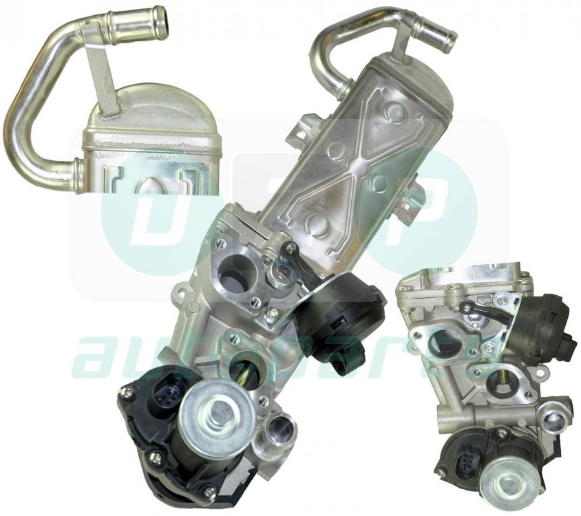

Is this the egr valve?
Yes
Tucked nicely away behind the DPF
Not as easy as your old Skodas or Mondeos :sweat:
