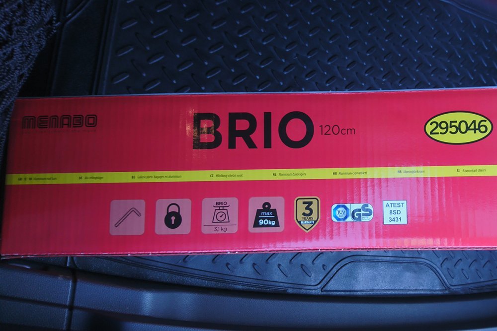

    Just checked my box which shows  311606 and has Karoq listed as a fitment on the side so they are the right ones, expect some of the boxes were printed off a while back. They look and fit just like th
18 minutes ago, Hairball said:
I was away this weekend looking to get home in time to get the Aldi bars however yesterday I popped into a Lidl store in the midlands bought the last boxed set of the 120mm versions.I don't know the fitment yet as I'm waiting for the new Karoq to turn up.
If it quotes the Seat Ateca then they will fit, are they the same as these?
Thanks don_kiddik  my roof  bar box  box states good for the Seat Ateca however the number in the yellow oval in the photo is different from mine and is 311606 on my box. I'll confirm when my car arrives if all fits OK.
Just checked my box which shows  311606 and has Karoq listed as a fitment on the side so they are the right ones, expect some of the boxes were printed off a while back. They look and fit just like the Aldi bars in Vikinguk's post.

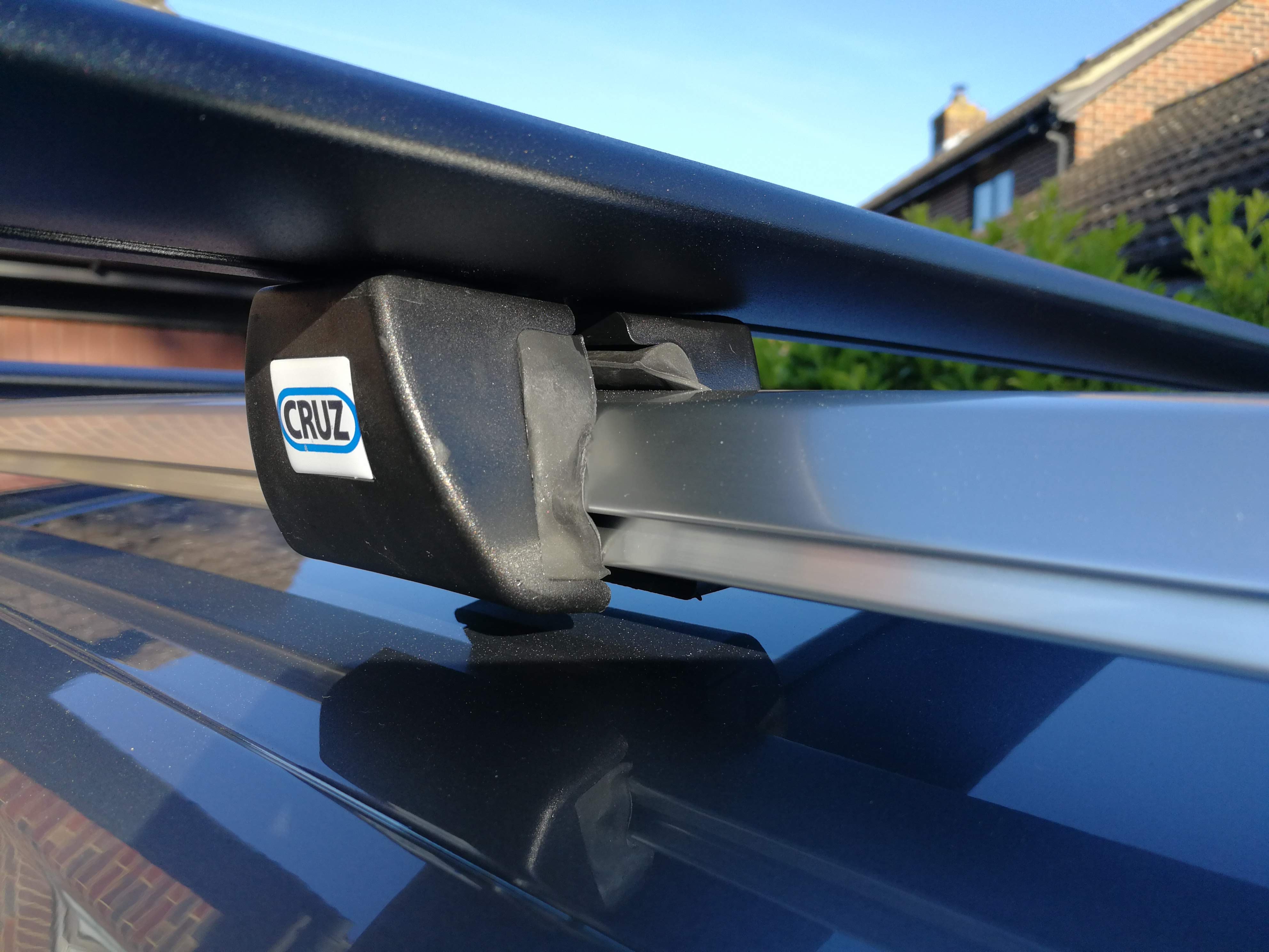

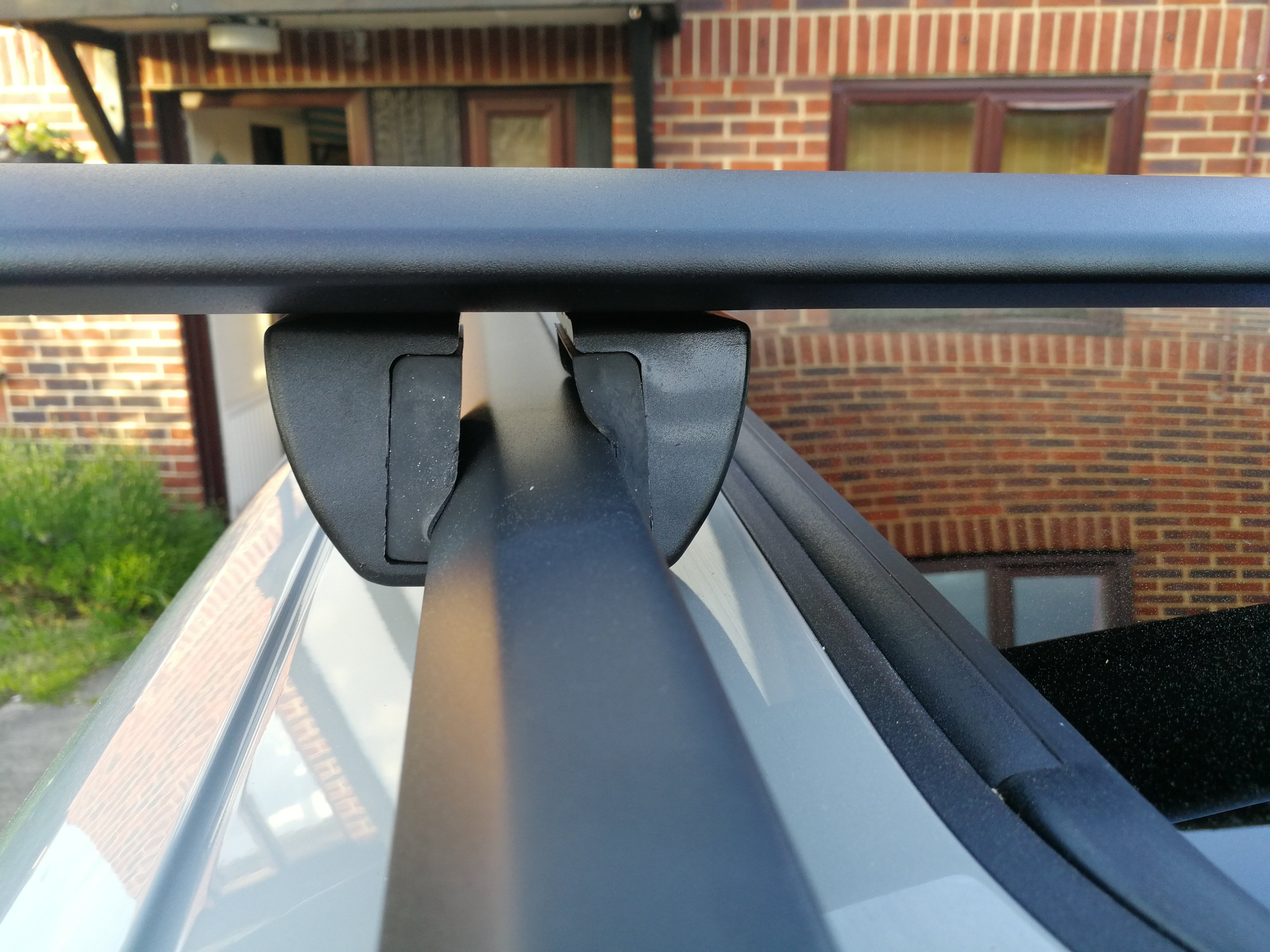

Ok arrived today - they look great and seem very easy to fit..... however, they either touch the roof or they have a gap under the roof bars...... is that right??  I am now in contact with RoofBox about them......
Hi props a photo might help determine if these are correct, can you provide?
Of course :)
Don't like the look of those!
Doesn’t look right to me i would get in touch with them and question

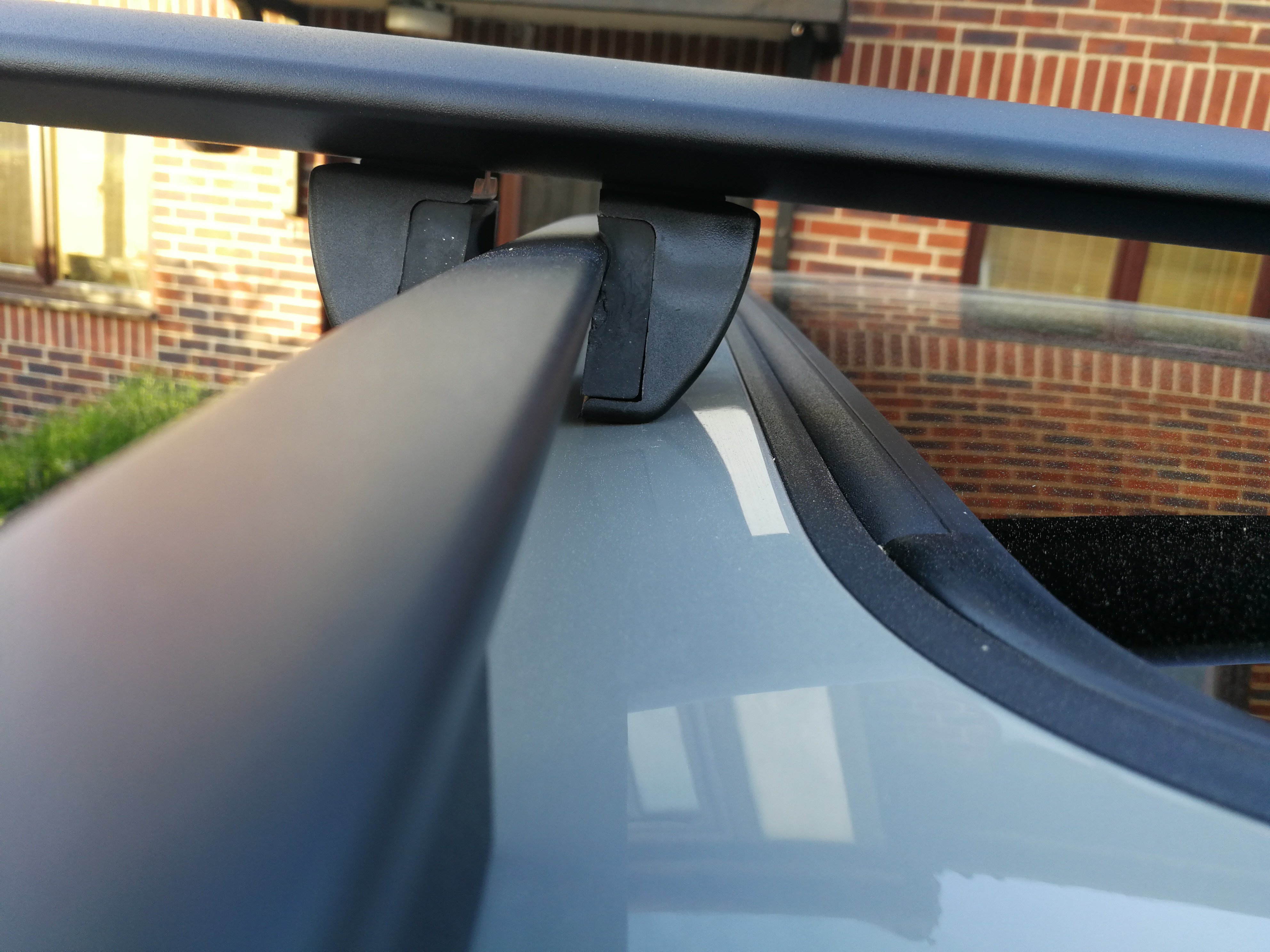

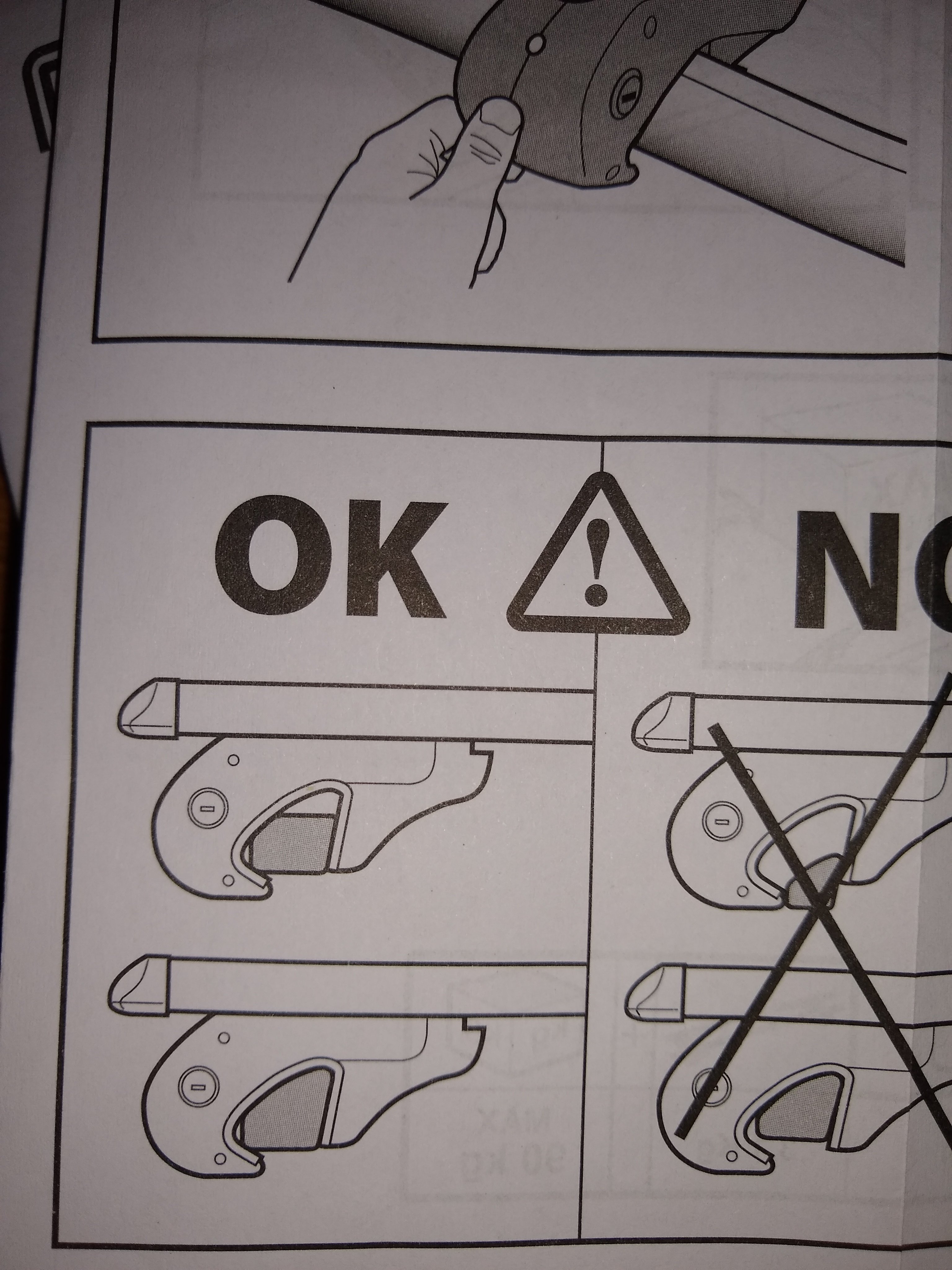

This is the profile of the Lidl and I think Aldi fitment. There is a gap at the top when fitted but it does surround the roof rail. From your photo looks like yours has a lip but the main security is from compression of the rubber around the rail as you say leaving a big gap. I think the Aldi bars are still available for delivery.
They shouldn't touch the roof. Imagine a loaded roofbox pressing down on your roof skin in that spot. Take them off the car - the roof is going to get creased.  You are right to get on to the vendor.
I have found Roofbox to be a decent vendor; when my Atera bike carrier arrived with a broken light-cover, I emailed them a photo and they immediately sent a replacement. I also ordered Cruz roof-bars for my old Astra estate which I returned because the mounts were too fiddly with 2 small nuts and bolts for each mount - very poor design. From the photograph, it looks as though the Cruz designers have triumphed again with something that is completely impractical. A picture is worth a thousand words ..... send it to Roofbox.

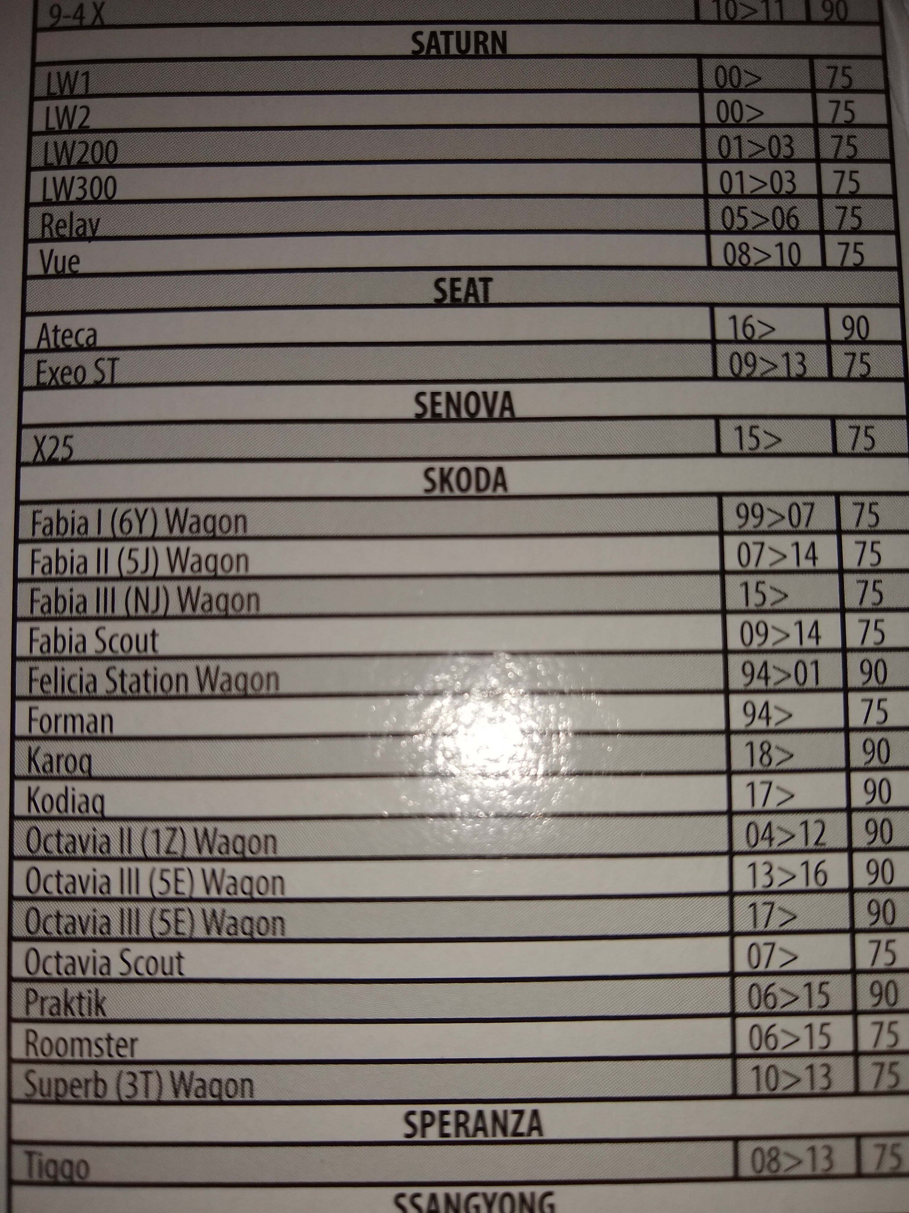

Will these fit the kodiaq??
Listed on the Metabo box (from Lidl)
Edited by SurreySlowCoach
Added metabo and lidl
Thanks for this what’s the 75 and 90 mean?
thanks focusy
Think it's the load they'll take in kgs Though I believe the karoq roof is only good for 75 kgs

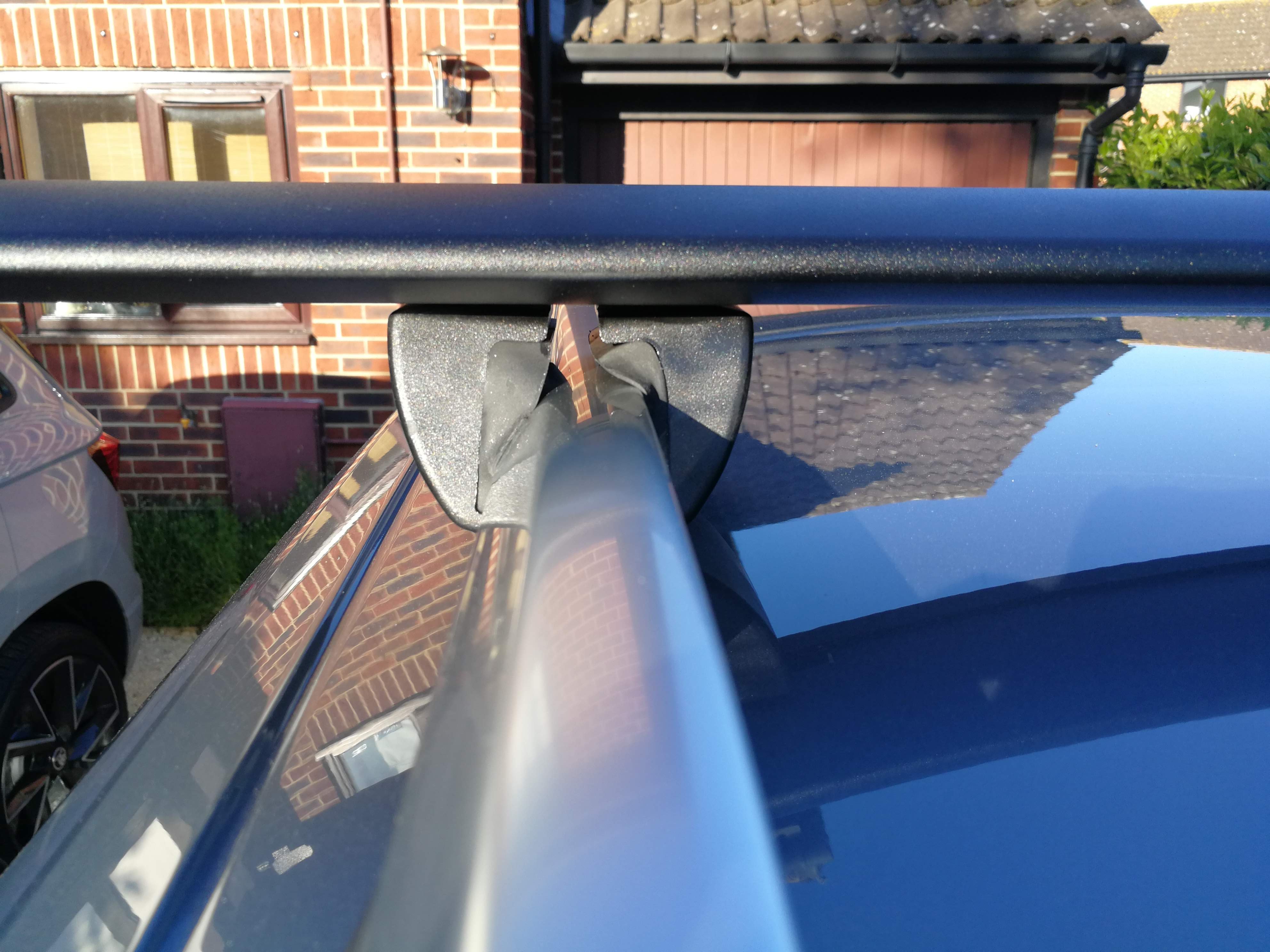

RoofBox came back to me today and they said they had had another Karoq customer with the same issue..... the manufacture said:
‘The customer should raise the clamps a little bit, the railing should not be necessarily always in the middle of the clamp’s rubbers. What is really important is that the railing remains always in contact with the rubbers. Looking at the pictures, it seems that the customer can raise the bars a little bit.
Apart from this, please tell the customer to tight the bars as much as possible with the provided tool (Allen Key). By tightening them enough, they should remain always in the same position.’
So I have: they seem not to move..... I will email RoofBox back with the image to see if that is OK - they don't touch the roof but are close...... Looking at others here there is a little more space...
Personally... I would send them back and but the Aldi or Lidl set .. cheaper and fits better by the look of the photos...
Me too, in my dealings with Roofbox I found them very happy to live up to their satisfaction guarantee.
