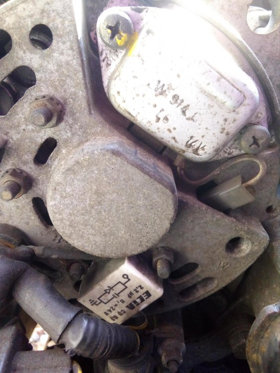

Having taken in all your advice (plus looking at the Haynes manual etc)  I've just checked the charging system with my multi-meter. Starting the engine and revving it way up (with headlights and heater fan on) the meter reads over 18 volts, with the meter probes on the battery terminals (as per the instructions in the Haynes manual). Way too high. That tells me that I probably need to buy a new voltage regulator (rather than buying a complete new alternator).
Before I go ahead with that I just wanted to check that I'm on the right track, or is there anything else I need to consider first.
No "probably" about it!

Well, yeah, but let's hope the fuses blew up only because of overvoltage and nothing else had time to cook. Replace the voltage regulator with an identical one.
Yep, it's failed voltage regulatir. It's common fault on Magneton alternators.
That is a Chinese overpriced part. Nothing OEM about it.
I am using HUCO 130954, made in Germany.
Yes. Or here
Thanks Ricado. Got one on order. Do you think it might be possible to change it without removing the alternator?
Normally yes.
