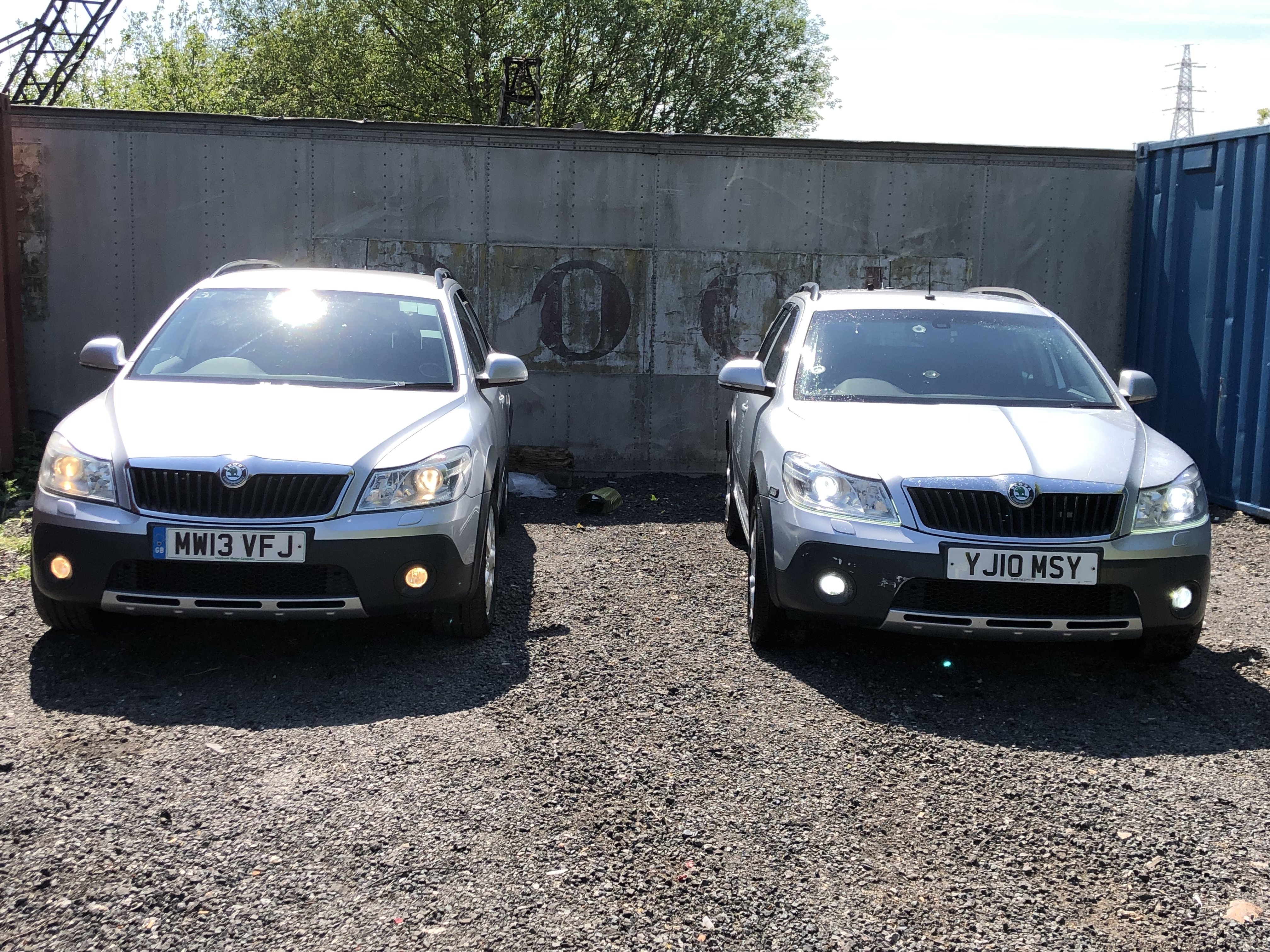

Here’s a photo of my identical Octavias one with HID headlights and LED fog lights compared to standard bulb, taken in bright/strong day light. F132FA0B-0A72-4F2A-9659-7B39531F0A26.thumb.jpeg.afbc593f594bd22ecdd04f0a5f55559c.jpeg
Hi Mick, looks good, please could you send me the link for both the hid kit and the LEDs that you have used in the fogs thanks, did it go through mot ok with the hid kit? Thanks again
Yes mine passed MOT no problems, the beam angle and pattern as exactly as it should be, soon as I’ve got a min il have a look and send you the links so you can have a look.

Did they take much fitting? Seriously thinking of going down this route👍🏼
Just as a quick reminder, a H7 HID kit fitted to a headlamp designed for halogens will (or at least should) fail an MOT in the UK given the current regulations.
Although Mick's MOT tester has previously passed them, it doesn't mean they will pass in the future nor that you MOT tester will allow them to pass.
But does this still count for Octavia as they have the projector style headlamp not the standard bulb and normal glass.
In short, yes.
The projectors fitted in halogen and xenon versions of the MK2 Octavia headlamps are different, this is to account for the difference between H7 and D1S bulbs. Each headlamp will have an ECE marking stating which it's been designed for.
The MOT has been updated to fail mismatched light sources and lamps which would include using either a HID or LED light source in a lamp designed for halogen bulbs. It's covered by section 4.1.4: https://www.mot-testing.service.gov.uk/documents/manuals/class3457/Section-4-Lamps-reflectors-and-electrical-equipment.html#section_4.1.4
