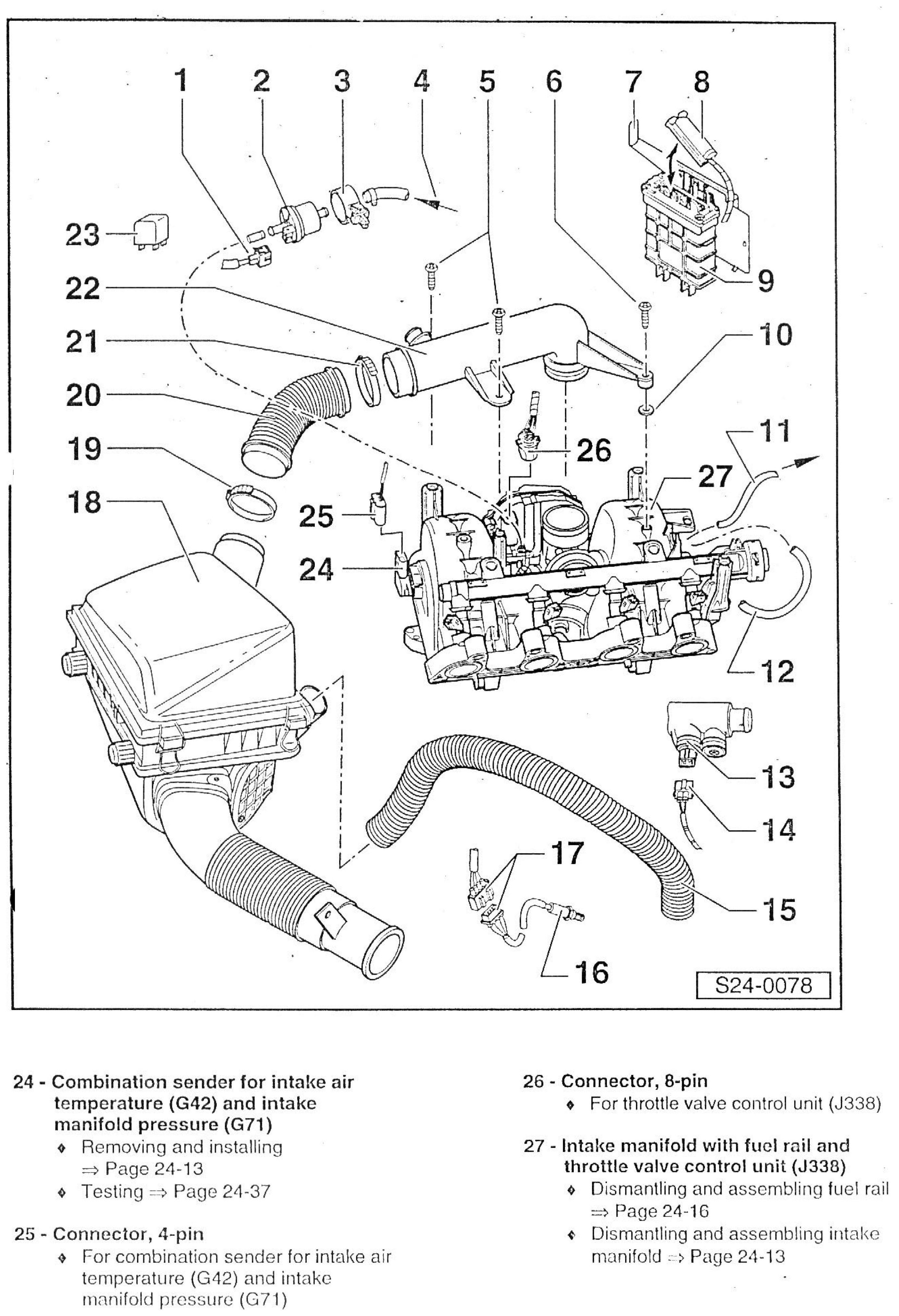

That is a well known issue. Skoda recommends first cleaning the pressure & temperature sensor for intake air. There are oily deposits and dirt on it.
Only if cleaning it doesn't smooth the idle, clean the throttle body.
Can you help me with locating this two sensors? And which cleaner do i use? Is intake cleaner ok?
You should also check the connectors of the MAP sensor.
