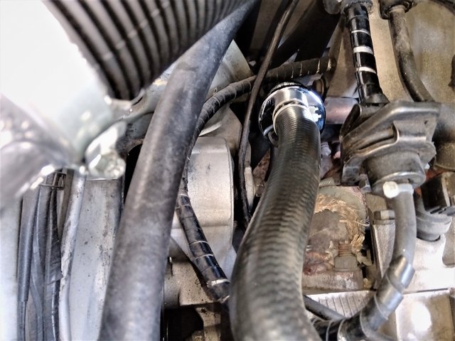

Finally found the problem. My maf sensor keeps getting dirty (it looks shiny and oily). If i clean it, the car runs ok for cca 20km then it starts running poorly again. If i clean the sensor again, it runs fine for another 20km. I checked the air intake and there was some oil in there which i cleaned but it still didn't solve the problem. Where can the oil come from? Is there a pcv breather hose or something?
Yes it is. You can't miss it. Too much oil mist means worn piston rings or bad oil. Try installing an oil catch can where the PCV hose meets the air duct.
kylindriko-filtro-anathymiaseon-lampa-l0
I use a small filter which is especially made for this reason.
Does our [old specification] Felicia really needs an expensive Oil-Catch?
Edited by D.FYLAKTOS
