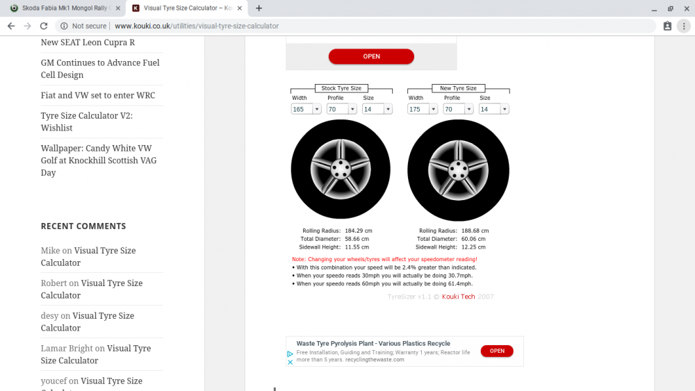

1. Tyre Upsizing - We want to get slightly bigger tyres for more clearance (every bit will help). The car currently has 165/70/R14 tires, and we want to replace them with 175/70/R14. Is this feasible? Not too worried about the odometer being off, but more will the tyres scrape the sidewall if we go bigger, or any other driving/handling problems it would cause?

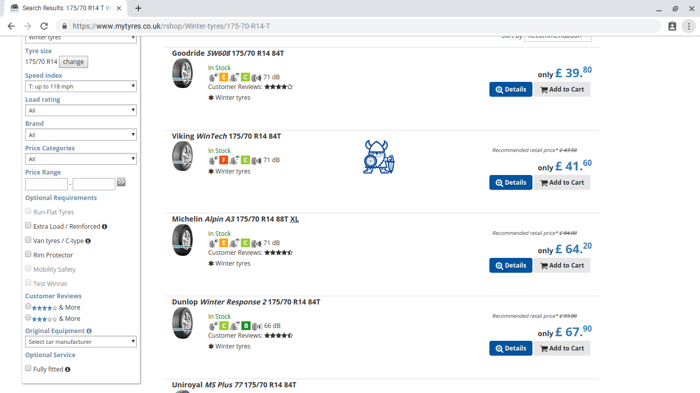

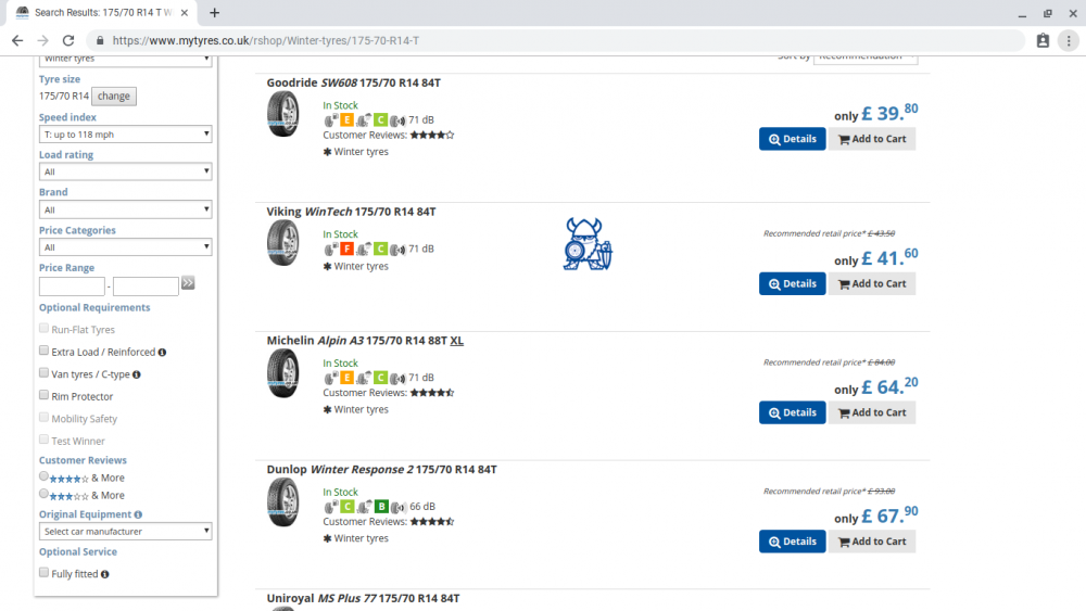

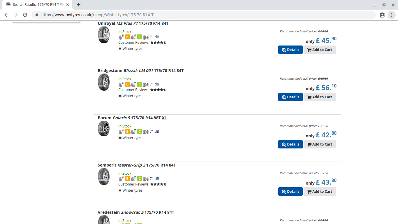

Best check which tyre size will be the most common and easy to source if required.

http://kouki.co.uk/utilities/tyre-size-calculator
Get XL marked tyres (Reinforced Sidewall)
Well, that will increase your rolling radius by 7mm, which is about the amount of usable (sometimes total) tread on a new tyre, so unless you're unlucky with the speedometer calibration that'll remain within limits.
