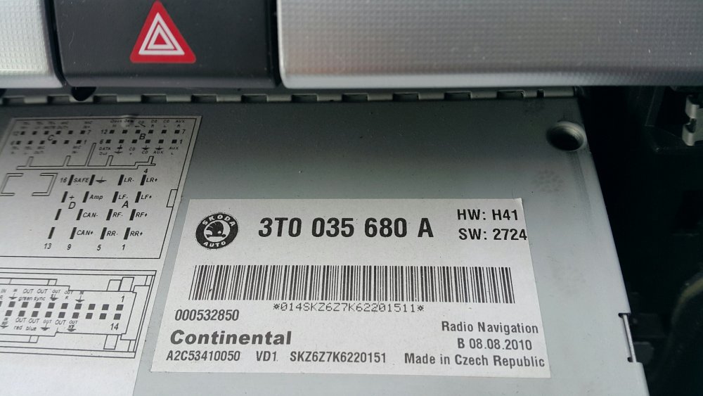

Hello, I'm trying to run the Discover-carestart.exe update software program to update my firmware having already formatted a 32GB SD card and downloaded the latest maps into a folder as above ready, but...
The program asks if I have Discover Media gen 1 or 2 or Discover Pro gen 1 or gen 2 and I need some help please?  It is a Colombus unit in a 2010 Skoda Superb (which I understand might be Discover Pro?) and here is the label l on the unit.
The downloads you're trying to access are not for the Columbus you have.
Think I might have gone in a circle then  - which ones do I need please Rusty?
Skoda don't have downloadable map updates for the older units. You have to purchase an update DVD from Skoda, or find an unofficial copy of the maps online and burn it to a DVD yourself.
