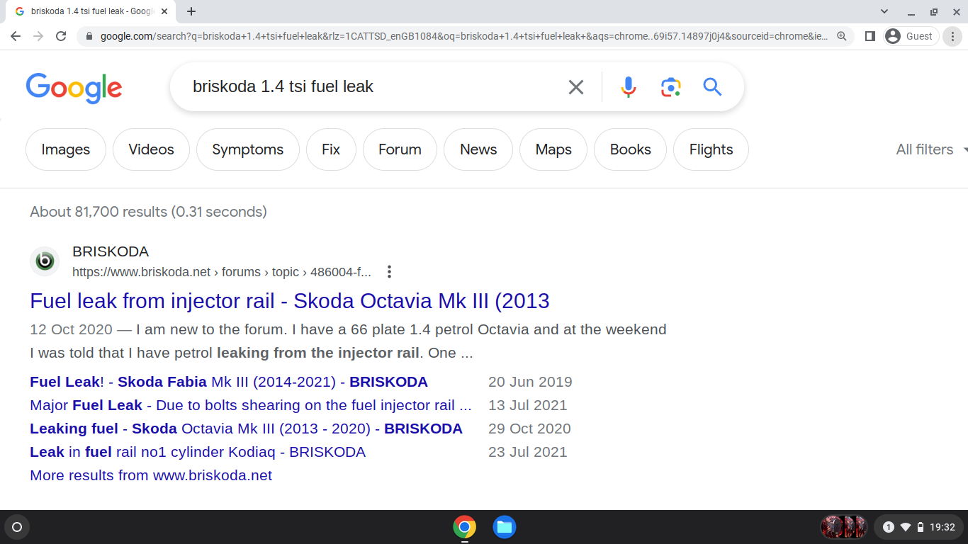

Edited by Rooted
44 minutes ago, Rooted said:
Anyone at a dealership that says there is no need to give a owner a record of work or parts fitted to their car are talking rubbish as usual.
No Data Protection issue.
The Cars owner / keeper / driver is responsible for it's safety and its maintenance.
Just speak to the Dealer Principal and ask what they think their employees are playing at and ask they for the information regarding your property.
If there are issues ask the Warranty Provider who is paying for the work to be done to itemise what was done.
As it is it only lasts the length if the warranty unless some contribution / payment is made by you.

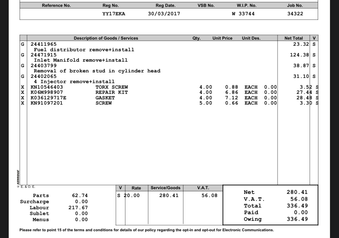

Just had an email back from the service manager at my local Skoda, they’ve sent me the invoice on what work was done to the car.
when I collected it they wouldn’t tell me what was wrong as I’ve mentioned above and had previously said they haven’t had anything in with these bolts coming loose and only the odd car with the seals going bad.
ill attach the section of the invoice I was sent to show work done but you’ll see that one of the bits of work was “ Removal of broken stud in cylinder head” and then later a repair kit so to me it would seem that the bolt did shear it’s head and others come loose.
maybe this is why they didn’t I wasn’t given any info on what was done when I collected the car but who really knows.
