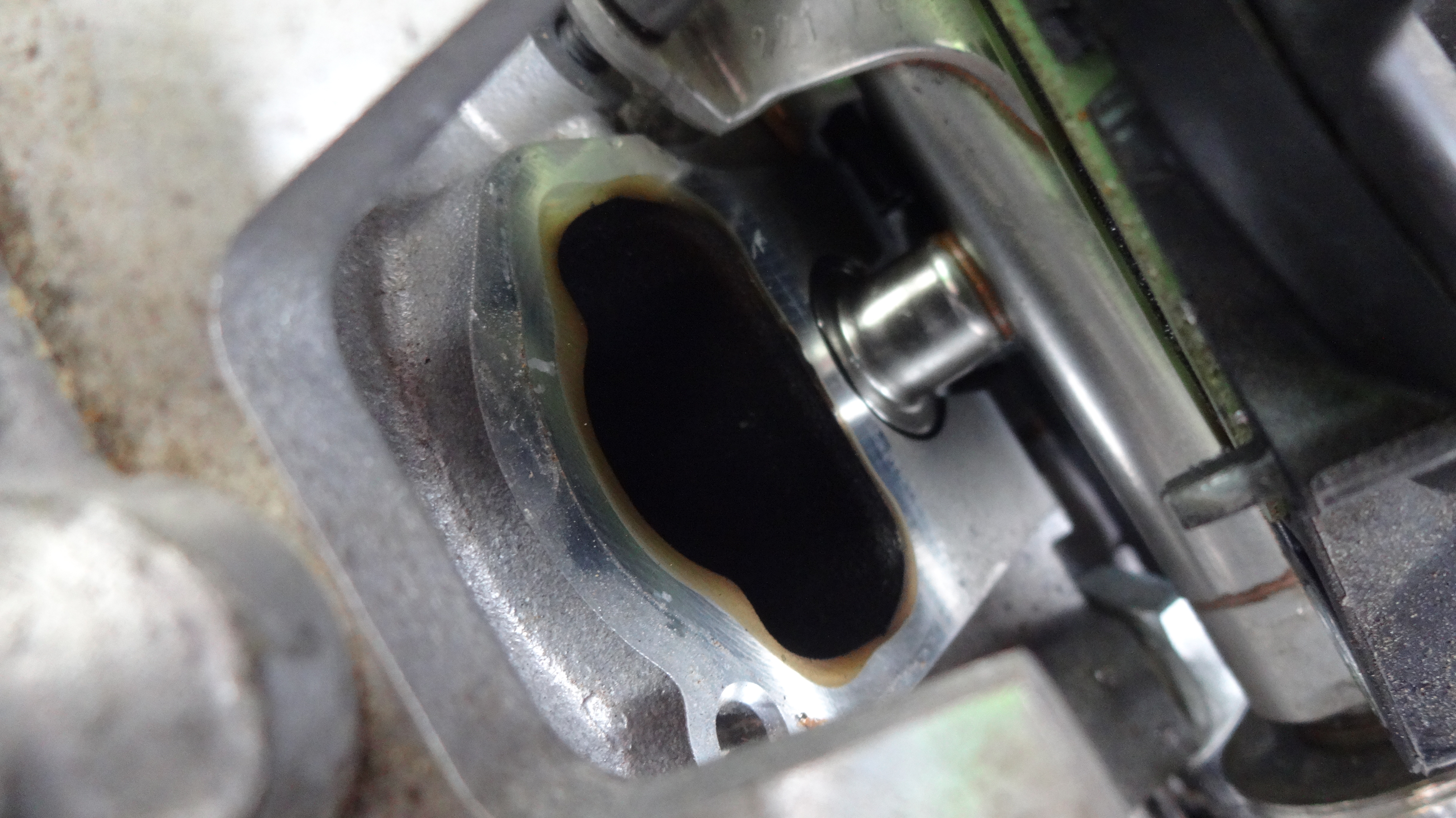

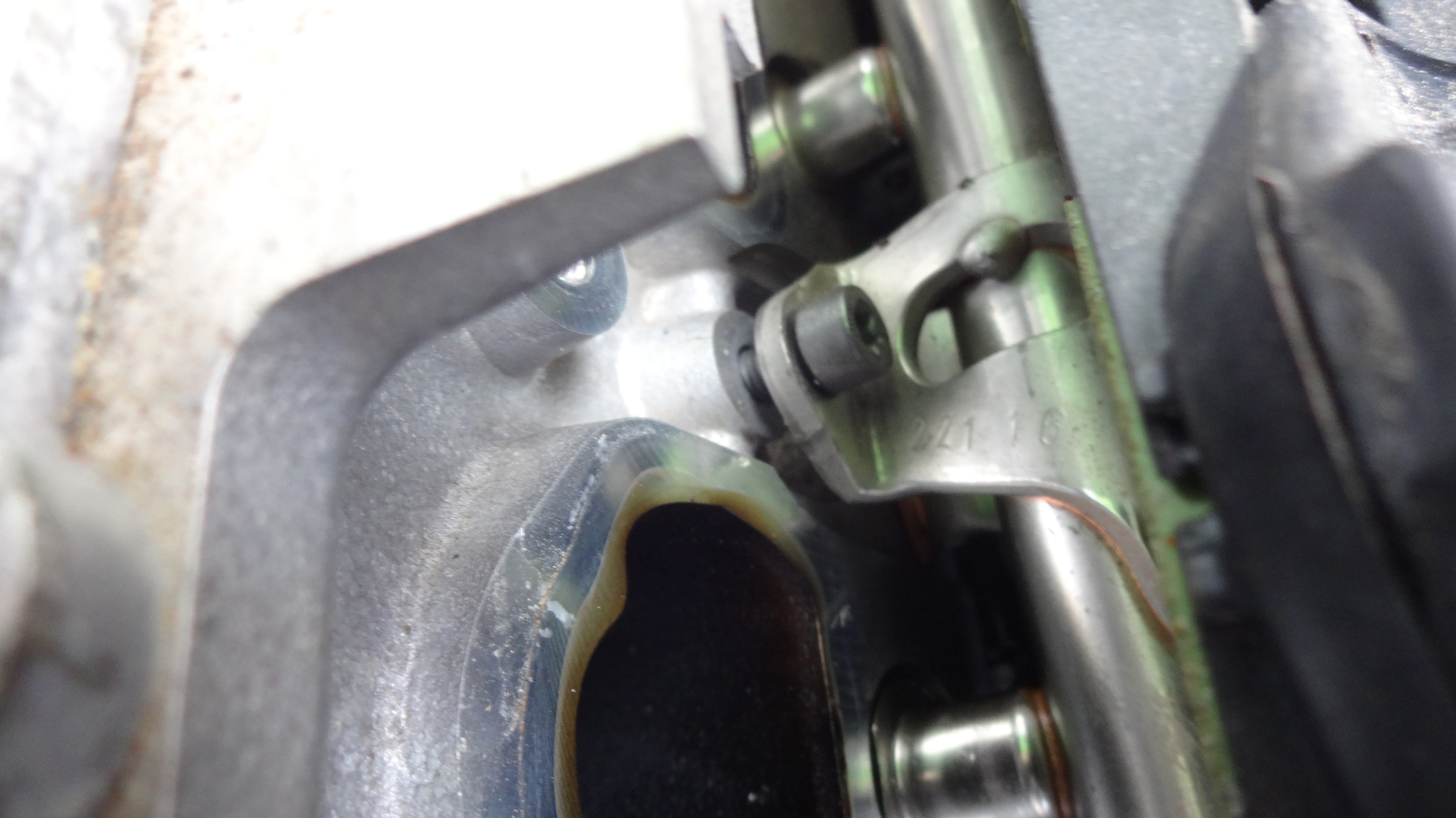

This happened to our car (66 plate Fabia 1.2) last night, sprayed high pressure fuel all over the engine but luckily did not ignite. Got it recovered back home and upon investigation this is what we found.
Top right hand bolt on fuel rail loose, bottom bolt head sheared off completely and discovered resting on the lower crankcase flange so can only just have happened.
Number one injector ejected from head by 3 or 4mm.
Number two injector also loose and partially out.
Fuel rail brackets not paralell to one another and holes way to big for M6 bolts they look more like 8mm. Bolts actually only biting on about 40% of the available cap head of the bolt. Very poorly manufactured item and obviously when bolted to a flat object (cylinder head) one or more bolts are under excess strain due to the bolt flanged not being parallel.
No flat or spring washers on the rail bolts (or thread locking compound). The engineer in me says there should either be flat and spring washers or mushroom headed bolts used with anti vibration serrations under the heads......
Bolts are marked 8.8 but look like chinese rubbish. If they are stainless its really low grade as I retrieved the snapped off bolt head with a magnet!
Something not right with the white seal on number one injector, it appears to have been crushed or not fitted correctly. Green flexible seal split almost right through.
