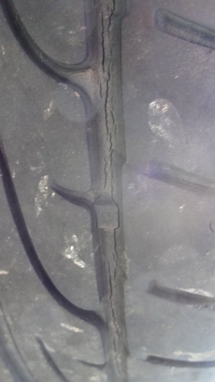

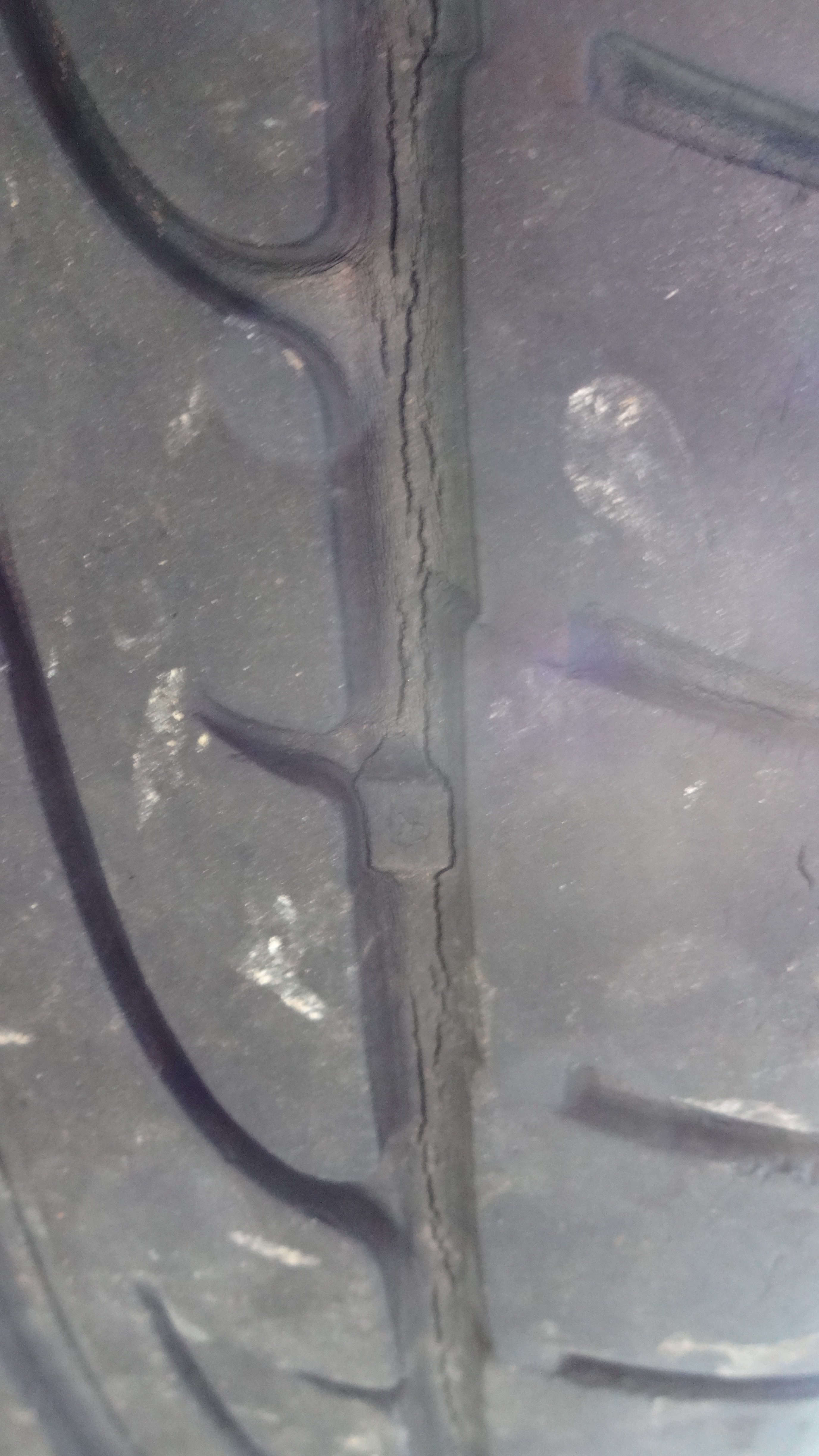

We also have tyre issues, tread like new but cracked in the bottom of the treads. Car has only done 20k miles.
On the phone it was easyer than trying to talk to a machine
Same as mine tread was good but in between tread cracked and got an advisory on mot
Again safety  issue
Almost a 1000 pounds on a 4and half year old 15000 mile car,

The two latest posters have described tyre problems.
It would be interesting to know which brand of tyres that have the cracks.
Mine lasted about 25,000 miles. The treads were not worn entirely down but the right front tyre came too close to a high granite curb puncturing the sidewall.

Dunlop SP Sport Maxes on our, still on factory fitted tyres. You would think Dunlop would be better than that!
