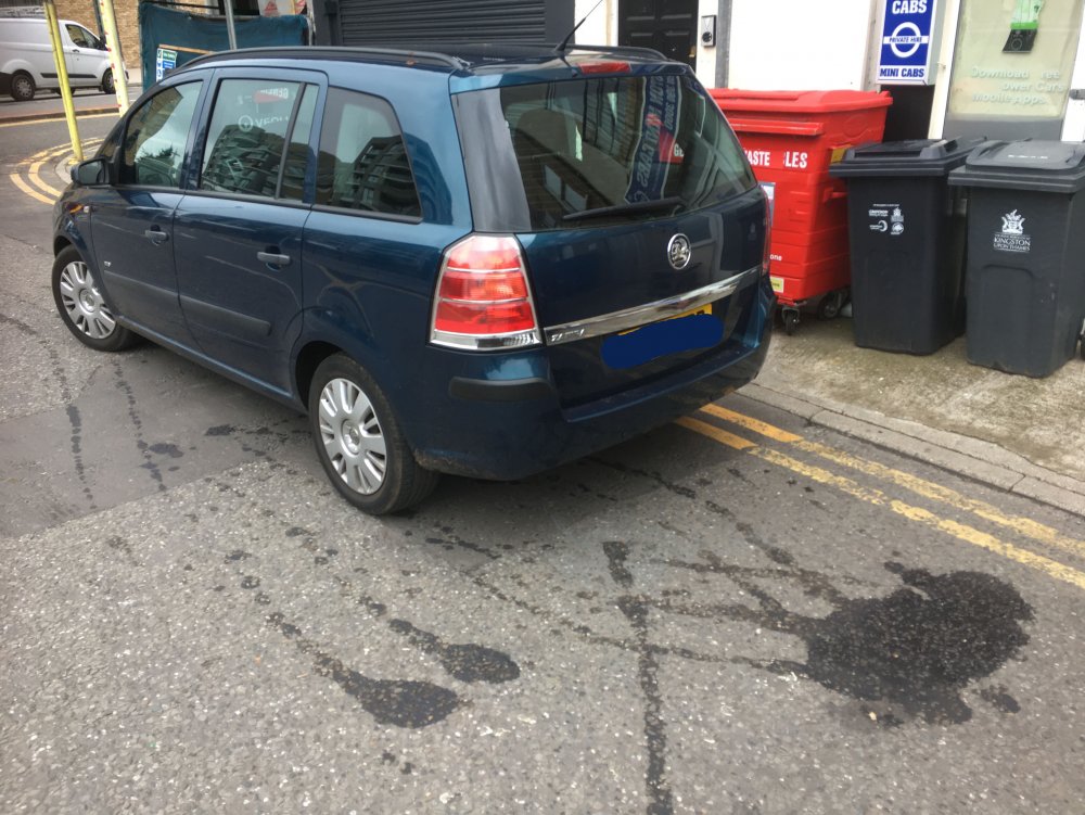

3 hours ago, PaulTheCat said:
Hello,
Have been sifting through this thread, trying to see how many people have had exactly the same issue with a sheared bolt head on the fuel rail,
With a pattern forming, and all these complaints, how are Skoda UK not taking this seriously?!
Just look at the trails and puddles my Spaceback left behind, when I parked it briefly to go into the garage to do the paperwork.
(Partly obscured by my friend's Vauxhall, as he shadowed me on my tentative drive to the garage).
I've just posted details of my fuel rail failure under: Major Fuel Leak - Due to bolts shearing on the fuel injector rail assembly
I'll be citing the number of complaints on this forum in my letter to Skoda, to try and get my replacement parts refunded, at the very least.
I anyone has been successful in getting compensation/goodwill gesture from Skoda on this, please let me know.

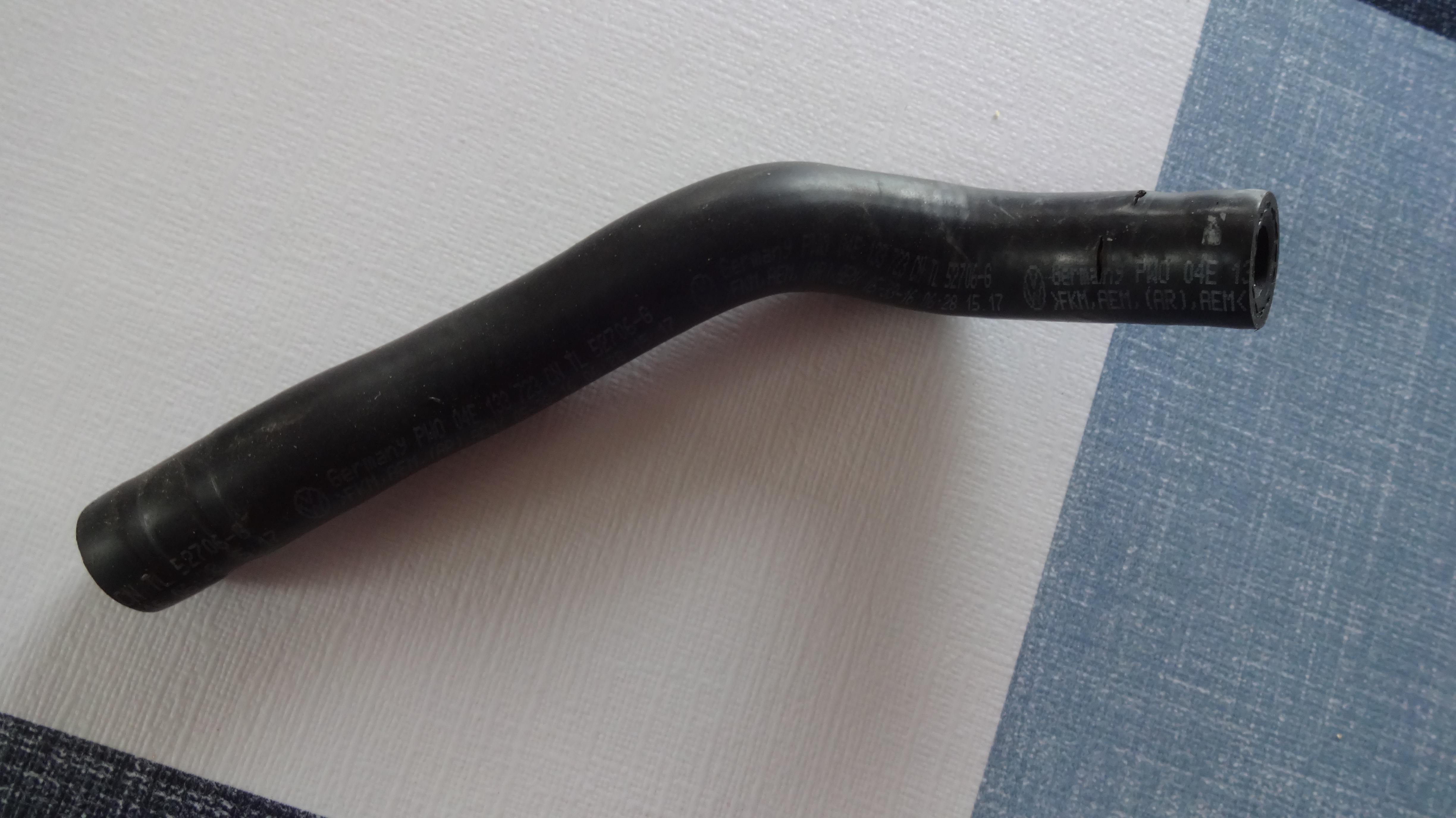

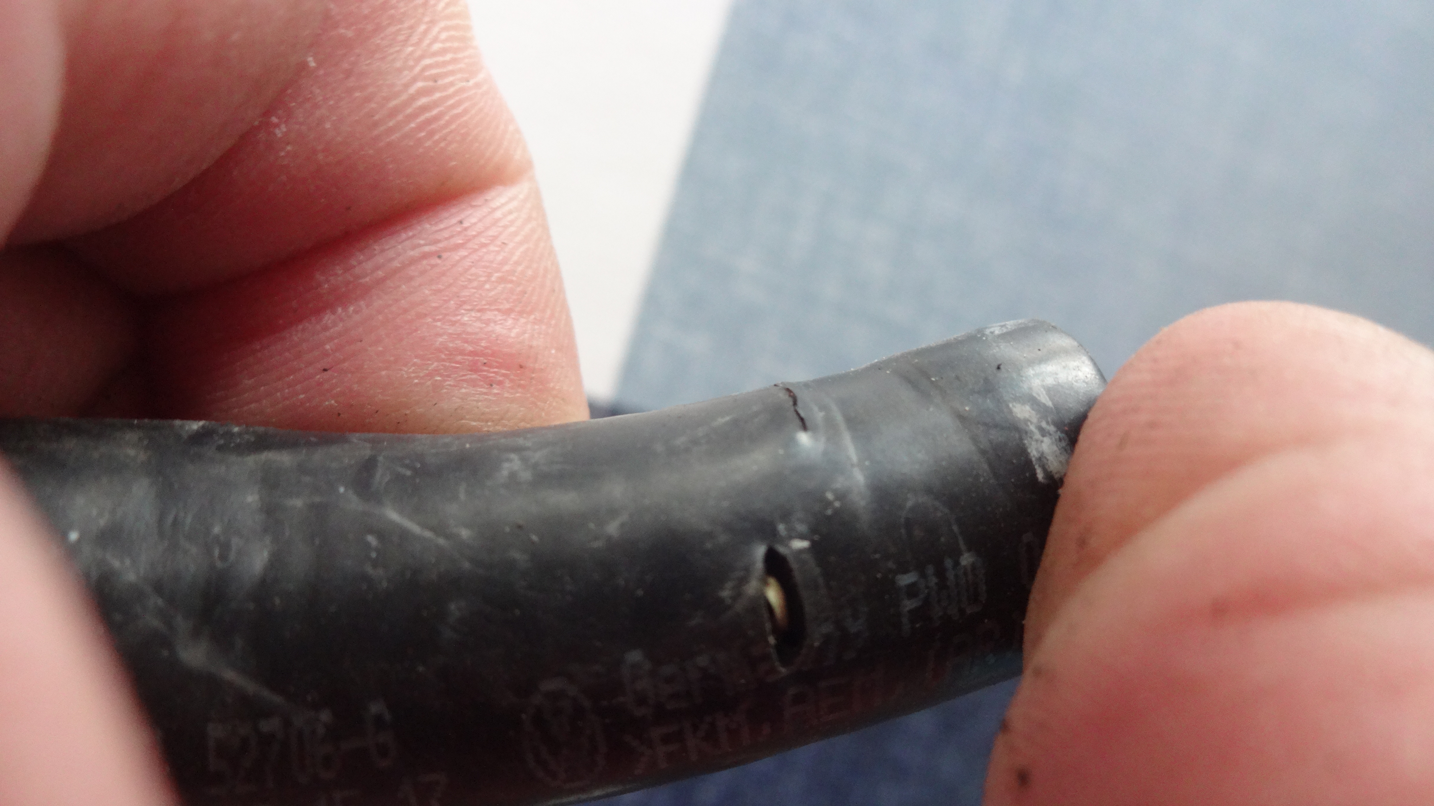

Check your flexible fuel lines folks, only a few months after the injector rail "fell off" we had the stench of petrol again. A section of rubber fuel line has gone mushy and was squirting fuel all over the engine this morning. Hose has seriously deteriorated, is it modern petrol doing this? this is on a 2016 car not a 40 year old classic. DSC09531.thumb.JPG.34288f0e1a8c0ee20d48da5654e1ecb9.JPG
@Peskyparttimers, which section of the LP fuel line was that?
I noticed that my wife's August 2015 VW Polo had ended up with a section of LP petrol pipe touching/rubbing on the AC pipework, that was causing the surface to get rubbed away, so I retro fitted a suitable bridging clamp to hold that pipe away from that AC pipework.  VW Group were meant to have included that mode back in late 2014, but like many other things, it seemed that was just an idea, the reality was that once all units had passed through the factory, newer stock would get built to this new standard, ie "don't waste money, just run the existing stock out first even although it is a potential safety issue".
Now if that is just inferior quality pipes, then that is not good, global supplying at its best maybe leading to parts being sourced from less than trustworthy "other" countries being done so that VW Group products can be supplied into these "other" countries, ie "job/work share".
It was the bit between the HP pump and the solid pipe on top of the inlet manifold so no flexing involved. It seems to have gone squashy as if something in the fuel has reacted with it.
No.  There's been ****-poor rubbish rubber in fuel hose (and classic car parts) for at least 15 years in my own personal experience, I've often wondered how long before it'd also affected modern car parts or even dealers parts, counterfeit dealer parts have happened before.
I'm a bit more surprised it's happened to a factory built car - although I did have it happen to me 20+ years ago but that was on a British/English made car and they'd used the wrong hose from their supplier without checking.
