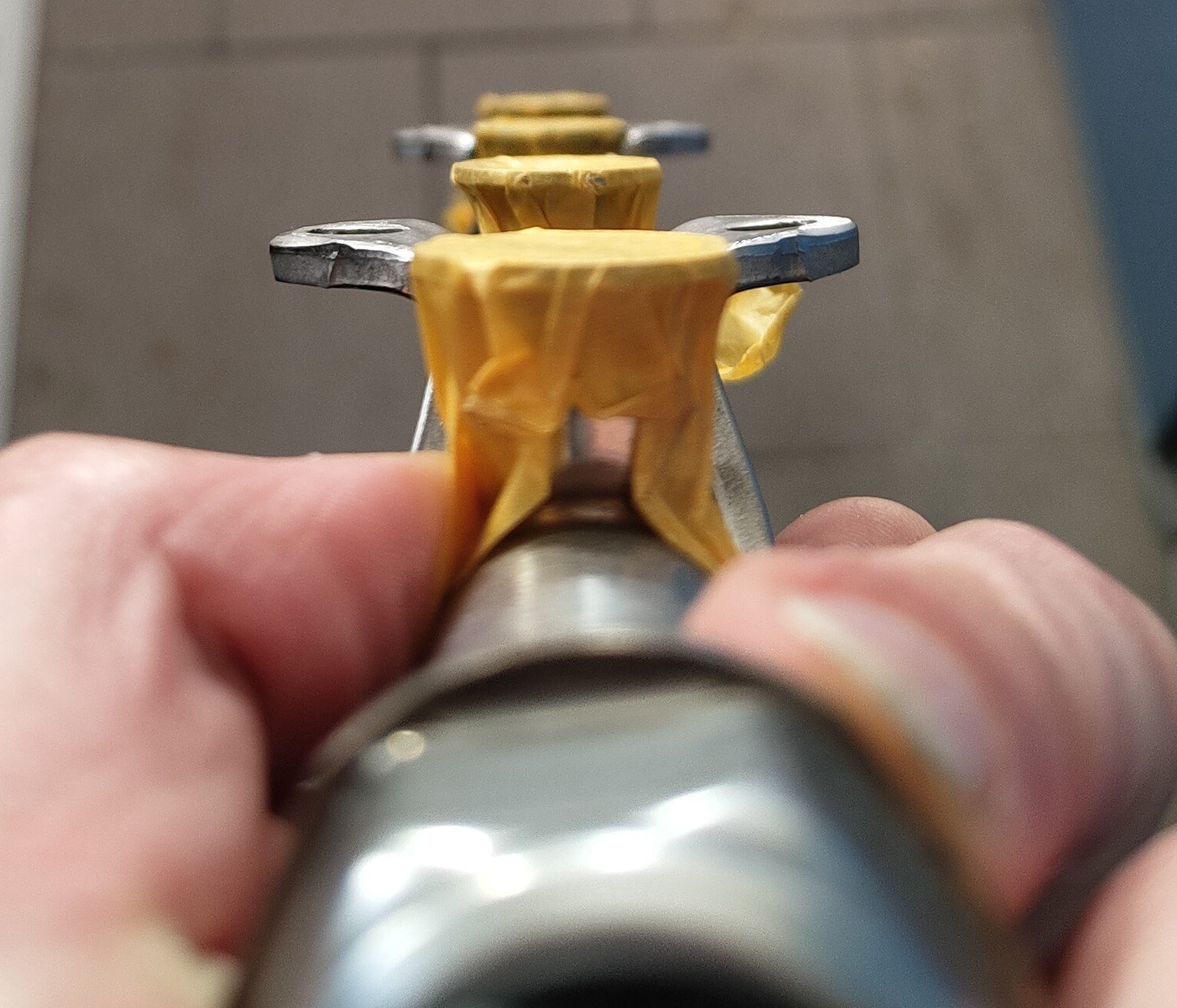

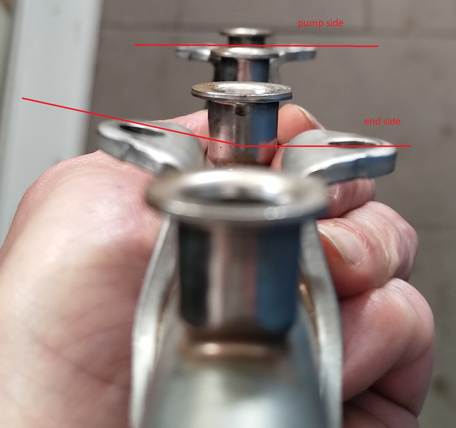

I find this on my common rail, not sure it is good and perhaps it explain the problem...
the curve part is here where the bolt broke...
Tomorrow, i check on the cylinder head if it is normal.
I agree that flange angle does look odd.
The bending of that metal will have been caused by the bolt(s) slackening off.
I’d think that the cylinder head will be okay.
From memory, the first test/check that VW America request is done on an engine that is within the “problem “ production period but not yet failed, is to attempt to insert a piece of printer paper under each of these metal flanges, if that can’t be done, then “all is good” and only the 4 bolts need replacing and correctly torqued up.
With this one it's not so much a fag paper as a fag packet. What the metal, of the particular flange in the photo, like, can it be trusted if straighten out and part reused with confidence(?).
You're probably right. In my picture, the right-hand side is the screw was loosened. So after, it is the bottom screw that took up all the efforts and the injection cups.
This twisted the paw of the common rail until it forces too much on the screw and breaks it.
I'm surprised that the thread in the cylinder head is always good.

I test the common rail this afternoon and try to put the paw straight...

Ok, this bended common rail isn t normal!lol
I persist in saying that the rail was like this in origin, all twisted.
It is impossible to that the common rail be deform himself, alone because it took me a clamping vice and a clamp to straighten the rail...

Well done on straightening it.
Who knows the real causse(?). If you have had the car from brand new and doner all the work on it yourself there would be more certainty but if you got the car used and/or have it worked on by others the variables go up. If it took a lot of effort to get it straight then lets hope that has sorted it for good.
