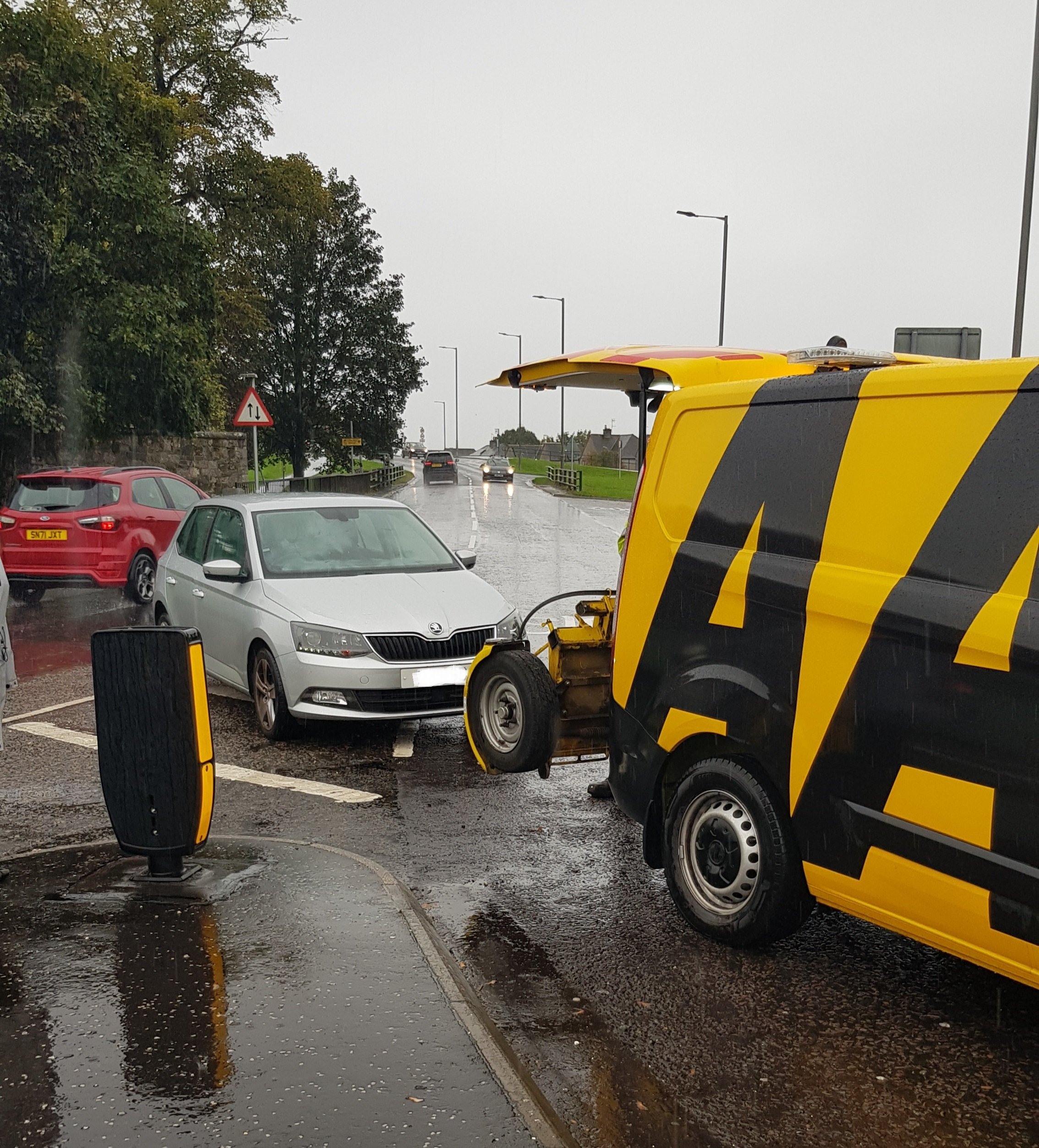

Another one here, 2017 Fabia 1.2.
Fuel all over the engine bay, AA man was astounded.
By the time he got the car home I'd found this and told him likely a snapped bolt.
Spoke to Skoda, of course they have never heard of the fault before so would only book the car in for a paid repair!

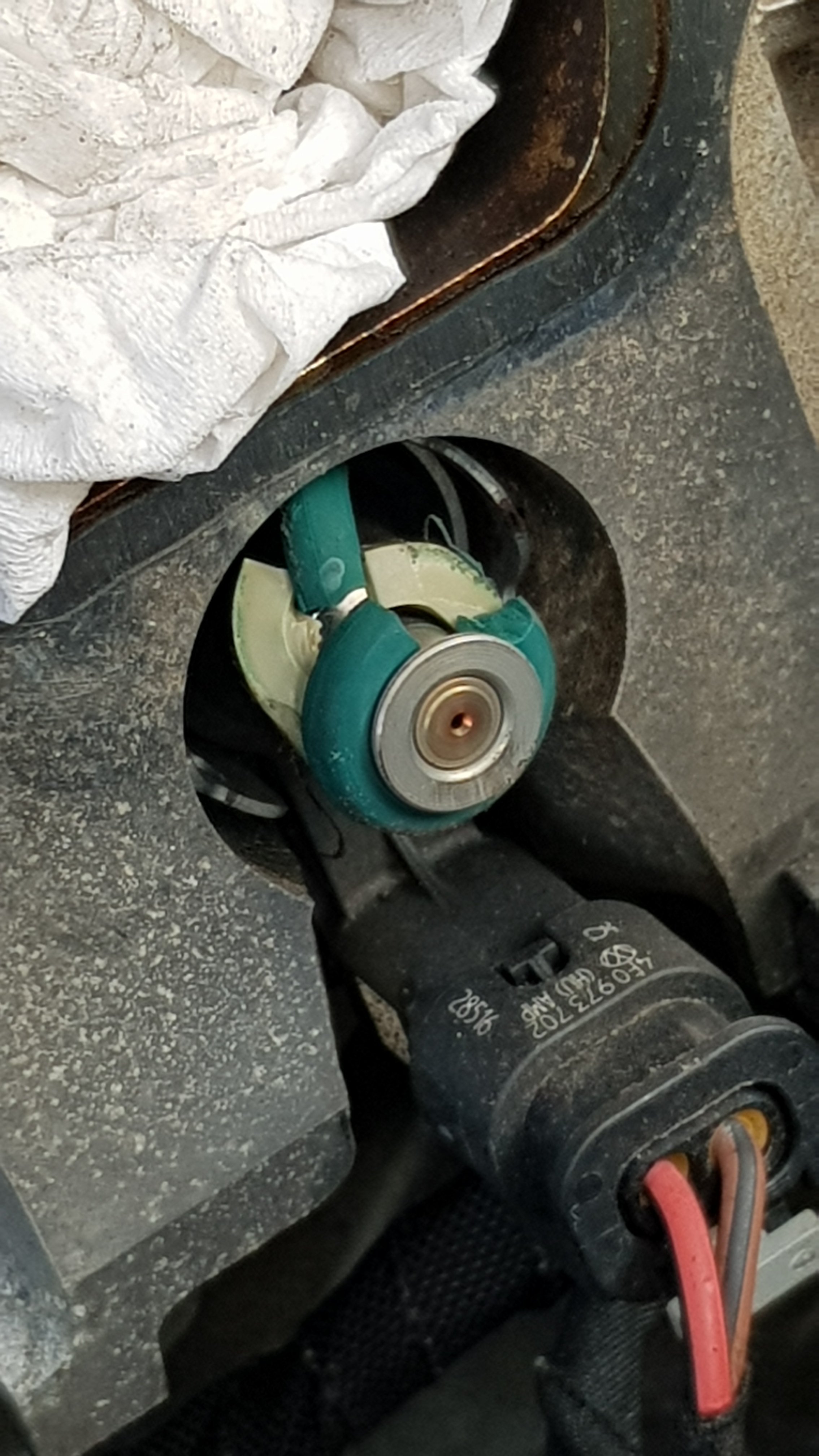

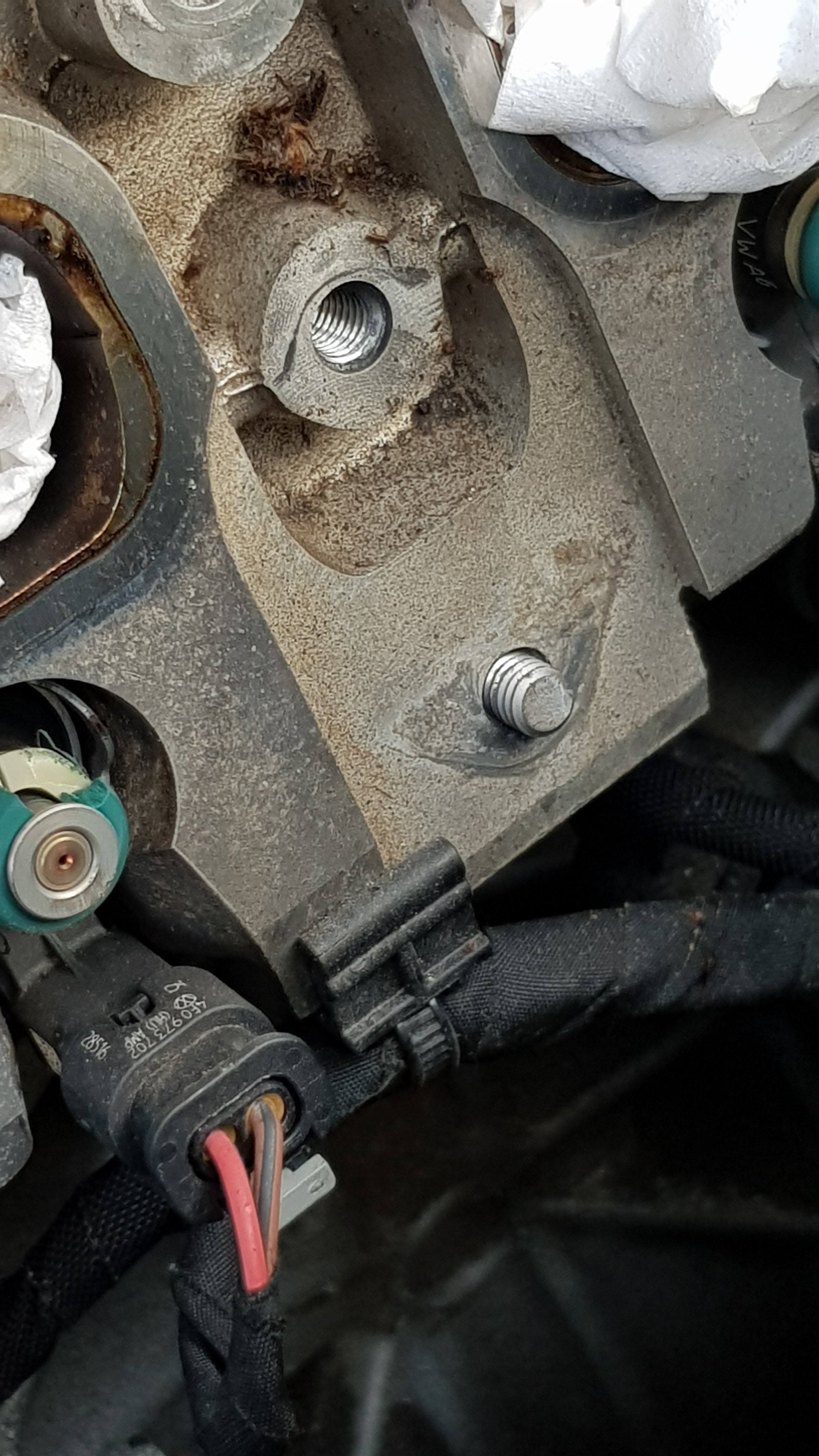

Stripped it today and found the bolt head then after removing the intake manifold could see the snapped bolt.
The fuel rail brackets are also bent so I either need to fit a new one or get them back straight again.

It's no wonder main dealer garages get such a bad name.20221006_185255.thumb.jpg.bead6c84e301208104475e7e7916d438.jpg

Yes, other bolts were loose, #shocking.

Fixed the car today as the new injector seals and bolts arrived yesterday.
Fairly straight forward repair, took about 2 or 3 hours all in to put it all back together.
That was taking time and stopping for 3 tea breaks.
Quite why VAG don't hold their hands up and have these checked and repaired by the dealers speaks a lot of their attitude towards customers.
