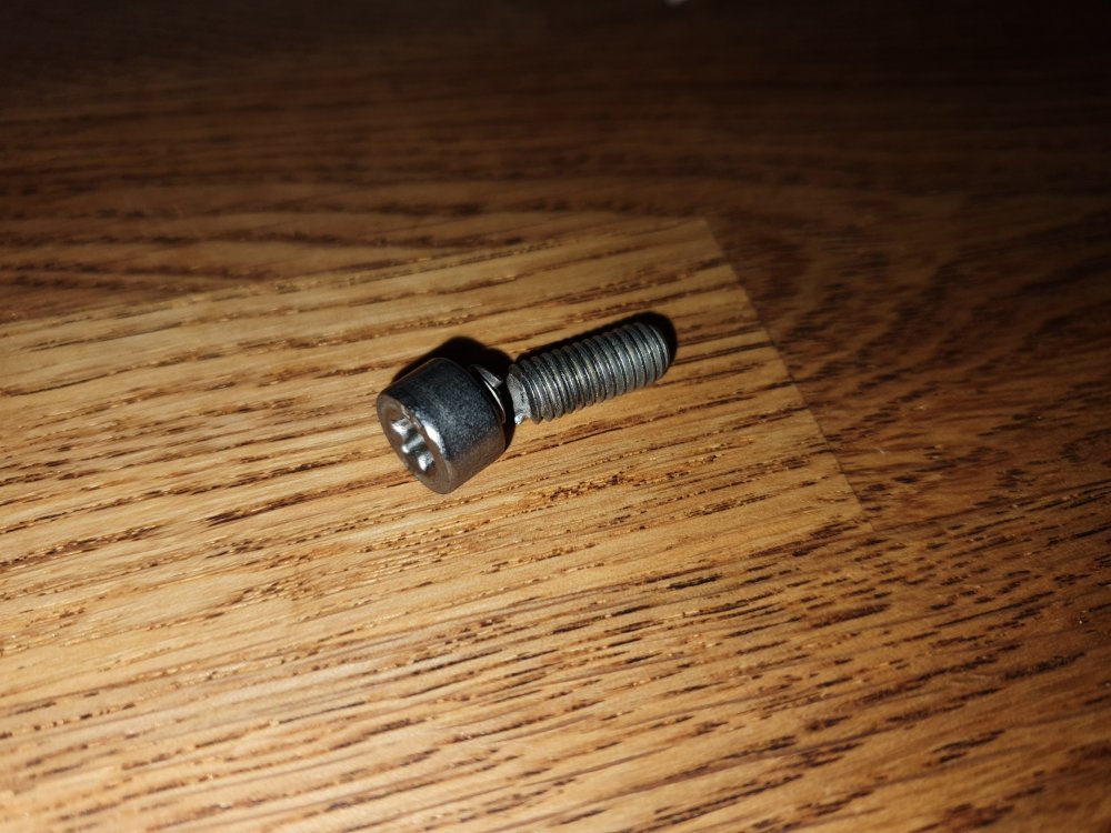

That certainty sounds familiar Eric, when mine went the same way I was told that it was a sheared bolt in the fuel rail if that helps. My Skoda Dealer paid 75% of the £550 bill through a "Goodwill Matrix" if that's helpful to you. My fabia was also a 2016 1.2 fsi that I got in the September.

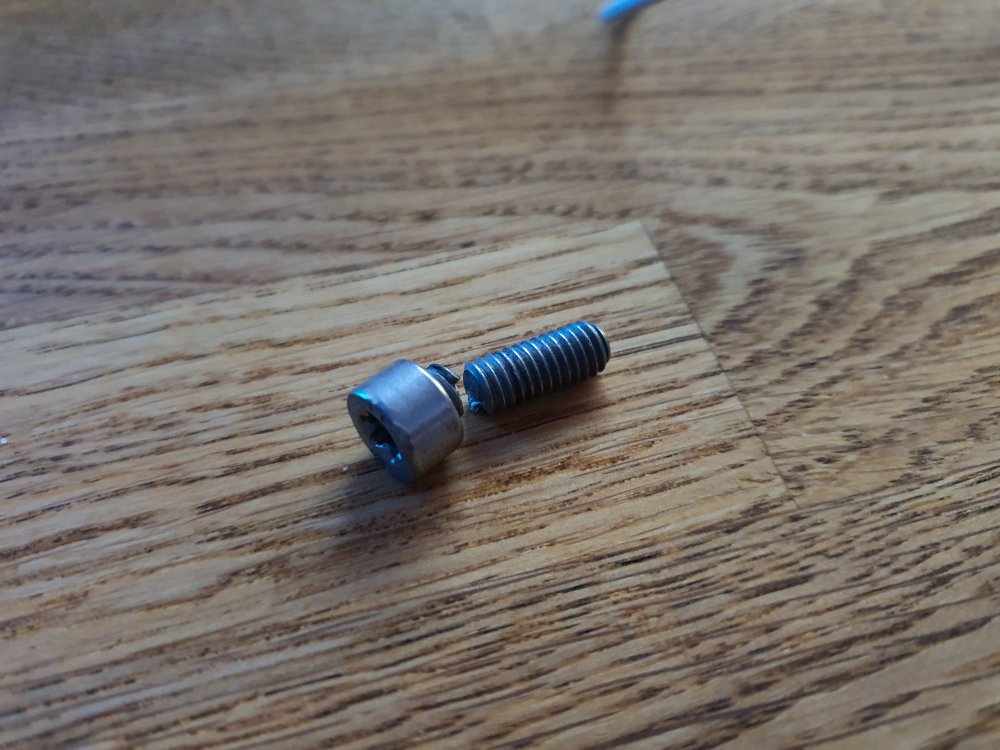

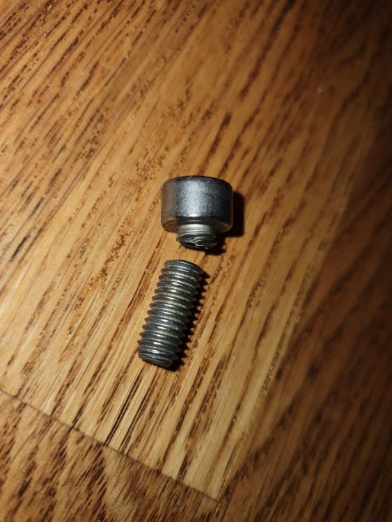

Thanks @Lemto; unfortunately, there's not much visible of the end surfaces. Some similarities with images on page 3 here though: https://www.asminternational.org/documents/10192/20564188/amp17208p18.pdf
Overtigthening would tend to cause necking of the threads near the failure point, as I understand it.
Perhaps @Eric_DK can request the broken parts from the place mending his car. In this country it is your legal right to be given such parts, if you request them back. Not sure if same will be true in Denmark.
