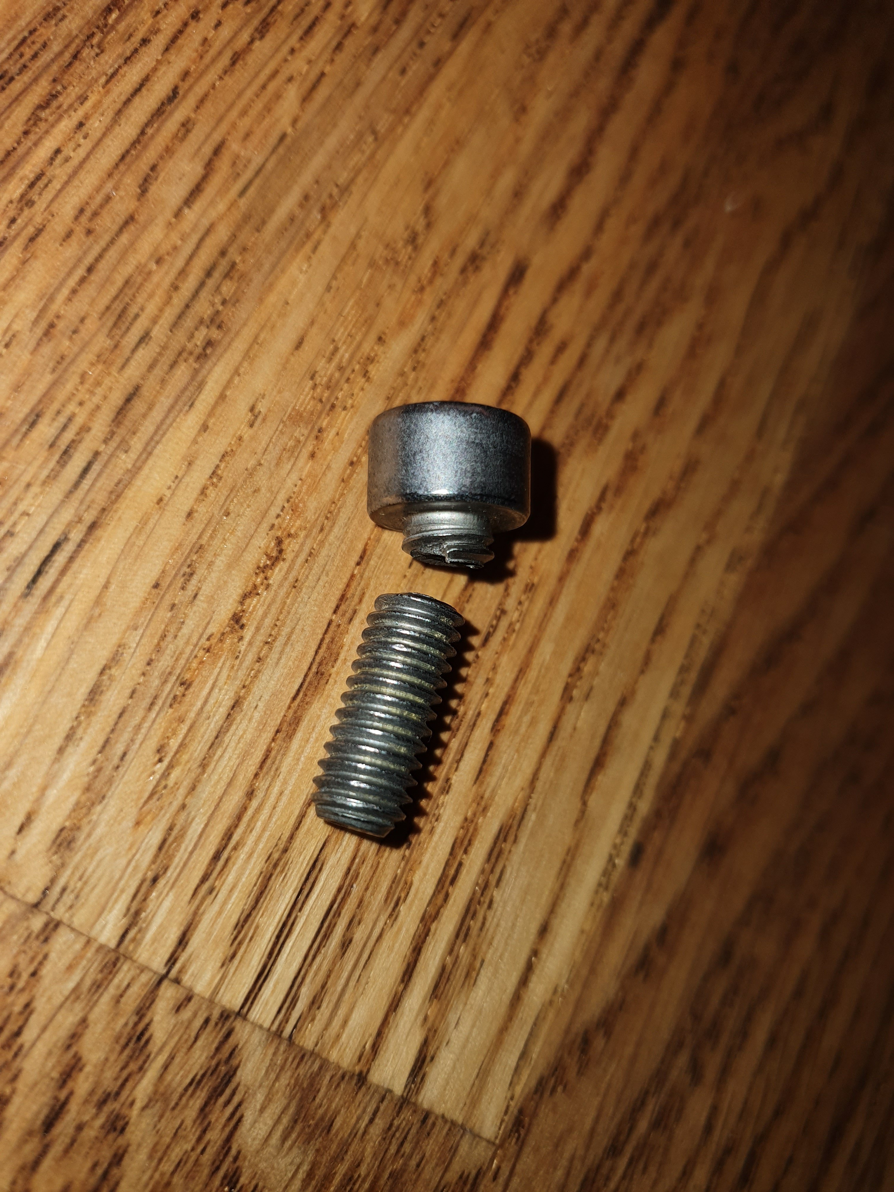

I left my car yesterday with my local mechanic, found out today that it was due to a screw in the fuel injector failing. He's not sure if it was over or under tightened when the car was made. Thankfully wasn't as bad as I had anticipated.
Contacted Skoda about it but because it wasn't one of their technicians that done the work I can't be compensated. I had figured my warranty was voided as I have modified my car, so never even tried them. It's a bit of a bummer, but I suppose it could've been much worse.
I'd be guessing that that is an M6 bolt that holds the fuel rail down onto the engine and in doing so traps/retains the injectors, ie exactly the same mode of failure has the OP for this thread.
I also wonder what the "quality" of that bolt is and if the "quality" of the replacements that probably came in the "repair kit" that the OP ended up getting fitted to his car.
I'd think that there is a TPS or whatever they are called out for this sort of failure and the recovery action is to replace all the seals and bolts with more suitable bolts.
Maybe a picture taken of the top of the head of that bolt would show what the quality of strength of that bolt was.
My worry is that that failed bolt looks like being a SS one, and so limited a bit in available higher grades, ie quality or strength.  Typical grades of bolts are 8.8,  9.8, 10.9 and 12.9, and most available for an M6 cap headed bolt like that one is.

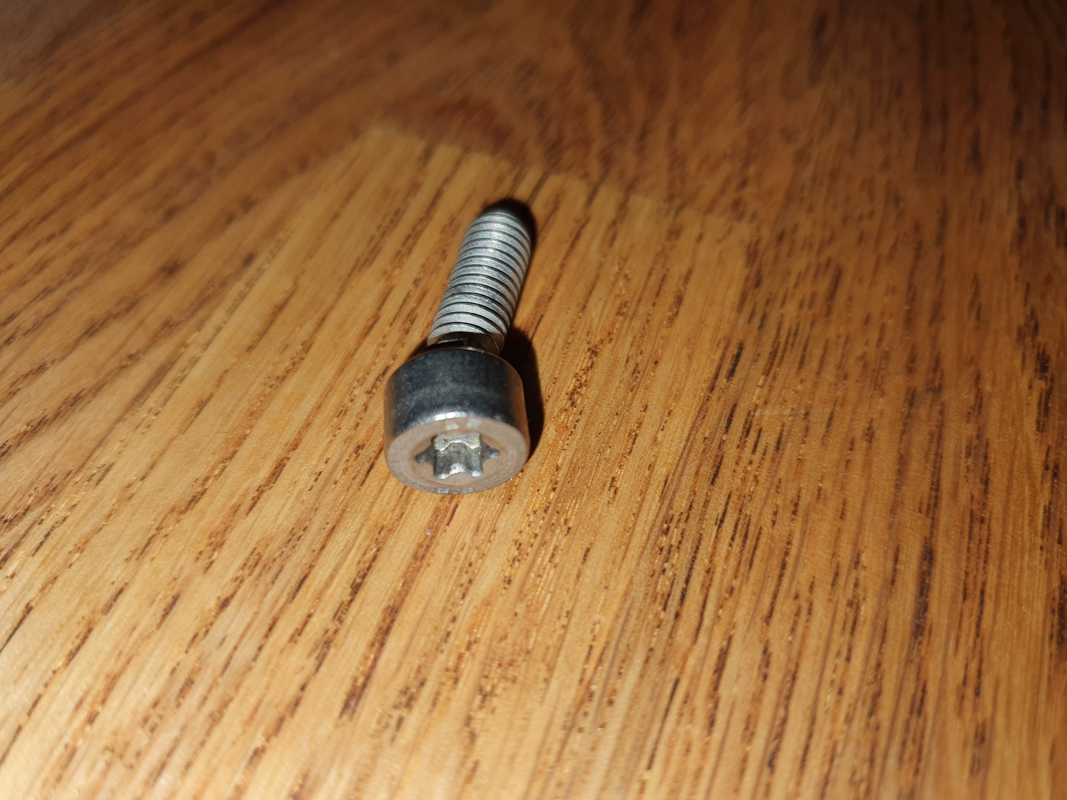

It's all a bit too advanced for me mate, my mechanic ordered in new bolts but I'm not sure which type he used. I'd like to think he chose better quality ones. You can kind of see the head of the bolt here.
@Lemto @rum4mo I'm not dead sure of the grade, but that set screw was either flawed or over-tightened based on the break.
Oh, it looks a bit like that bolt is an 8.8 grade of bolt, so right down there as low as it gets for that sort of graded bolt, I'd like to know what the latest version of that is grade wise.
I appreciate the insight Ken, my mechanic thought the same therefore I'd be inclined to think that is what has happened. Hopefully this may come in handy for someone who runs into a similar issue in the future.
It's crazy that something as simple as an over-tightened or flawed screw can create a an issue that has the potential to be catastrophic.
I'll ask my mechanic what grade of bolt he purchased as a replacement, hopefully have that for you tomorrow.
