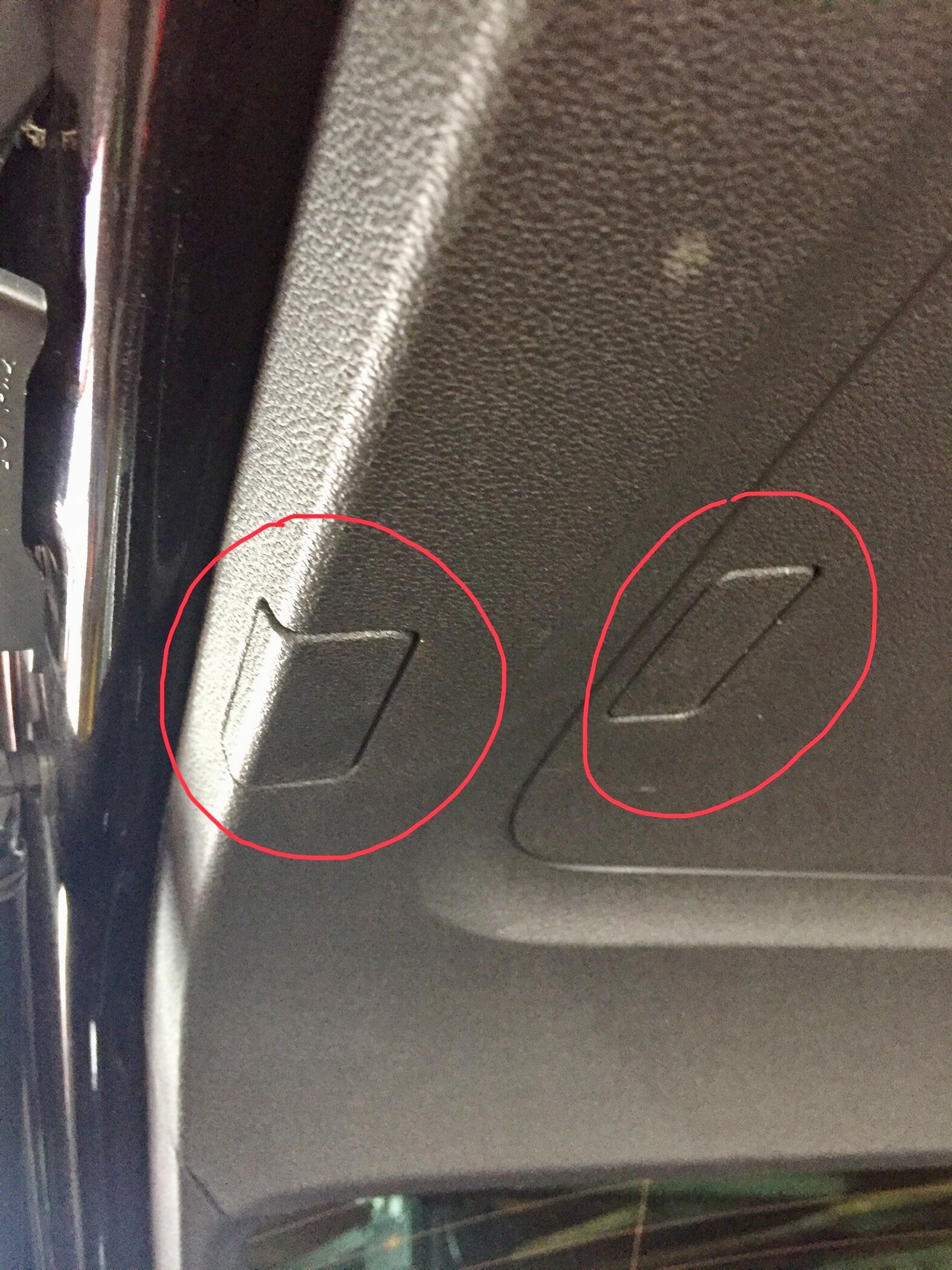

How is the tail gate cluster removed - can anyone explain?
Quite easy really. There’s a couple of pop open covers approximately 2 x 4cm in size on the inner side of the tail gate.Once these are opened three 10mm nuts are revealed, remove these and the light cluster can be lifted away after the tail gate has been lowered a little or you stand on a stepladder. 😃
Thanks, Manc-Fletch. Presumably, this means removing the plastic tail gate interior lining? How does this come off?
No, you don’t take off the lining. The nut covers are part of the lining.😀
I will post a photo if I get chance later.

Sorry to reply on an old thread but I have the exact same problem with the inner led tail lights, does anyone have a guide or know the best way to remove the lights?
Thanks
The Chinese video from @wen above shows the solution to cleaning them out.
Not tried it myself, but it looks like removing covers in the boot to access the fixing bolts and removing the inner clusters to clean out.
