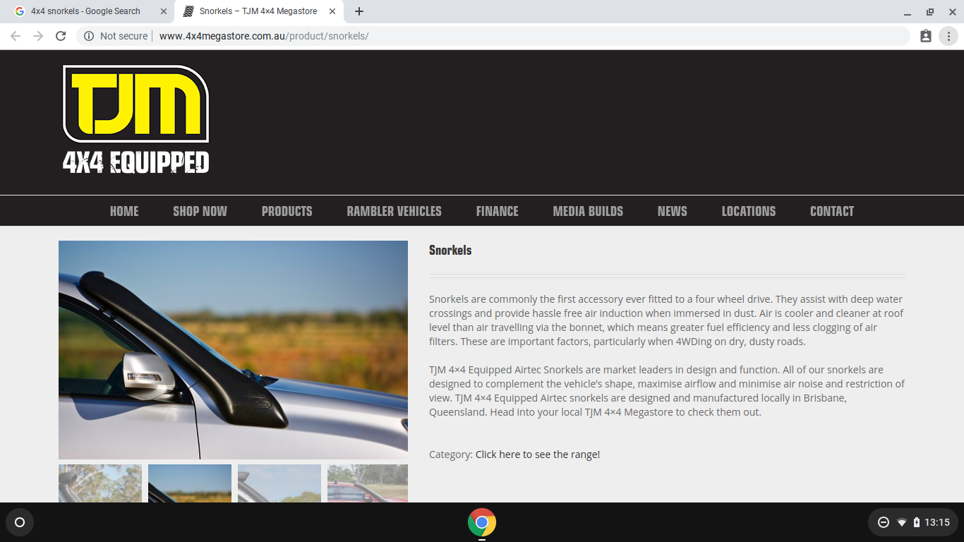

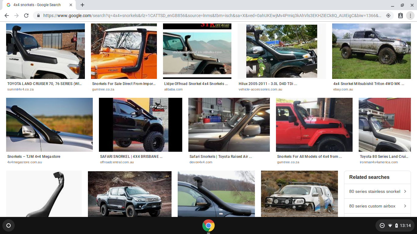

I am looking for Snorkel for my kodiaq car. Recently Skoda Academy students have made MOUNTIAQ (Concept) and I am looking for this kind of snorkel.
If anyone here can make and supply me, I would be delighted to make one.
I am attaching photos also.

If you have the skills to waterproof the rest of the Kodiaq for wading then there are plenty snorkels for other vehicles you could adapt to fit neatly to your car.
Go to some Offroad Equipment supplier that has stock and see what goes well on the car, maybe with it going through the outer and inner wings.
Not going to be hard to have one on and less vulnerable than that one.

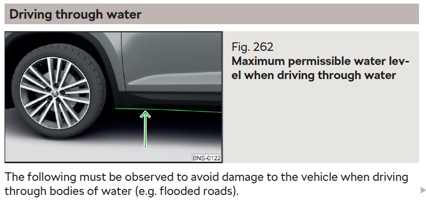

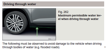

I noticed while checking something in the manual the other day that the maximum recommended depth for water is only up to the lower sill... so a snorkel might be a bit of overkill?
Does well enough

As George said you need to prepare the rest of the car too including breathers, electrics as well as making sure the cabin seals are up to the job wh h has never been a strong point for Skoda.

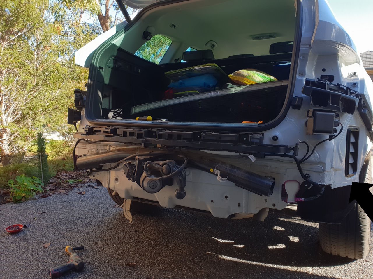

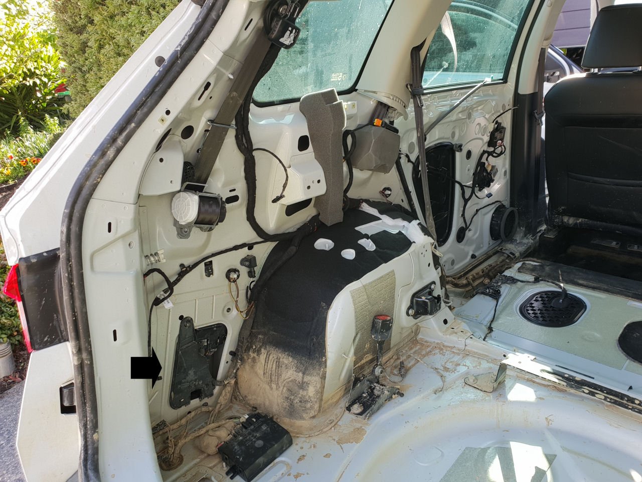

The pressure vents (let the air pressure out when closing the doors) are in the lower side part of the rear bumper.  They're not water tight.  I have verified this experimentally (but unintentionally) :)
Black arrow in this post-experiment picture.
The same experiment revealed that the genuine Skoda tow kit REMOVES the ability to screw in the rear recovery eye and that the electric tow bar will not descend when the controller (black box mounted to the floor near that black arrow) is full of muddy water.

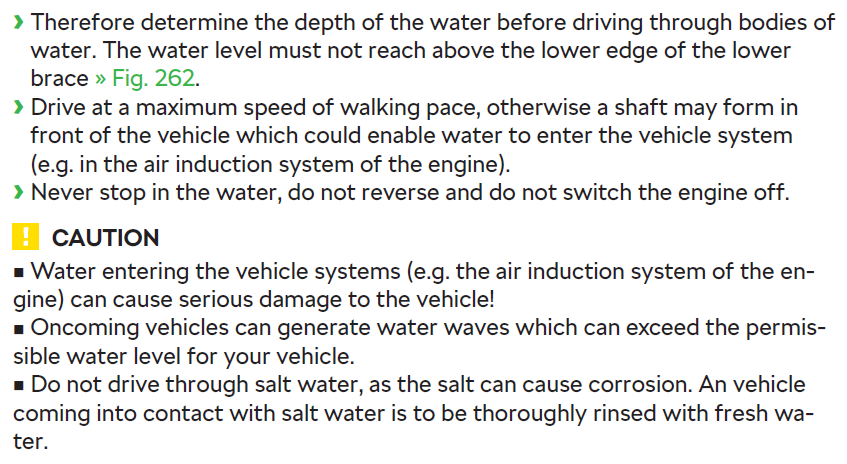

The shaft which developed ahead of the bumper was seen over the hood once in a while...
By shaft I'm guessing you mean bow wave?
If you have water washing up onto the bonnet then that suggests that the full front end of the car is under water, including all air intakes?
A sign you're either going too fast or are in too deep.
Skoda do warn owners in the manual that the Kodiaq is in no way an off-road vehicle 😂
Is that a muddy tide mark on the rear wheel arch? Is that how deep the water was inside the interior, throughout the car!? 😮
That must have taken quite some effort to clean and dry out!

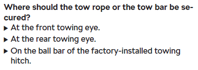

I too have gotther factory fitted towbar, and had forgotten the mention in the manual that the rear towing eye receptacle is no longer useable.

I mean the manual does say that the wading depth is a (rather crap) 7 inches or so... At least now I know to keep the towbar out when off-roading.

The pressure vents from the image explain why I had the spare wheel and the woofer their in a puddle , The water level was never that high , but the vents enable the spare wheel cavity to tank up

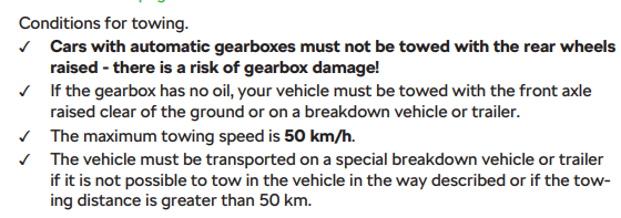

What did the Owners Manual say about towing a vehicle with a DSG.
& for towing a car with Haldex does it not say at a maximum of 30 miles (48 km) @ 30 MPH (48 kph) ?
Edited by Roottootemoot
Seems overly safe to me...VAG covering their bases as usual.
Manufacturers have been saying much the same for decades with automatics and AWD's / 4x4's.
Because of that Recovery / Breakdown services and operators say the same IME and the vehicle has to go on a Flat Bed or Trailer, or if on a Dolly the prop shaft to the rear gets taken off.
Nuh, that was the high point of the slosh marks when the car was pulled out and moved around to level again. The actual water level was quite a bit lower.  Unfortunately it was bum down in the water (diagonally), so when it was returned to level all the lovely water in the boot ran forwards to the front of the car. It also wicked a fair way up the carpets and lining (including door cards which have some carpet-underlay-stuff on the back-sides.
Car was written off due to uneconomic repairs.
