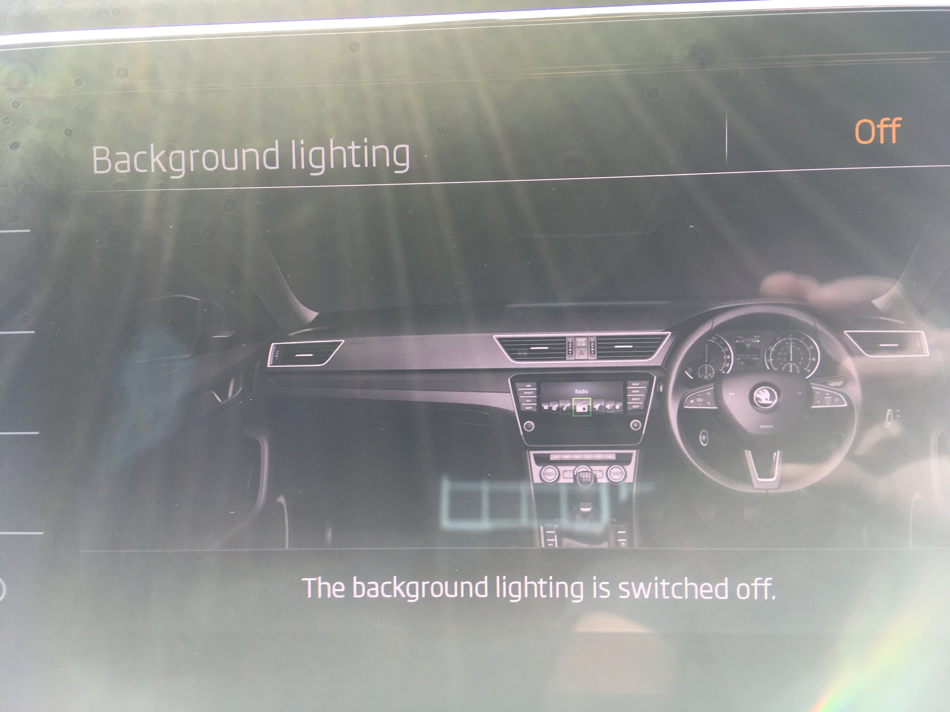

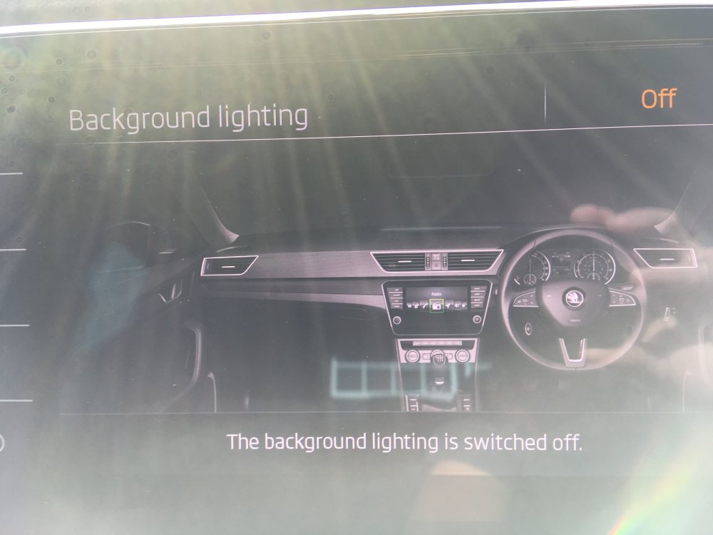

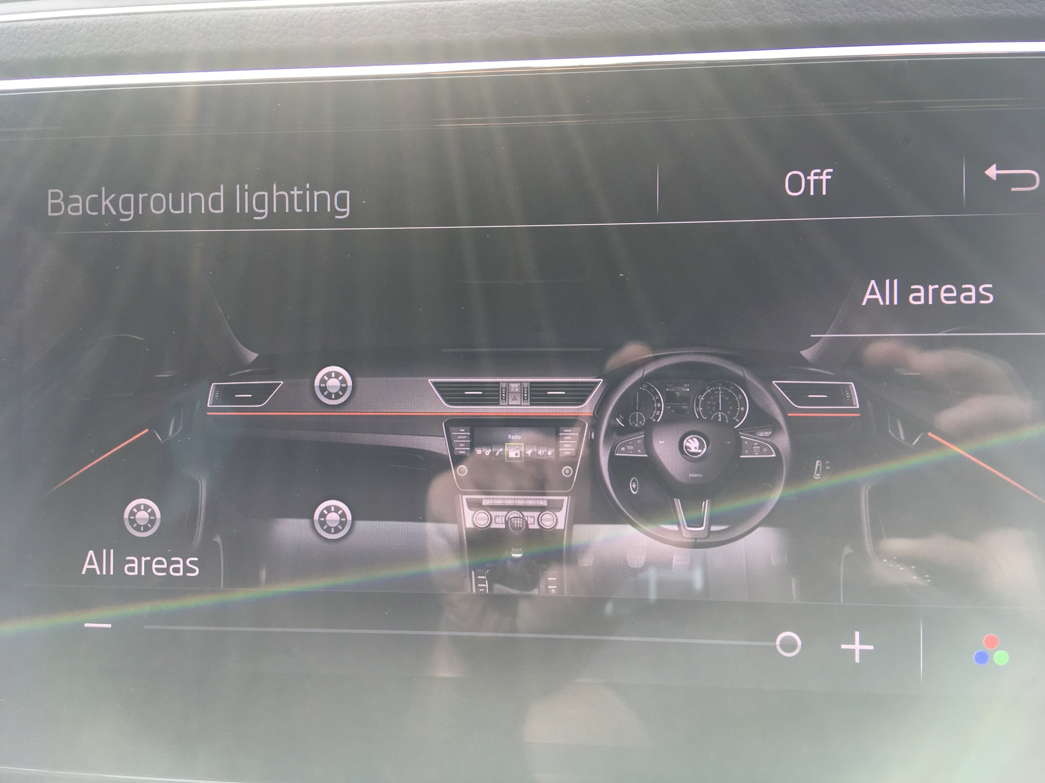

I've just been out and checked and mine are on with the engine running, with the lights set to both 'Auto' and 'Off', e.g it's not a day/night thing.  They are just always on or should be.
I can see there's two places where they can be enabled/disabled/turned up or down:
1.  The top of the screen when accessing the 'Background Lighting' menu, 'On' or 'Off'
2.  When clicking on the colour palette at the bottom of the screen, which opens up another menu to set the light levels for each area e.g front doors, dash, etc (as per @Gizmo's comment above) There's a slider bar for each area as well as a big bar at the bottom of the screen to universally change the levels.
Hope that makes sense and apologies if this is something you already know/have tried.
