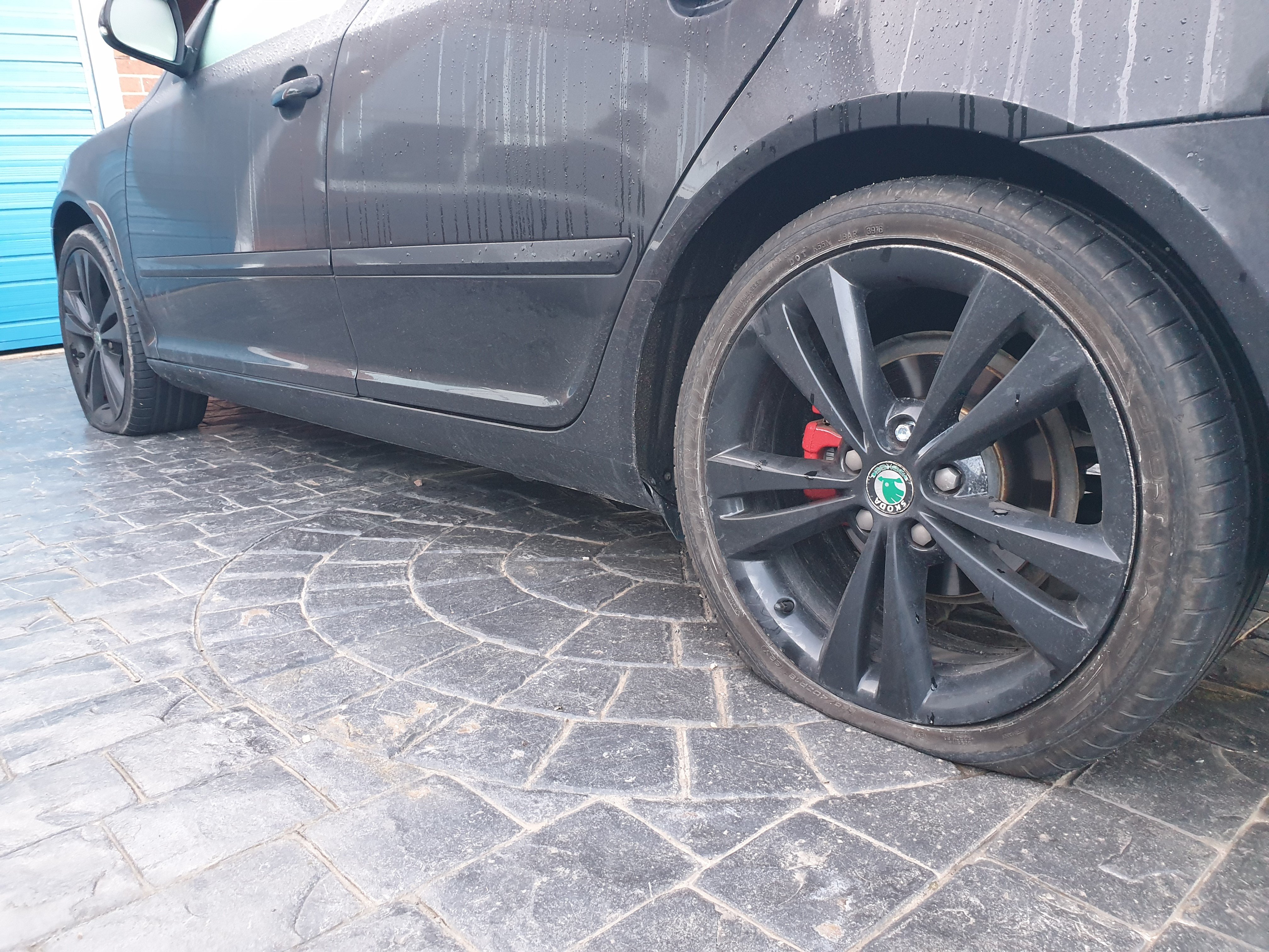

Went over a pot hole last night and burst both tyres on the left hand side of my car.  This was an annoying thing.
Previously I had 2 x nearly new Vredestein on the fronts, a new Avon back right and an older Dunlop back left.  I tried to get the same Avons to replace the two blown ones so i'd have 3 the same and a Vredestein front right on it's own.
Now the tyre place can't get the Avons so i'm getting 2 Firestone Roadhawks which means i've got matching tyres down one side and two odd ones on the other side.  They're all the same rating and similar tread patterns (not directional / asymmetrical).
Can anyone see this being a problem in the real world? I know ideally I'd be getting a set of 4 matching but i'm not chucking away 2 <6 month old tyres.  Would it be better if I got it rotated so that the firestone are a pair at the front?  Tyres on the Drive say they can't rotate them themselves due to tyre pressure monitors so presumably i'd need to take it somewhere that will take the actual tyres off rather than move the wheels.
The two in your photo both look assymetrical to me.

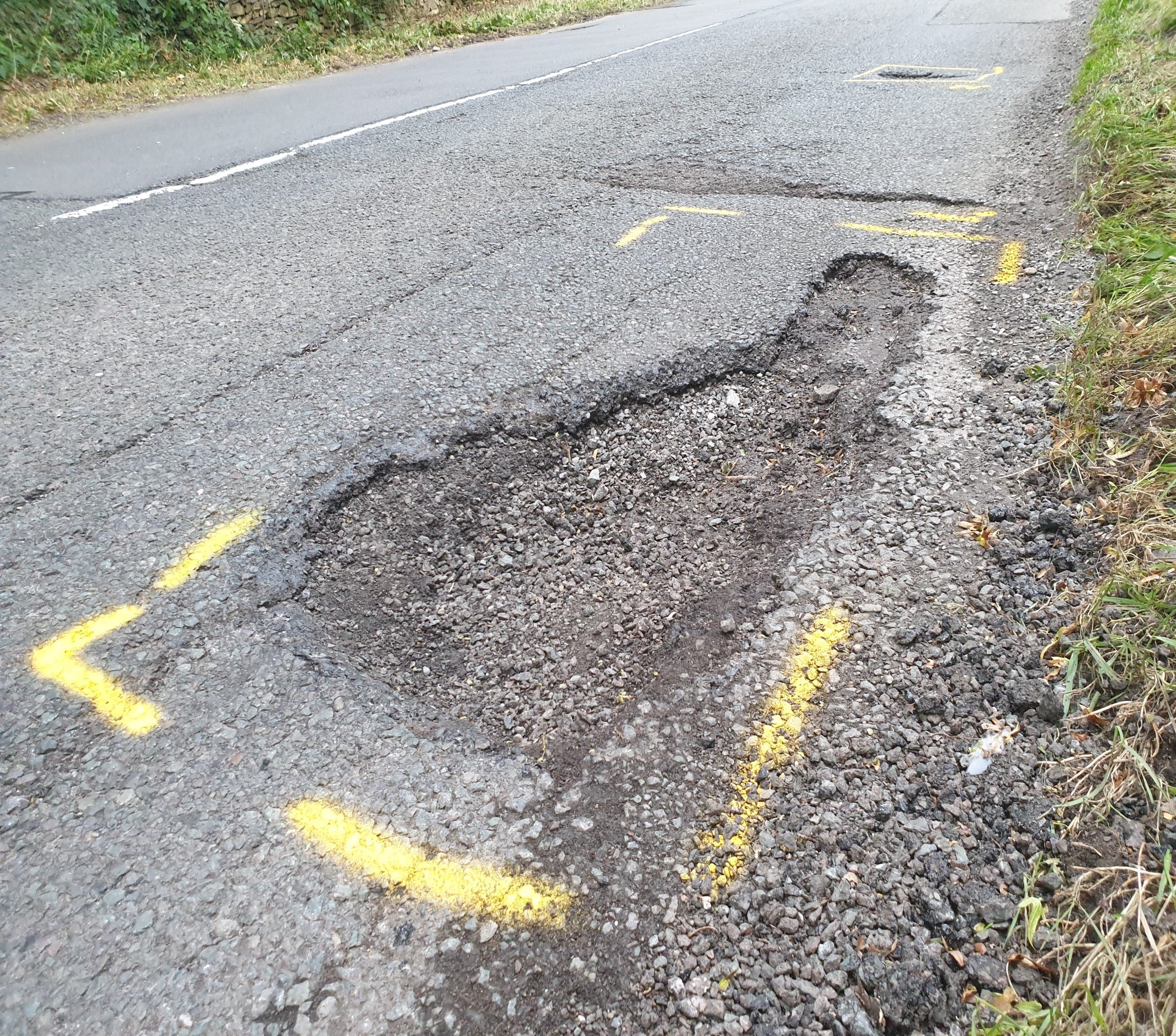

I found the culprit!
Car is driving ok with the new tyres but still think I'm going to get the pair moved to the front and have the tracking checked.
Well, that proves the council were aware of it!
Yeah! problem is yellow paint isn't much use when it's dark and the road is waterlogged
Is that yellow painting the British way of the council getting away from any responsibility? I mean if some authority took the time to mark the potholes, why didn't it bloody repair it?

No, just marking it clearly for the repair team.
