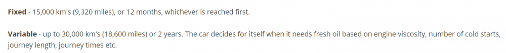

Fixed - 15,000 km's (9,320 miles), or 12 months, whichever is reached first.
Variable - up to 30,000 km's (18,600 miles) or 2 years. The car decides for itself when it needs fresh oil based on engine viscosity, number of cold starts, journey length, journey times etc.
