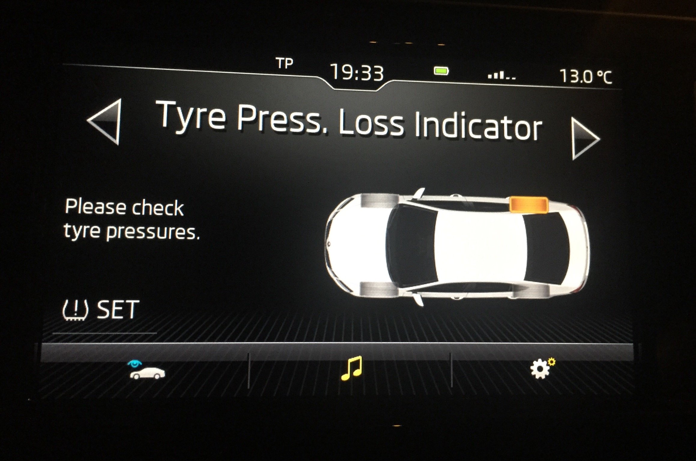

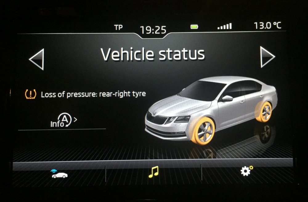

So, my 2019 Octavia got the winter season makeover. A set of new steel wheels (original Škoda 16”) and 4 new BFGoodrich 205/55 R16 winter tyres. The same size as the factory fitted alloy wheels and Michelin summer tyres. Couple of kilometers after leaving the shop, the TPMS warning lit up, complaining about the pressure in rear right tyre. It this normal/expected?
I wasn’t able to check the actual pressure, but visually all tyres looked OK.  Will do the check in the morning.
check the pressures are correct and then reset the system, I wouldn't worry about it for now
Edited by SuperbTWM
This is expected.
System needs to re-learn resonance print of each new wheel. Correct pressures and click the SET button to let it start learning.
Just remember to set the pressures with the ignition on, but the engine off, then switch off and re start, otherwise the system doesn’t remember properly.

So, the right rear tyre was indeed slightly under inflated. The system identified it correctly. I followed the recommendation table inside the fuel cover and had them inflated all at 2,2 bar, but to my eye this looks too low. At the garage they had them at 2,4-ish with the rear-right at 2,2. Any thoughts?
