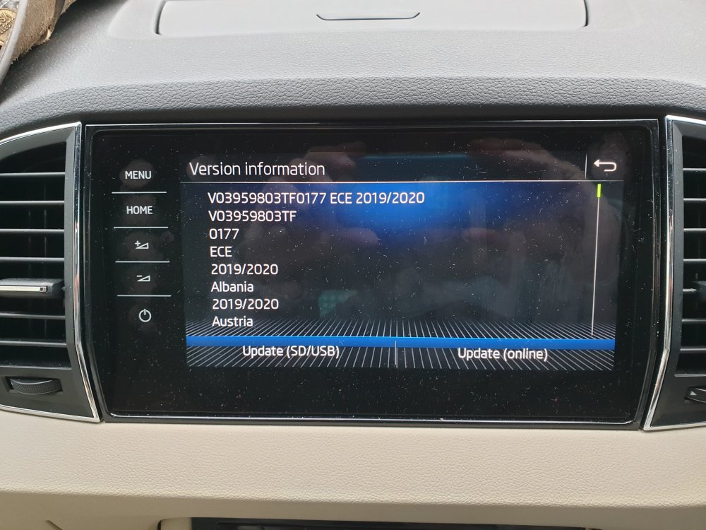

Thanks for this MartiniB, did the download ... then extracted and placed on sd card ... failed to recognise in either format .
Have to wait until skoda pulls its finger out.
is Your device Columbus?
loaded without problems

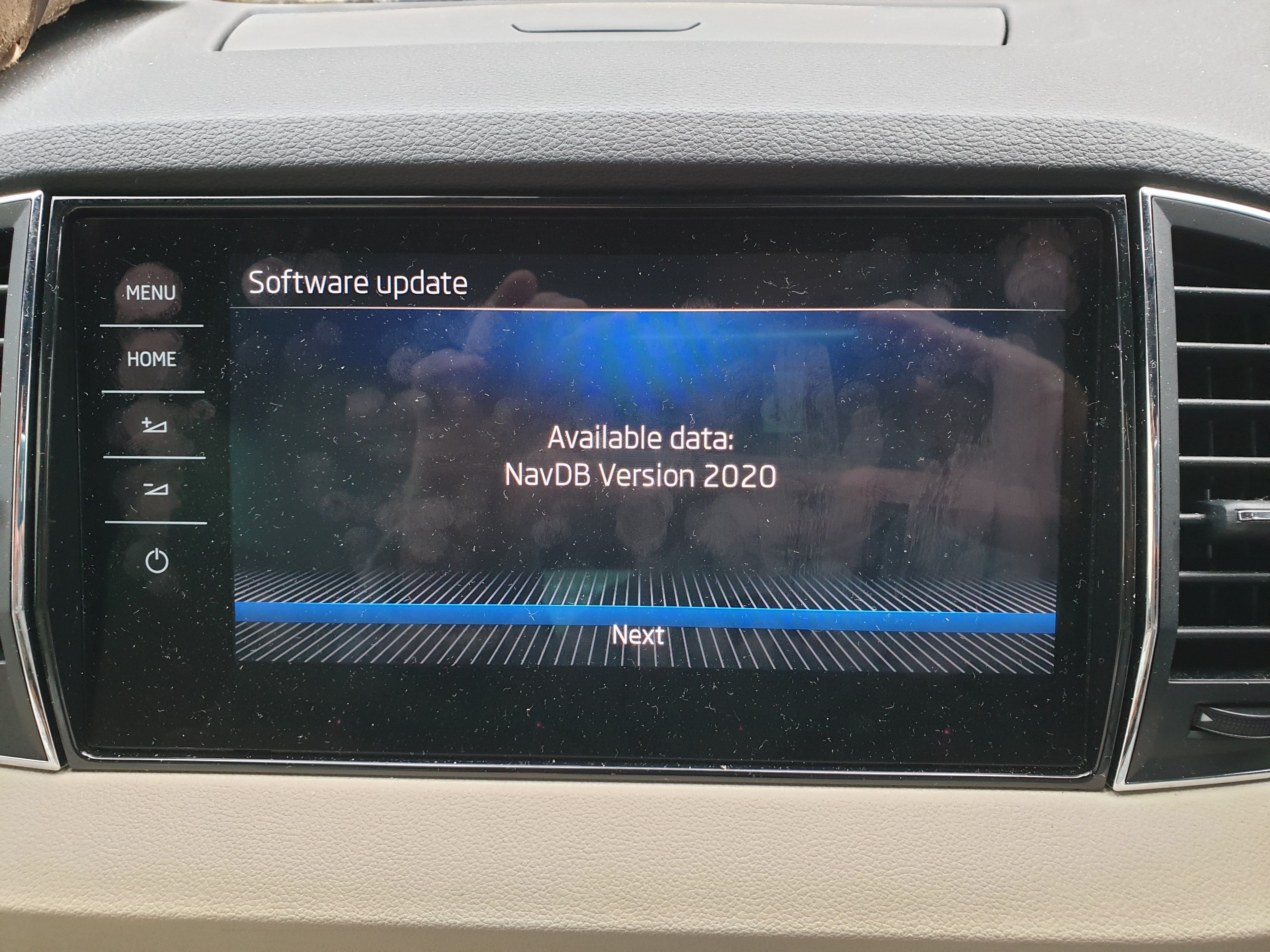

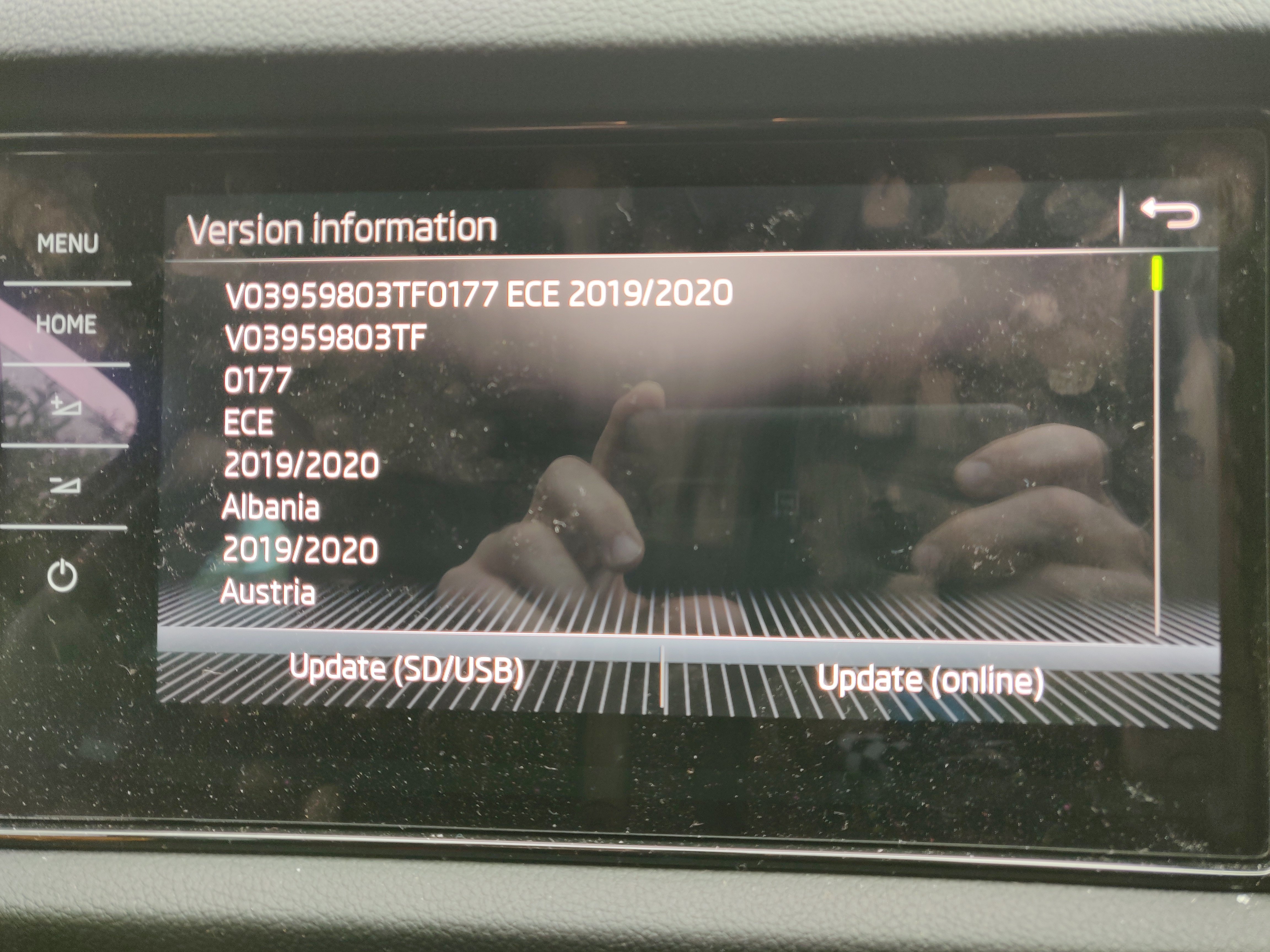

Thanks for the pic, it's a sight for sore eyes. As I said, I down-loaded from site above (ECE 2020 26Gb
Files inside:    2019.10.18
Version:    V03.959.803.?? 0184 ECE 2020
Publicized:    2019.11.08 (VW Portal)
http://vw-mapscdn.tdd.adacorcdn.com/P184_N60S5MIBH3_EU.7z) ...It took the normal 2 hours or so , then it was probably the 7.zip extraction tool that may / could have been the problem.
I used the 8 Zip lite, possibly wrong choice?
I will down load again this evening and reformat my sd to Fat32 and see what happens again.
Thanks again for showing the updated software,
Regards,
Roy

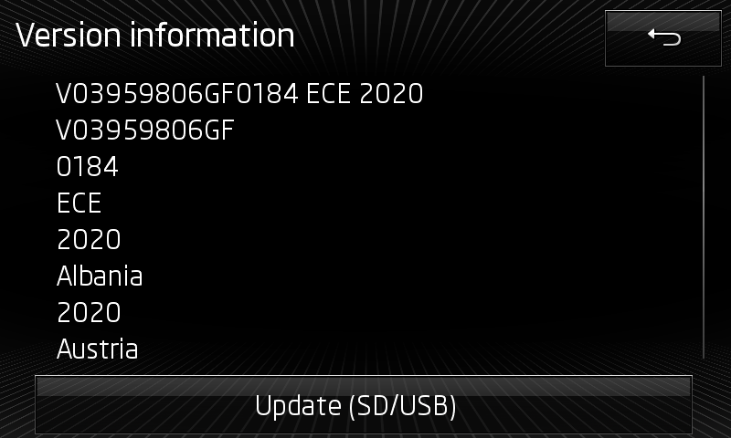

MartiniB, to say thanks again and to let you know ... I did the 2 hr download, plus downloaded the 7z1900-x64.exe  for extracting files - which seems to have done the trick.
Re-formatted (Sandisk Ultra Class 10/SDHC  sd-card) to NTFS . Then Extracting the files (3) from down load, dragged and dropped onto SD Card , where it is now doing the long haul of transferring from pc folder onto sd-card.
Hope to send you a likewise pic of update on this Columbus system.
Roy
