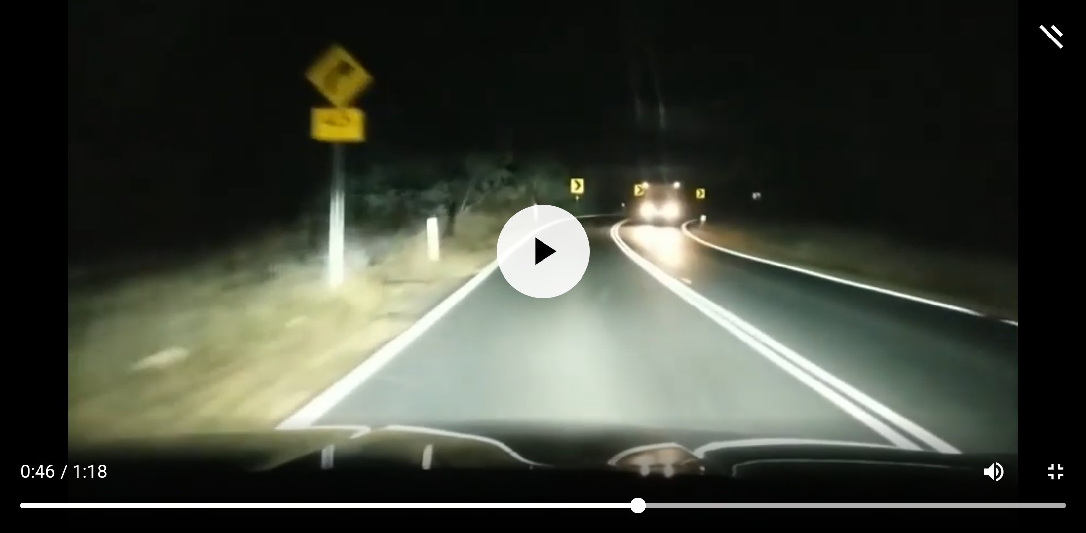

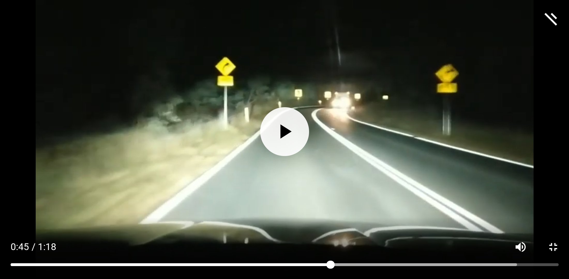

The time between 45 and 46 seconds on the 1st clip illustrates my frustration - the on-coming driver is dazzled before the system reforms the beam
So out of all that footage, the one time it's 2 secs to slow react deems the system rubbish!?!?
Crikey!!
It's an assist system.  It's not a human-replacement system.
It uses cameras and reacts accordingly.
It's not human to predict wat is coming around a corner/turn and pre-react.
SLA is a reactive system, not a predictive system.
p.s. I've had many scenarios where humans have taken longer than 2 secs to turn off their high-beams, cause they're distracted or don't realise that light travels across dividers!!
