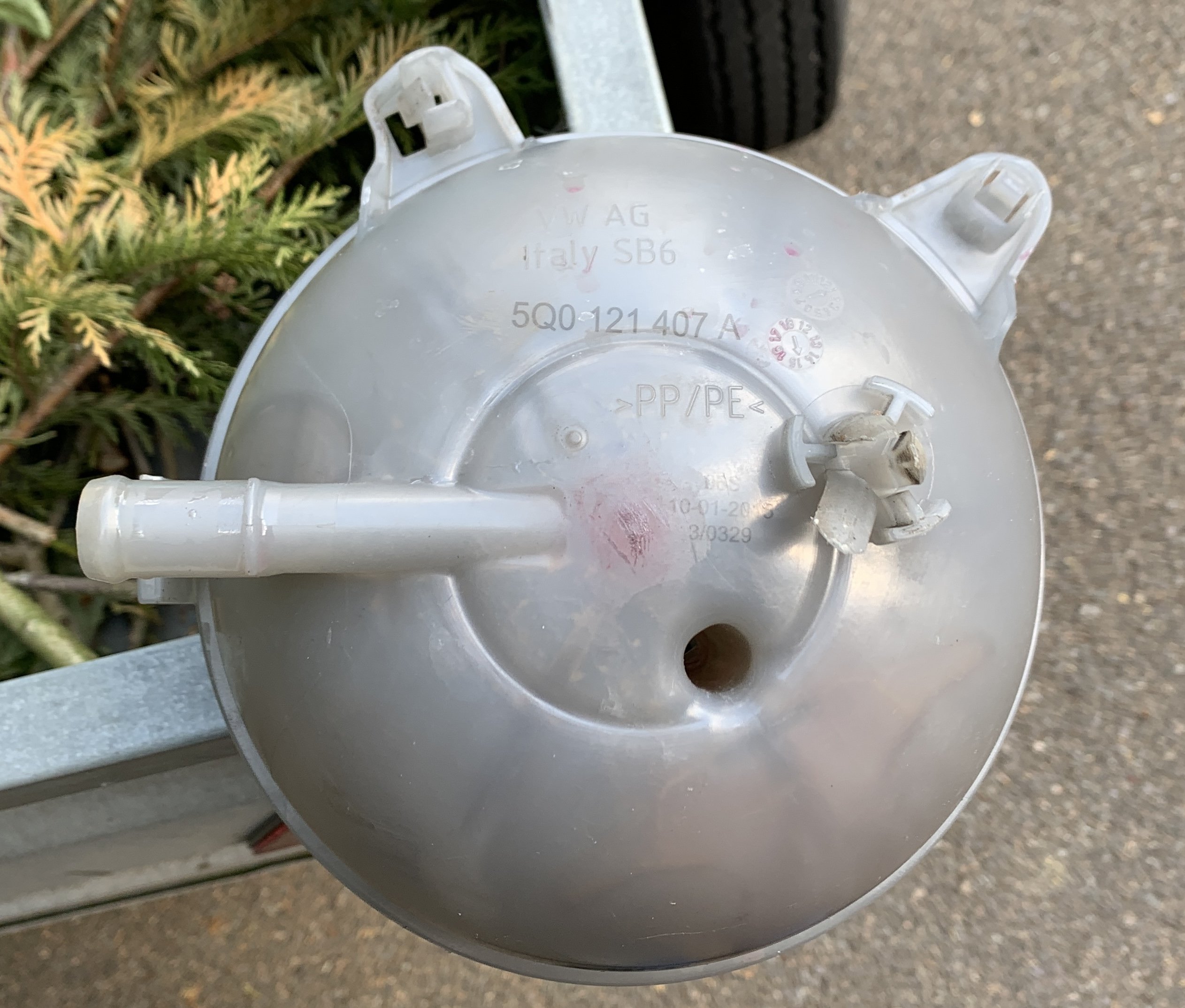

I've just replaced my coolant reservoir, as it had 'Mit Silikat' on it.
I bought a Febi-Bilstein branded reservoir from Parts in Motion for £20 including postage.
https://www.partsinmotion.co.uk/febi-coolant-expansion-tank-103446-detail
I could have bought one from Aliexpress for about £8, but I thought PIM would be a safer bet if I had a problem.
I would hazard a guess that the Aliexpress part is probably the same item.
My original reservoir was the double-walled version, part number 5Q0121407A, which was made in January 2015, the same as my car. It didn’t look like there was room for the tea bag in the inner chamber, so I’m guessing the ‘silickat’ is in the outer chamber.
The coolant was replaced recently when I had the water pump and timing belt replaced, so it should be good for some time.

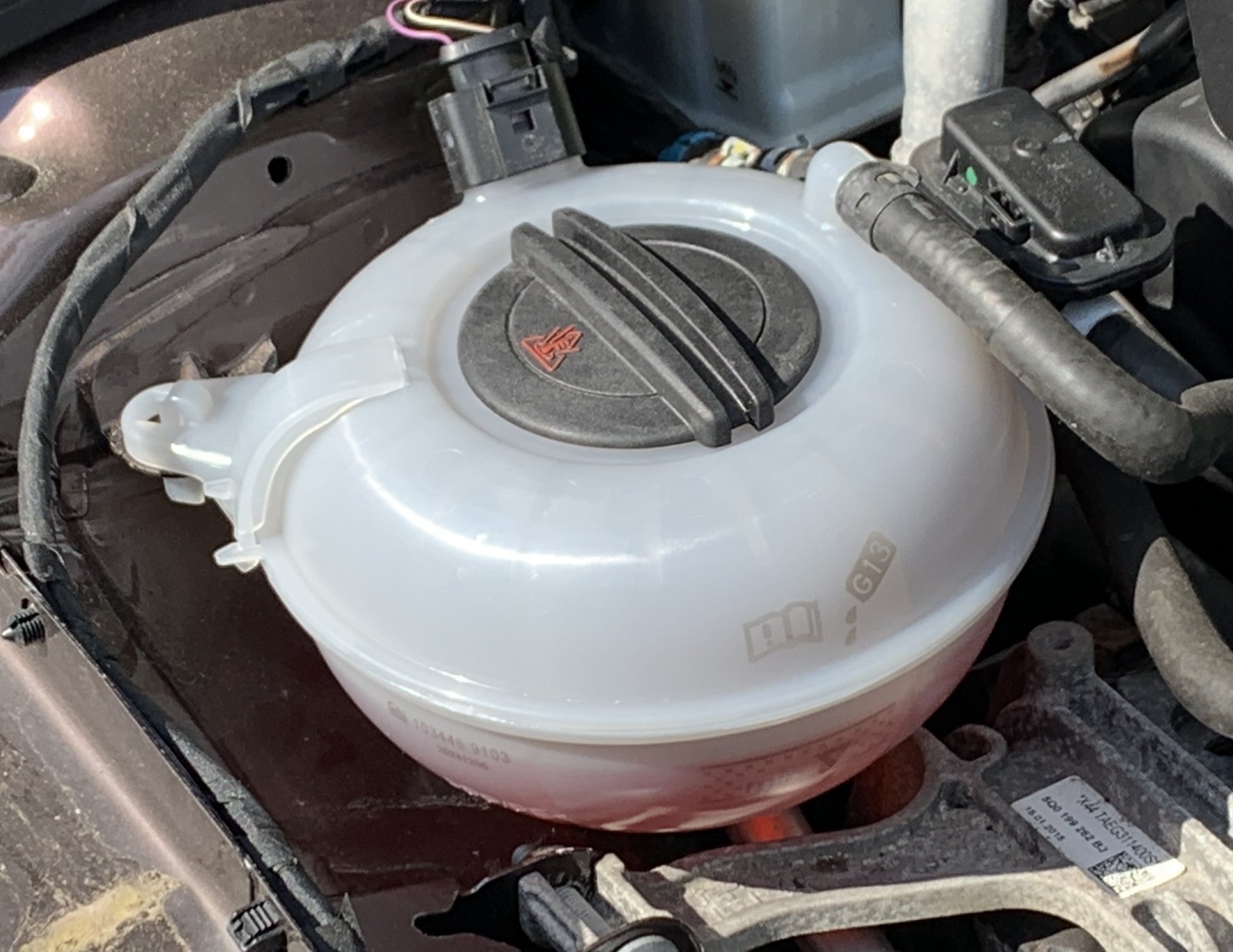

Yesterday I have replaced my 5Q0 121 407 F with 5Q0 121 407 AA. I haven't found any information about the F version in this thread so I will share my findings.
The "mit silikat" marking wasn't there, but the G13 marking was, so I just replaced it to be sure.
Today I cut the tank open and it was completely empty. The only difference I found between the tanks is that the F version has the G13 marking and the AA version has no marking at all.
Maybe this information will help someone and they won't have to change the tank unnecessarily like I did.
Now I plan to replace G13 with G12evo.
BTW, I have Skoda Octavia Mk3 1.0 TSI MY2017.
