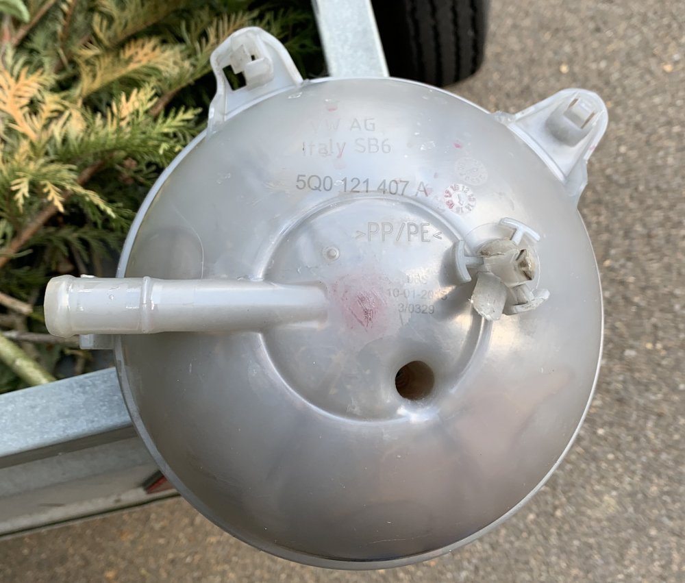

  • I think the smallest tsi engined cars were not fitted with the "mit silicat" header tanks - my sons 2016 mkIII 1.2tsi isn't.   The G13 coolant contains silicat and this deplenishes in time,
  • Removed a double walled mit silikat tank (part number ends in a ) and replaced it with a new M which is without along with mixing up fresh g13 to replace the old that was removed.   few inte
  • The part number is the same as the old tank, but with an M suffix rather than anything else. Most dealers over here seem to keep a couple on the shelf.    I don’t claim to know better t

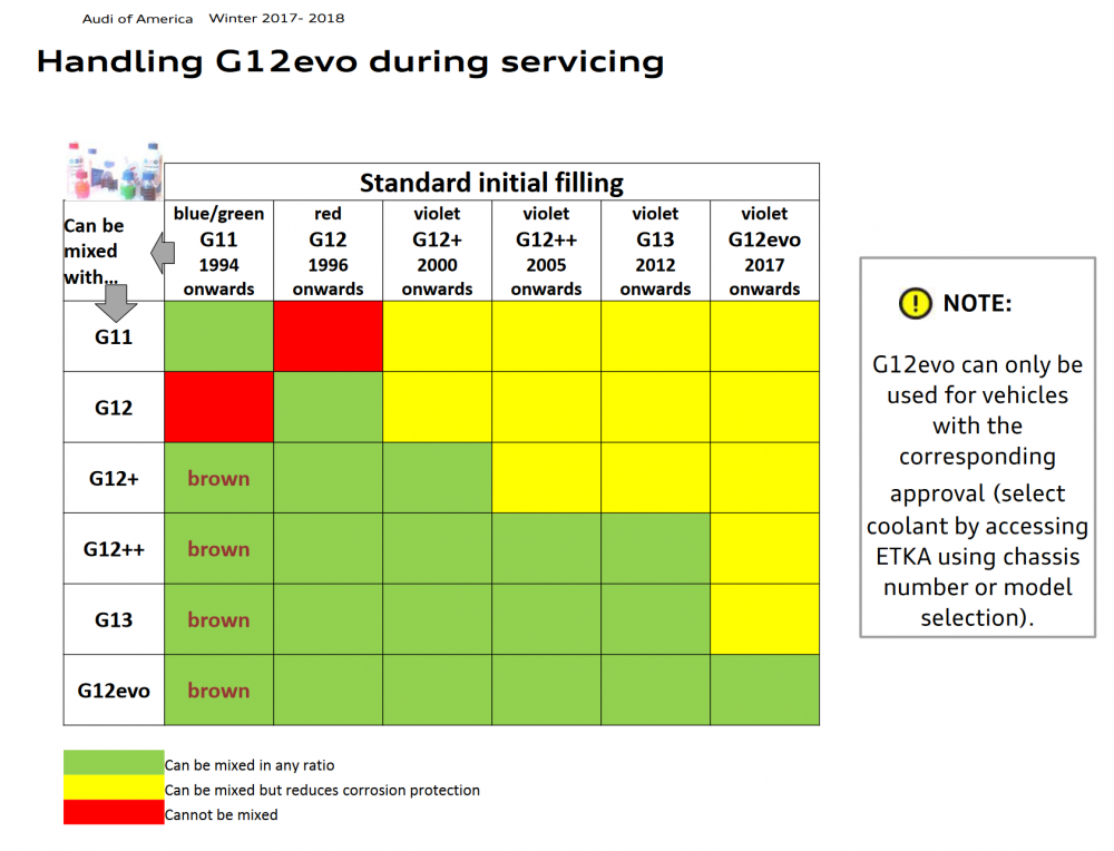

One Brisky member turkey-basted his coolant out prior to removing his expansion tank, and then returned it after the new tank was fitted, with a small top-up, if I remember correctly.
Less than ideal - why not use brand new G12evo ready-mixed instead?

Actually topped up with fresh, pre-mixed G13 - turky baster was used to empty the header tank so as not to spill old coolant into engine bay.
When I find an easy way to drain coolant without risk of creating an air lock, I intend to do full coolant change - probably G12 evo.

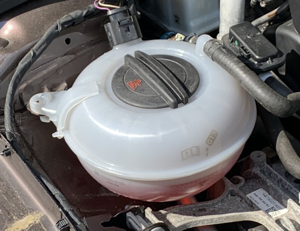

Hi all!
I recently joined team vag after years with MB.
I found out about this issue with the silicate bags and immediately took a glance to my expansion tank. No problems in the heating and the liquid is clean and pink.
The tank is "two wall" design and even with a strong torch/flashlight shining through the tank I was not able to locate any bag or capsules. Tank has no label for "mit silikat".
The car is Superb 2020 facelift 2.0tdi dsg 4x4 and part nubmer for the expansion tank ends with AA, yes two A letters. It seems that this model of expansion tank is also used in the latest Octavia mark 4. I found this out by looking parts online from crashed cars here in Finland. I was not able to find any additional information about this version of the tank.
Is there anyone who can verify, whether this expansion tank has silicates or not? Thank you!
