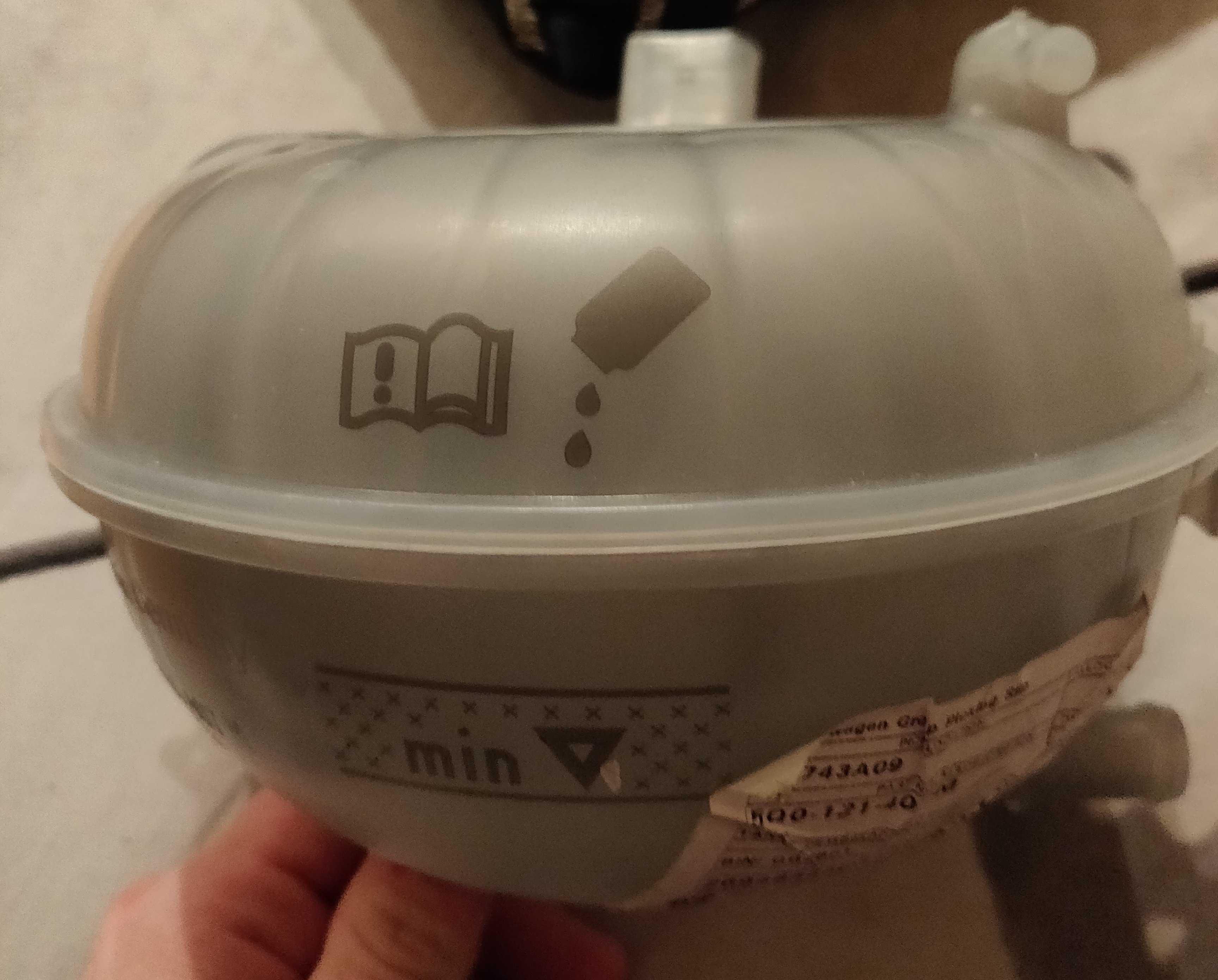

IMG_20191213_164652__01.thumb.jpg.bdbf2cbac51379bf2ca2def78f68a6c9.jpgNew Tanks don't have the bag, I collected my replacement tank on friday, the writing is also gone from the new tank. The dealer said the part is now on back order, they got this one from another branch as they had one left
Interesting there is no g12 -g13 stamp wounder if there is a new coolant grade comeing down the line
I noticed that too, no doubt they are working on G13+ or another formula
