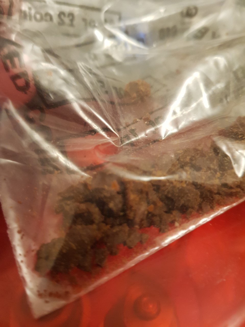

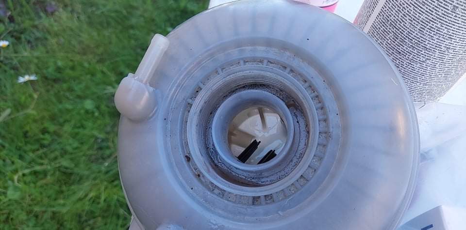

Well after Skoda had one go  i got this out and then they had it back again     oh and i removed an unbroken bag
