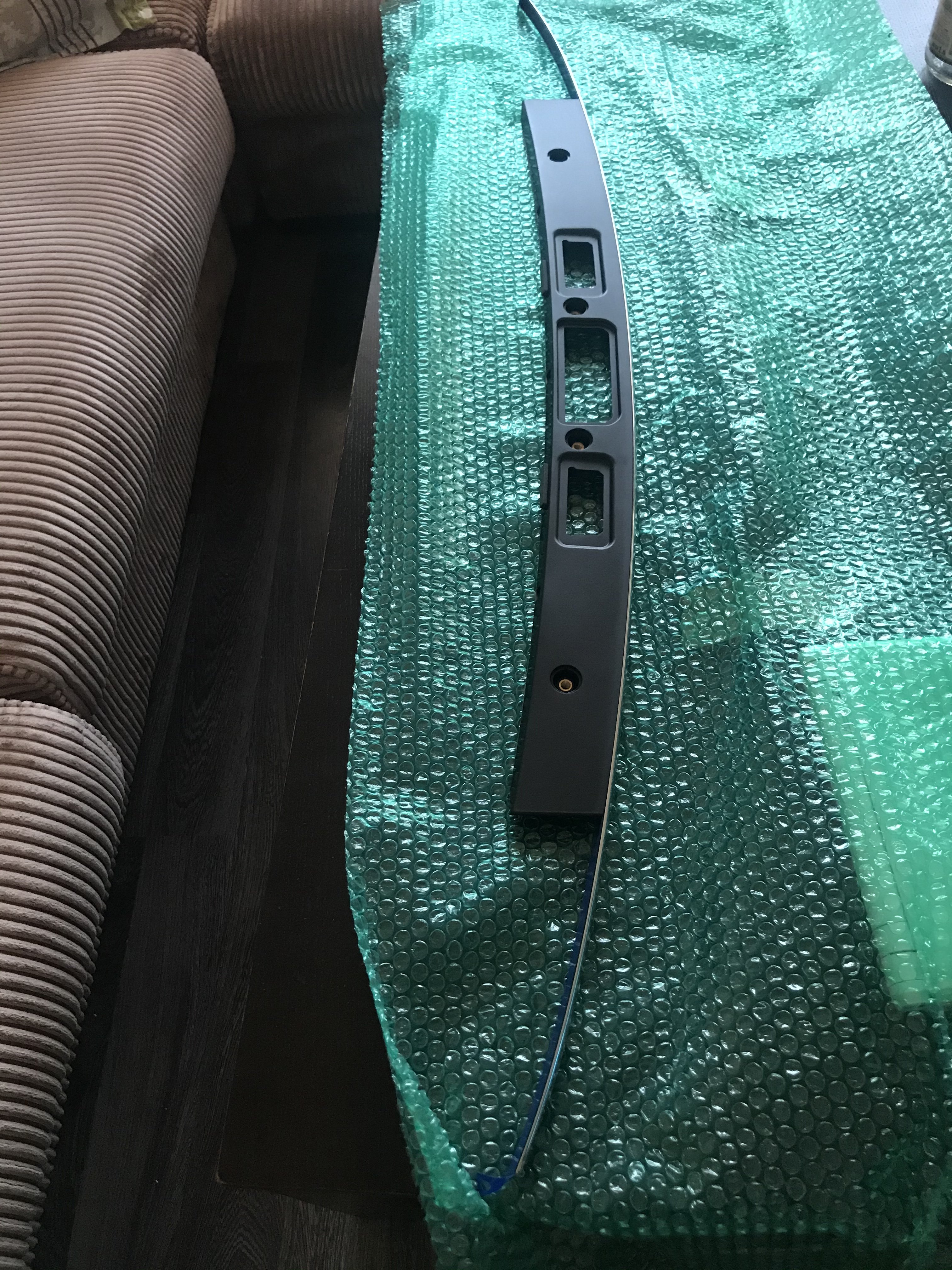

The lath came
here's a bonus, light but you order it by the number in the photo and its price is three times lower

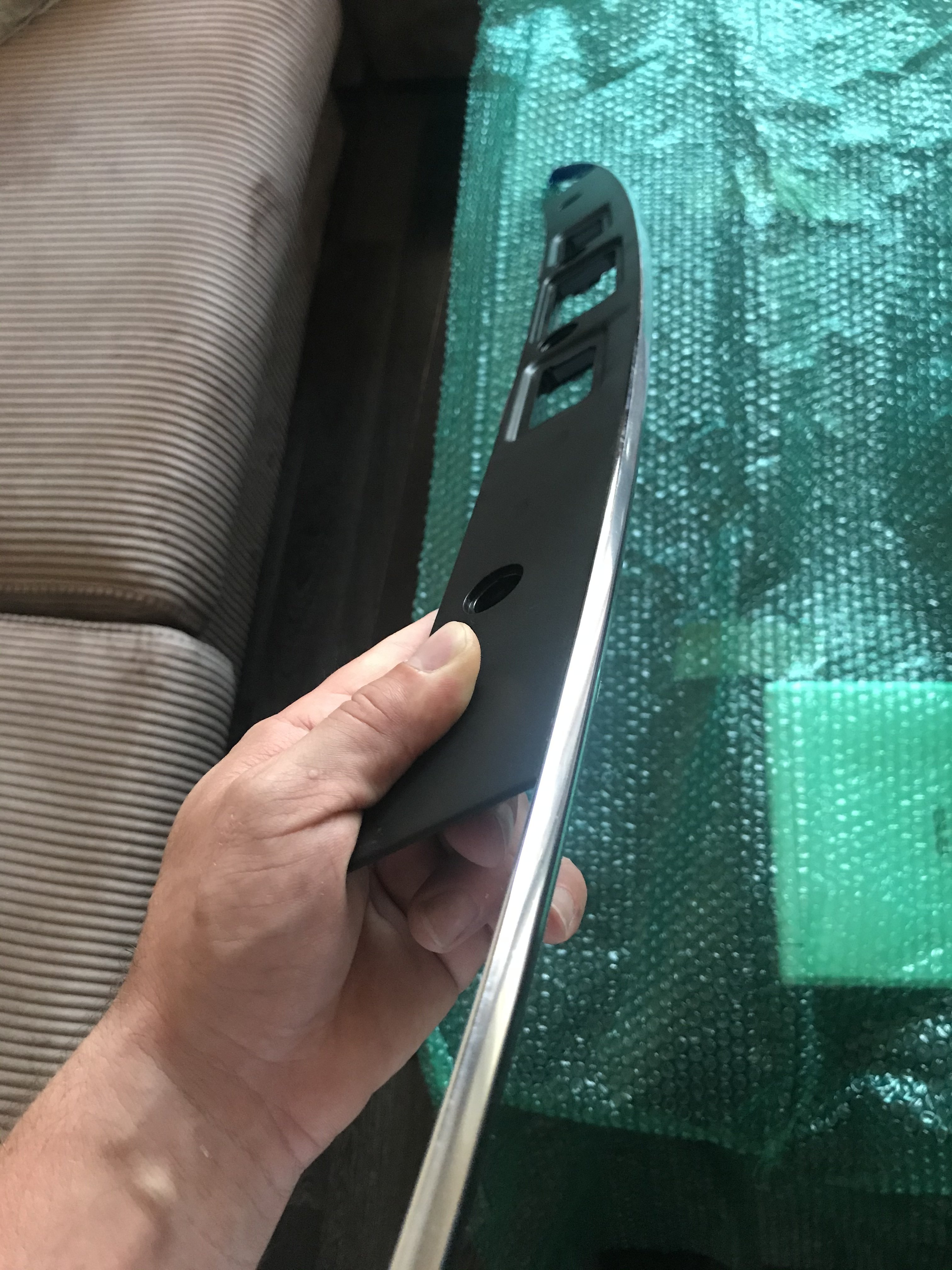

@ssavi Would you be able to advise the supplier from whom you purchased the Chrome boot lid strip above?
Thank you.

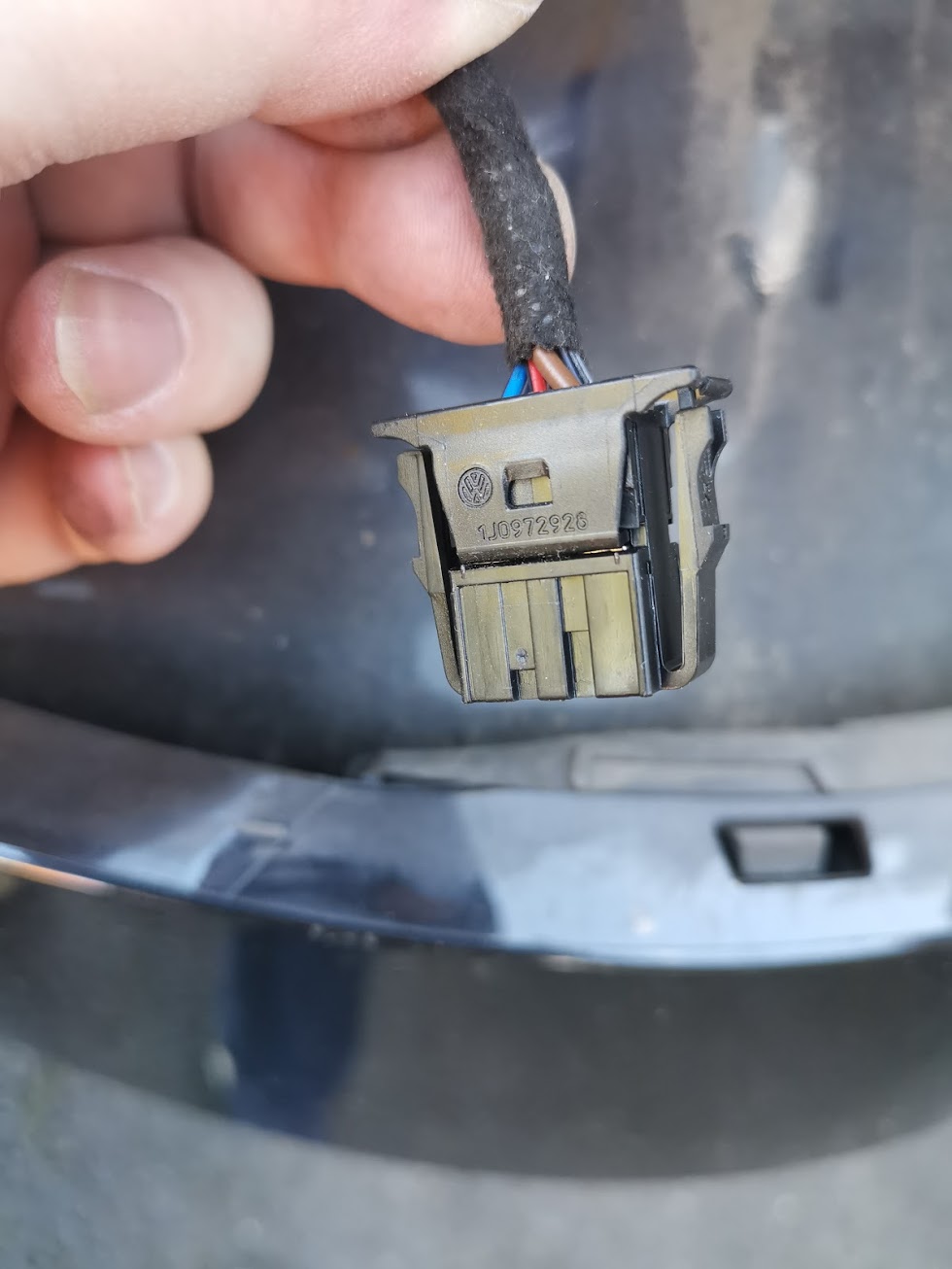

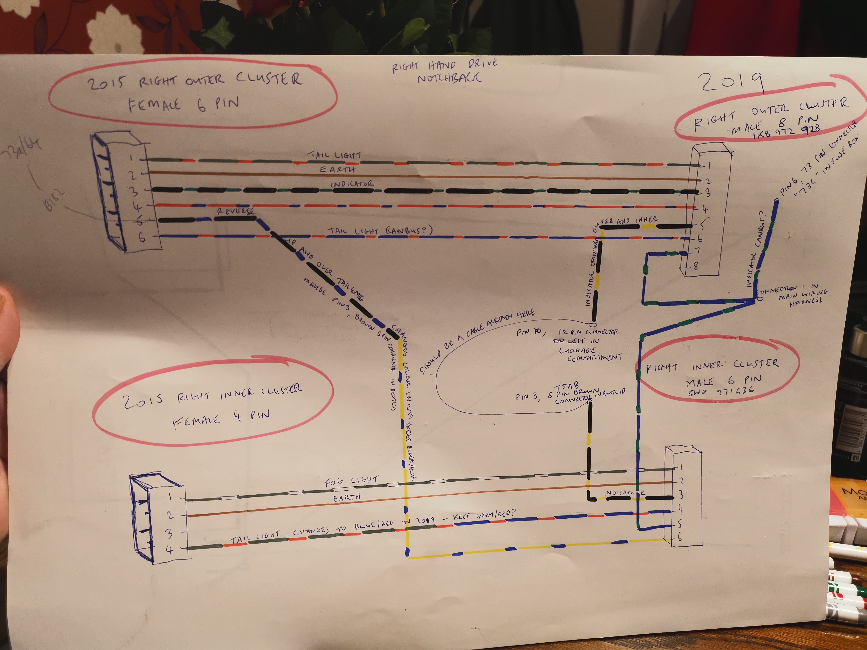

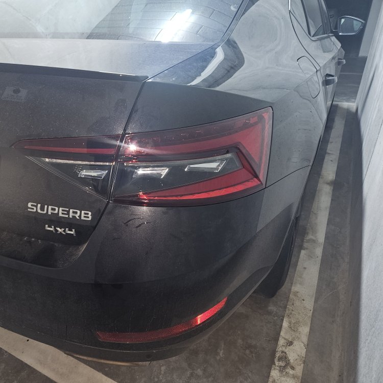

Does anyone have access to ETKA to figure out what the part numbers for the connectors are? I need pre-facelift female connectors and post-facelift male connectors in order to make a proper conversion harness, but I can't find a name for these connectors or any part numbers for them. I have the wiring diagrams if anyone needs, let me know and I can tell you the colours - I won't post them here because it's probably a breach of erwin and/or briskoda rules.
I picked up a set of facelift rear lights (outer and inner lights, 4 parts total) for £370 + £20 delivery (I found someone on ebay breaking a facelift, although it had chrome trim - I wanted black sportline, so I'll have to wrap the chrome strip on the rear lights).
The seller wouldn't sell me the boot handle, number plate lights or tailgate strip/frame that holds the handle and number plate lights, because he wanted to sell the tailgate as a complete unit, which I understand. I'm hoping I can get away without using the chrome strip on the boot, as I really don't want it anyway - if the tail lights look ok with the chrome wrapped black and no strip on the boot, I'm happy.

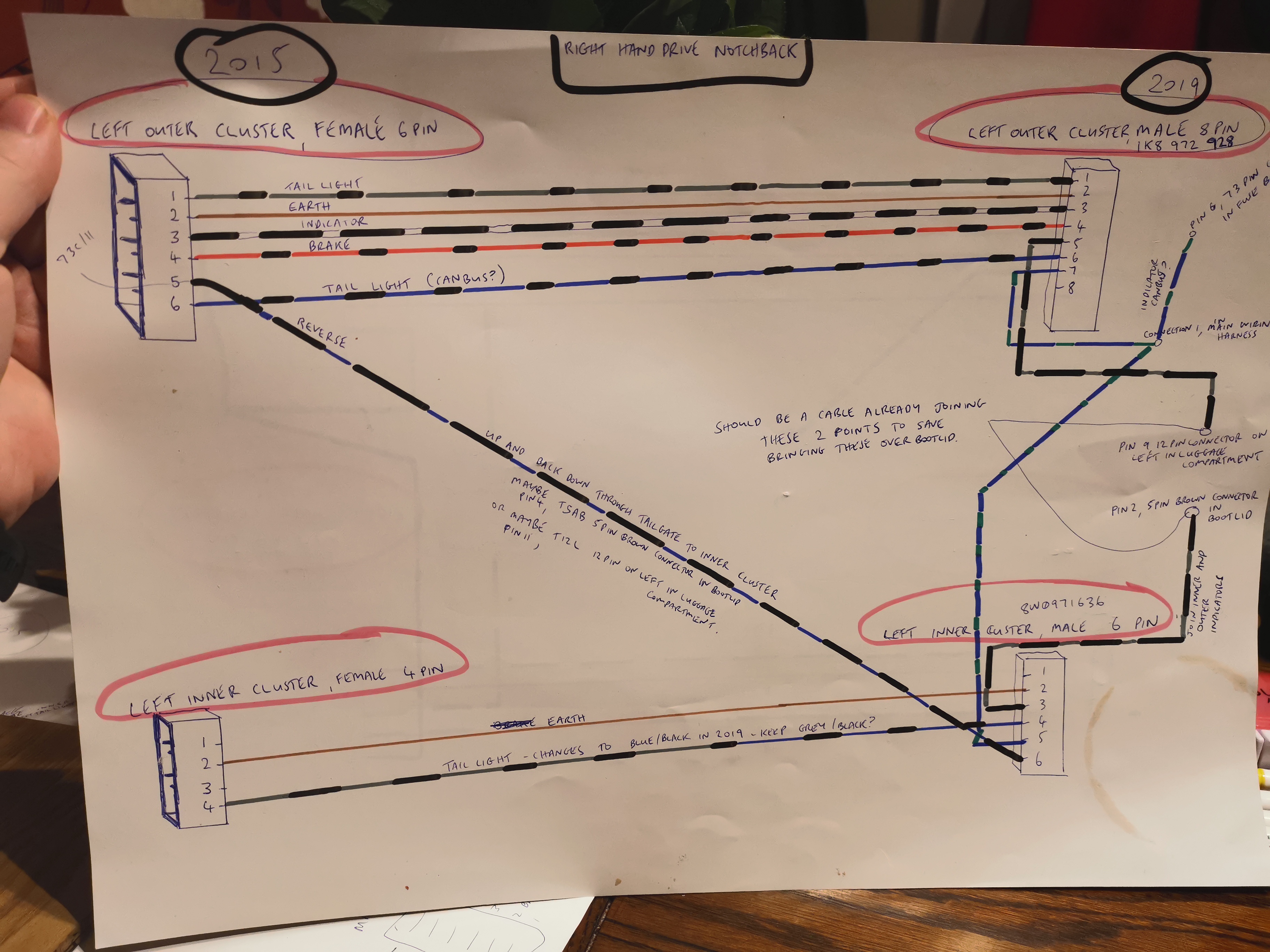

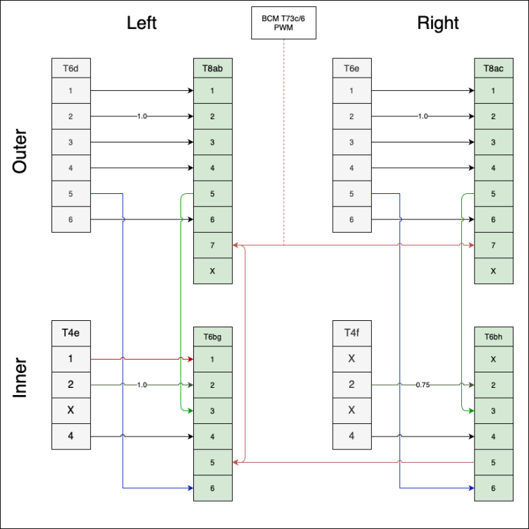

To answer some of my own questions here, I've made some diagrams of what a facelift tail light adapter set of conversion harnesses would look like to aid myself in . These diagrams are specific to Right hand drive notchbacks/liftback/hatchbacks (i.e. not estate/kombi/avant)
Thought I'd post them in case they're helpful to someone.
As you can see, it's pretty much a straight pin-for-pin mapping with 3x quirks -
a) now that the indicator is on both the inner and outer light clusters, some joining of these needs to happen
b) now that reverse has moved to the inner cluster, a wire for this needs dragging up over the bootlid hinge and back down
c) 2019 has a new wire on each side going all the way back from the indicator to the fusebox via connection 1 in the main harness, some sort of Canbus wire maybe?
I'll update the thread once I've built the harness and plugged the new lights in. I'm thinking I should build 2x harnesses while I'm at it if I'm doing one, so that I have an extra set for the next person who's thinking of attempting...

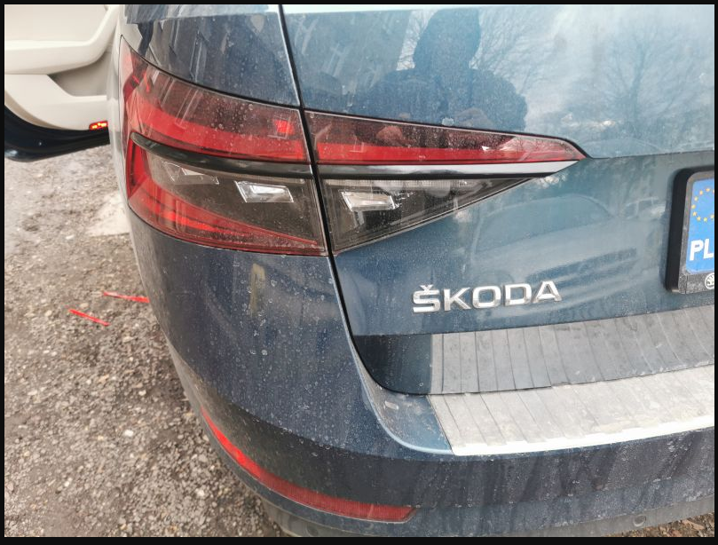

The set I found from the breakers yard had the chrome strips. For anyone wondering, they come off fairly easy with a hairdryer to heat the adhesive and some isopropyl alcohol to clean up. I plan to retrofit the taillights and avoid the need for a strip along the bumper and all the hassle of changing handles and number plate lights as well, besides I prefer the look without the strip. So I think it'll work just fine retrofitting the lights alone with the chrome strips removed from them. Here's a closeup video of one with the chrome removed. https://photos.app.goo.gl/uTfZ6d9dqm9pbaHs8

inner connector inner pins outer connector outer pins

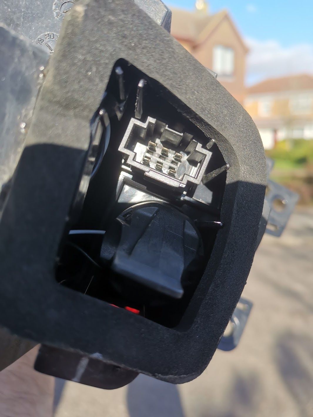

8W0971636 000979009E or N90764701 1K8972928 AMP MCP 1.5K Female Crimp Terminal Contact 1241381-3
so I've figured out these are the correct connectors and pins you'll need on the 'lights' end of the harness.
I need help figuring out the connectors on the 'car' side

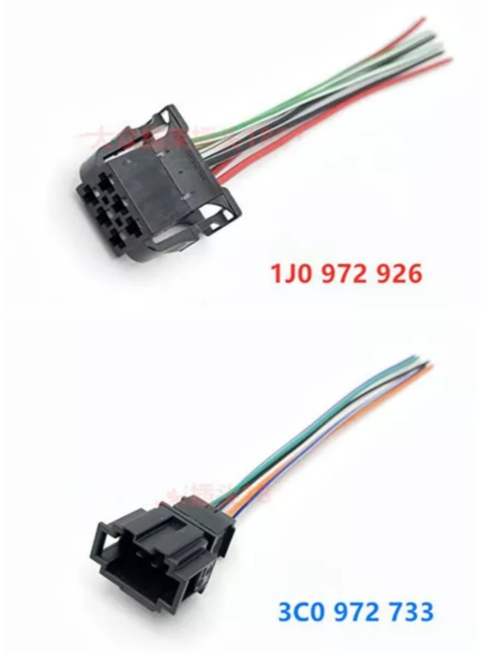

If anyone knows the part number for the female plug in this picture, please help! I know it's the female version of 1j0972928 / 1J0972926, because the male plug on the existing car harness has that stamped on it.
I’m afraid I can’t help yet but please keep going on this as it’s a mod I’m really ready for when I collect my Superb next week!! Would love to join the FL rear light group like I have with my Octy. Good luck!

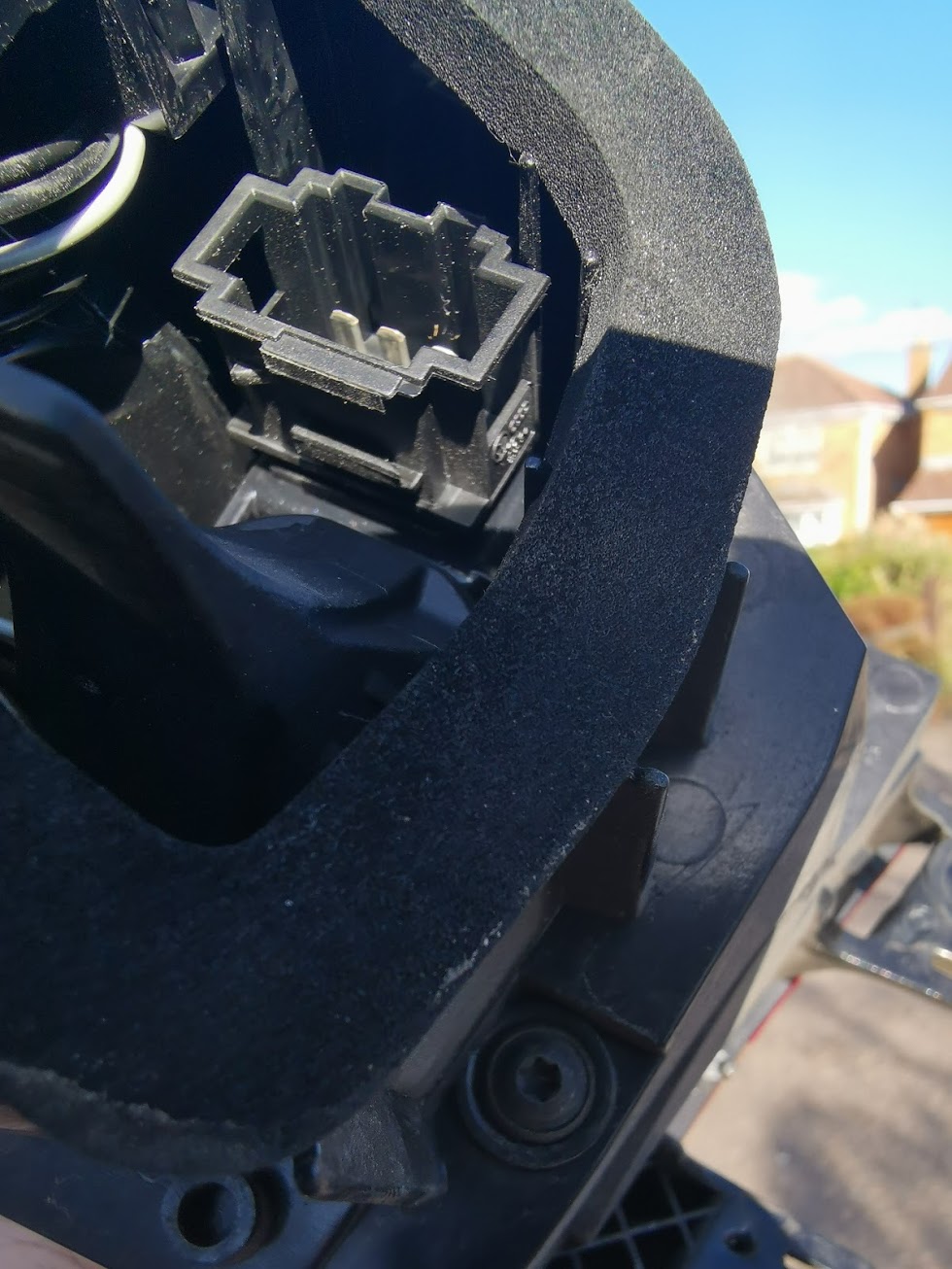

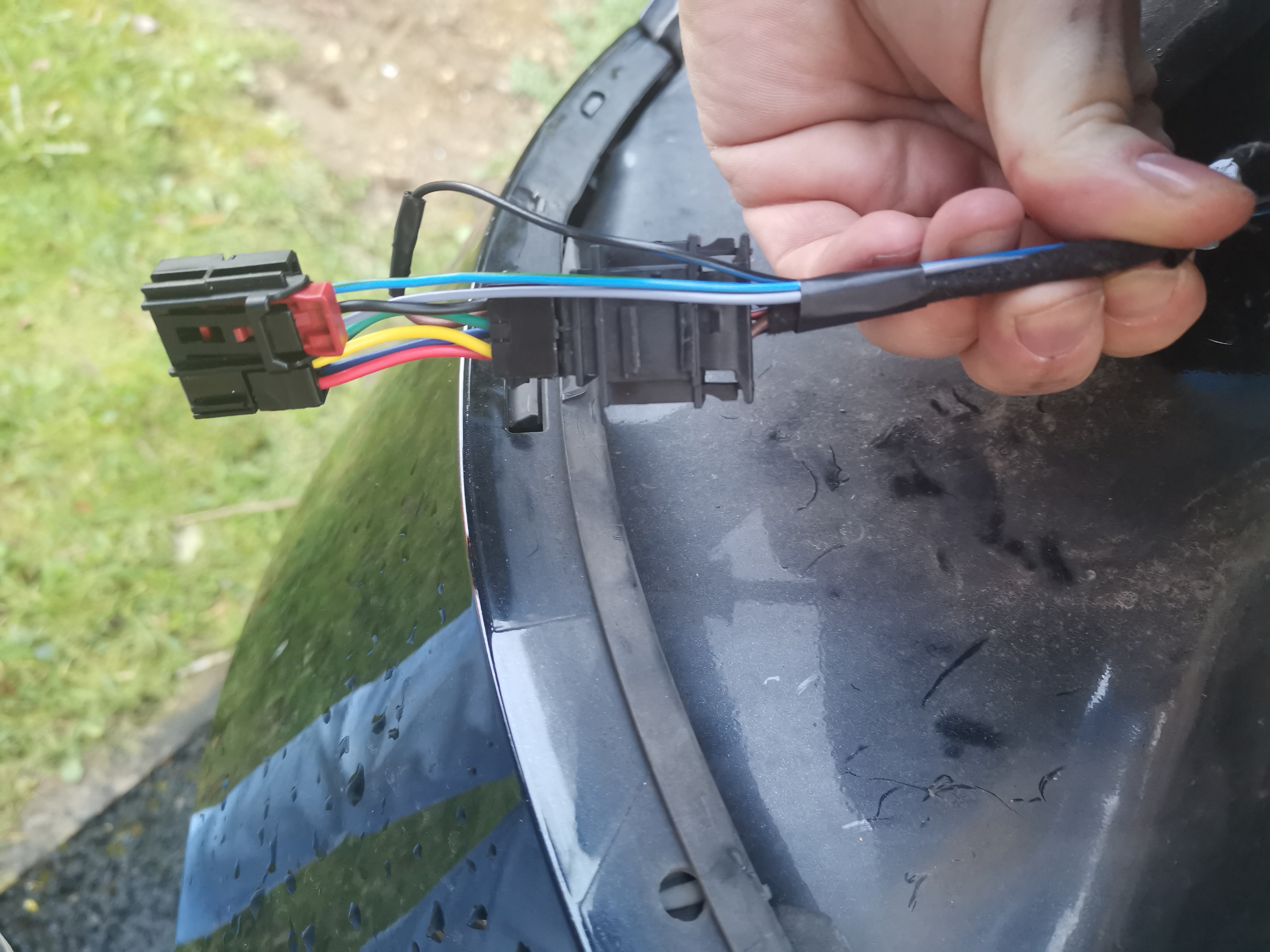

One step closer. Well this was ridiculously hard to figure out, but I eventually found another place where this connector is used in an audi seat mechanism, and the corresponding plug it fits into, so I now know the part number needed to plug into the cars harness on the outer side avoiding chopping into it. It's 3C0 972 733. Gotta patiently wait for aliexpress China shipment now. Meanwhile let the hunt begin for the corresponding part on the inner light harness
Have now finally found the corresponding part to plug into the inner car harness - 3B0 972 732
£0.33  19%OFF | 1 Set 4 Pin 3B0 972 732 3B0972732 3B0972722 Car Taillight Plug Auto Electrical Wire Connector Socket For VW Audi
https://a.aliexpress.com/_mOAk2EB

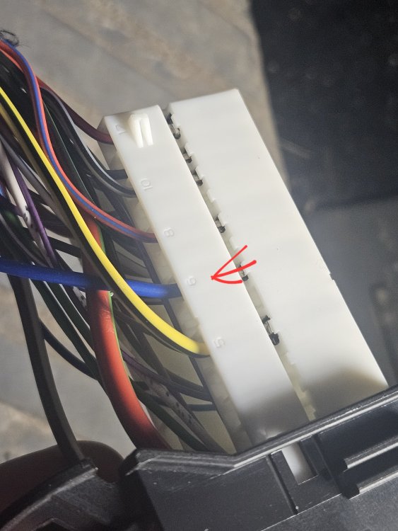

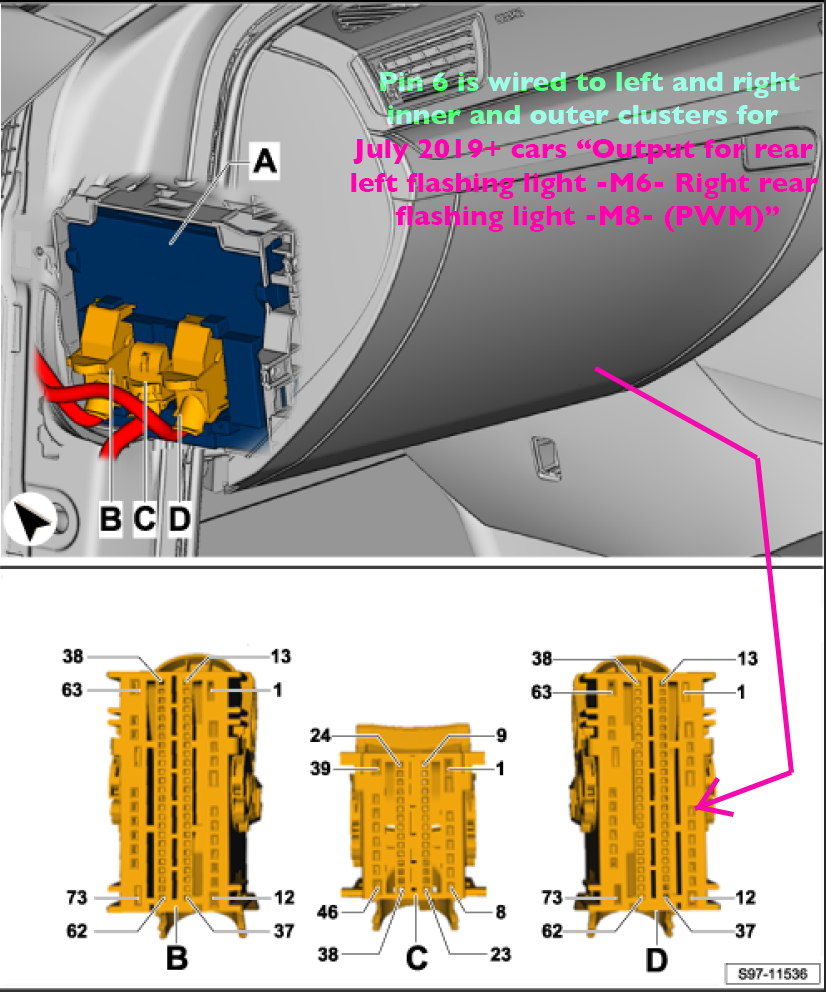

July 2019+ cars have all 4 indicators (inner and outer clusters on left and right) wired back to this pin - some sort of pulse width modulation signal. I wonder whether there's any point in me going to the effort of wiring this if pre-2019 cars have no ability to send out these pwm signals, which I presume are only used for the 'coming home animation' that some retrofitter noticed was missing? if anyone can tell what this pin does (if anything) on pre-2019, please let me know, or whether it's just a pin that coding could 'turn on' to make whatever the function is work?
this is not power, the indicators are separately wired for their power to flash them

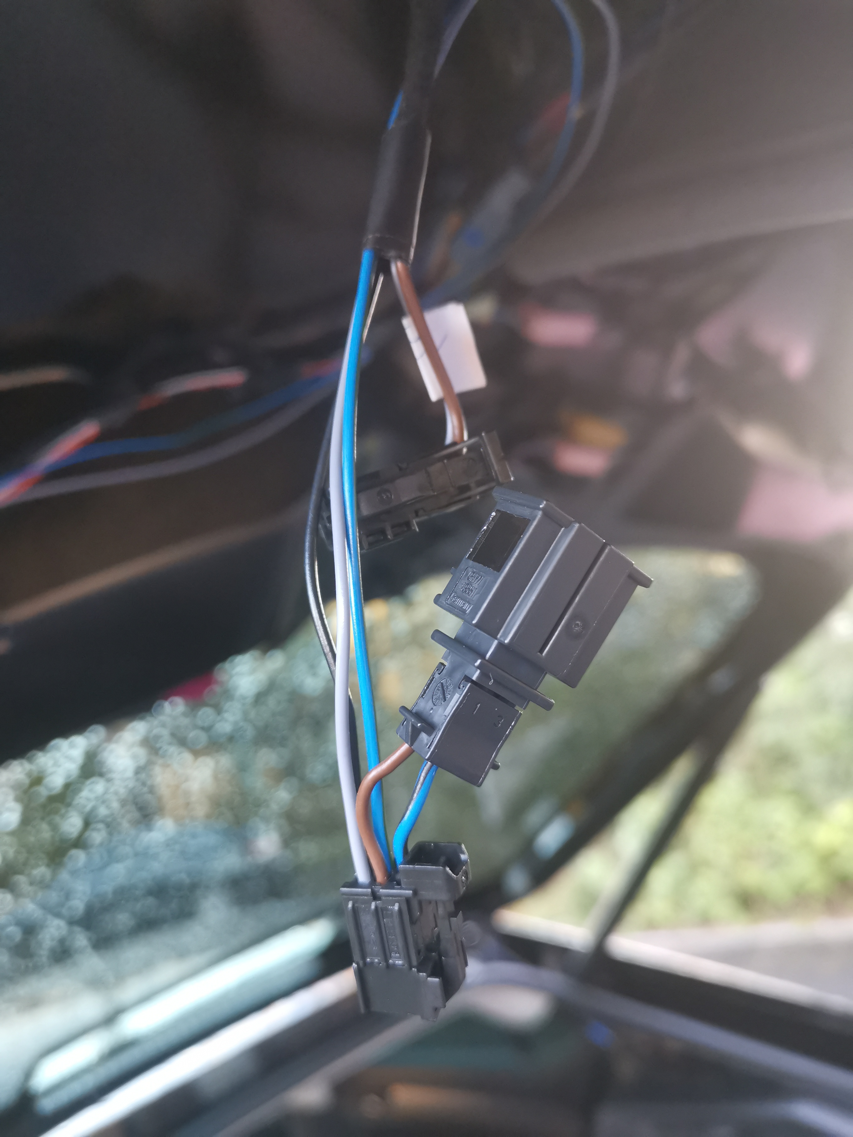

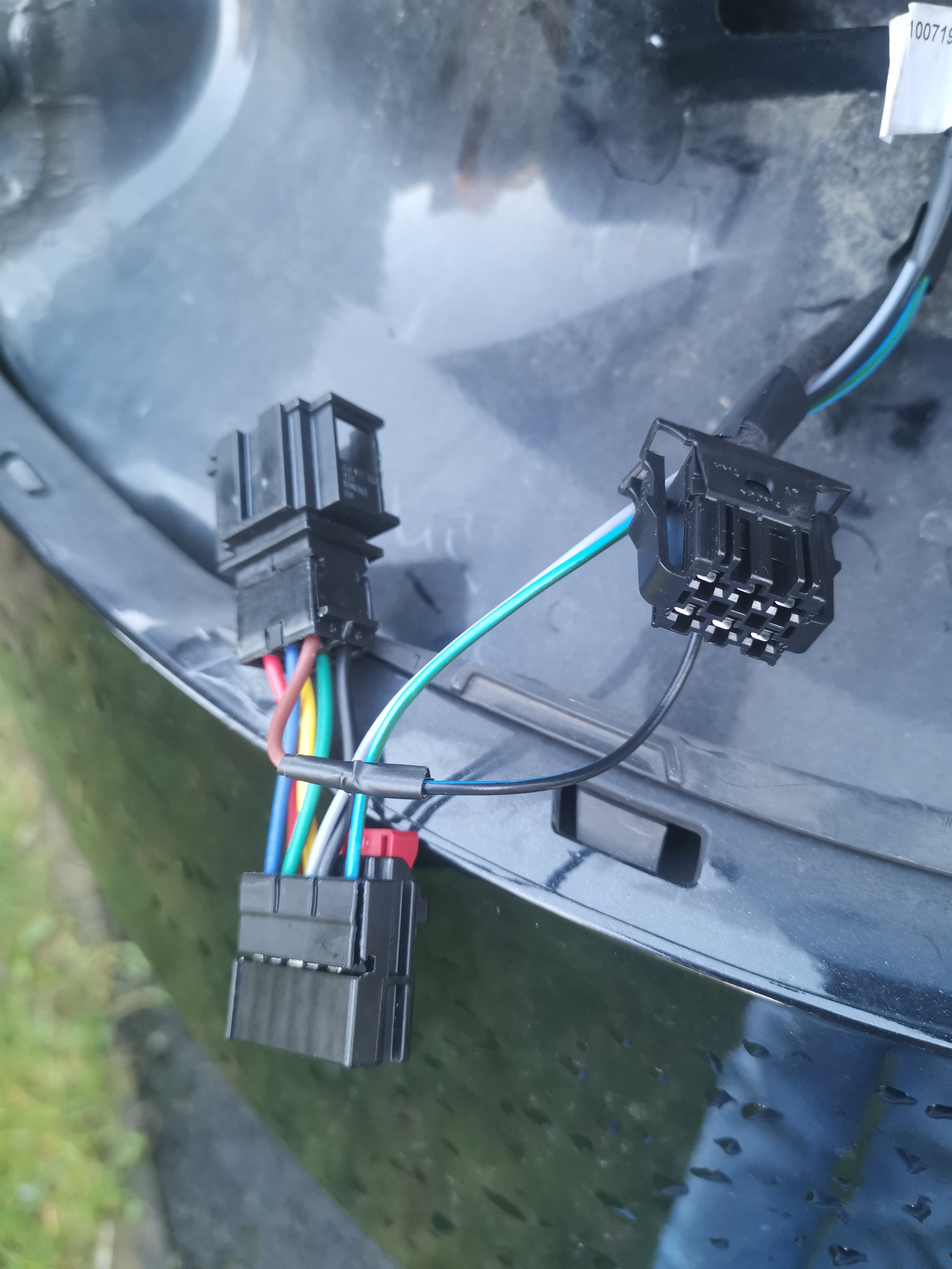

Will have it finished tomorrow, as you can see the original car's harness is left untouched with my homemade wiring harness adapters
