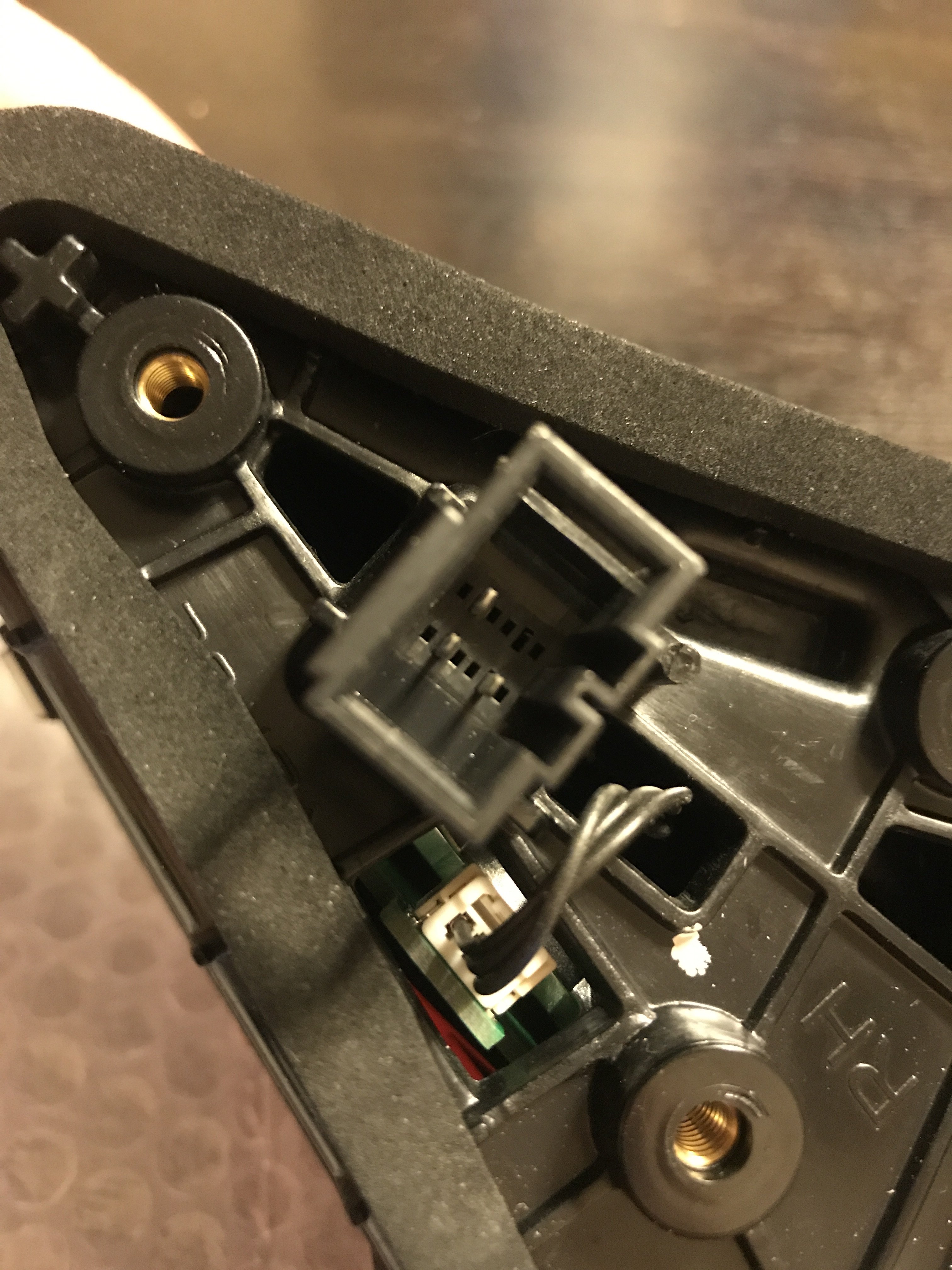

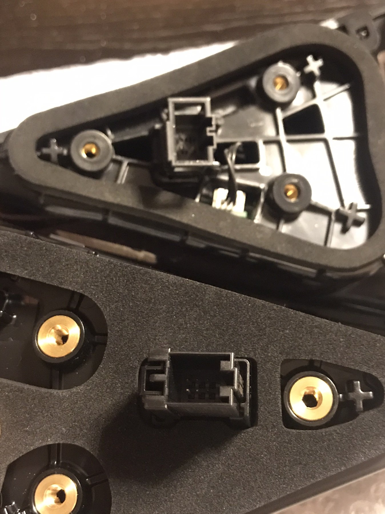

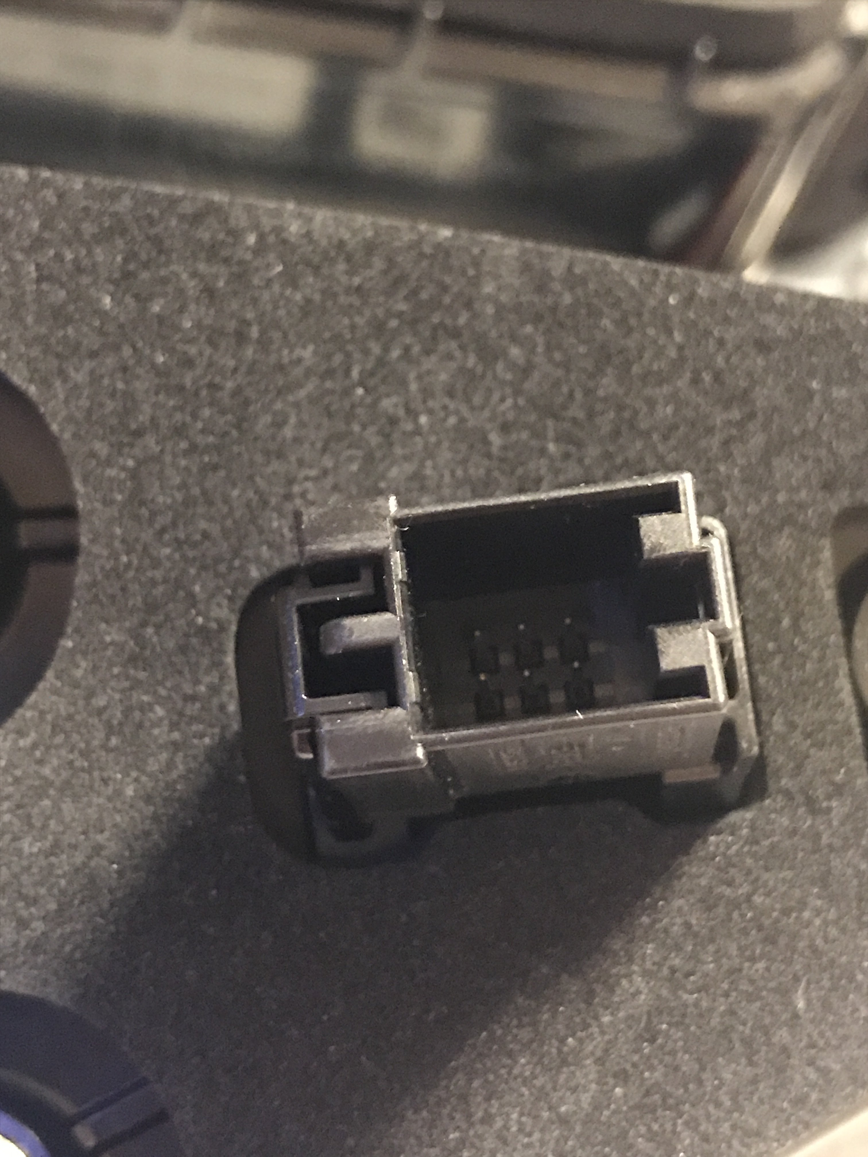

someone is lying seriously,
the sockets are different and cannot be connected to the standard installation without an adapter or replacement

HI
The new one has a 6 pin,the old one with three. Sequential switching on of the turn signal is not possible without additional wiring in the fifth door.
I have all the stops at my disposal, after 18 years of work at Skoda I have access to the wiring diagrams of both models,later today I will have information about the reversing camera whether it is the same for both models

This is another ,new and old
