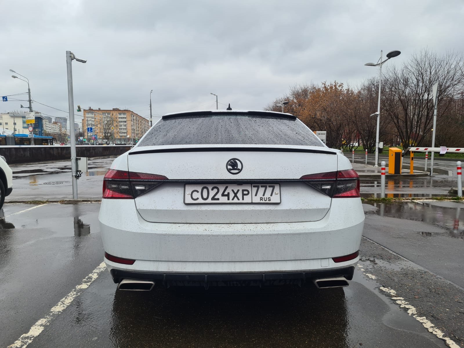

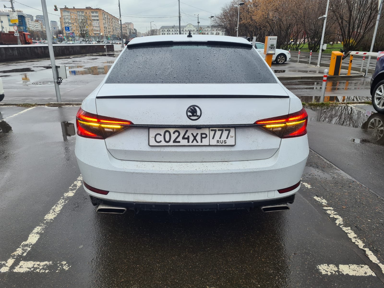

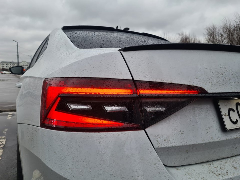

Superb from Russia
Vor 3 Stunden sagte Maksimilli:
Super aus Russland
Is the light animation functional?
So that is dimmed when opening and closing!
15 hours ago, Maksimilli said:
Superb from Russia
So beautiful mate !

Unfortunately, I have no data, the work was done in the service
14 hours ago, Lutz_91 said:
works only when opened
Okay, so it's the same as mine.
So far only works when opening the animation.
