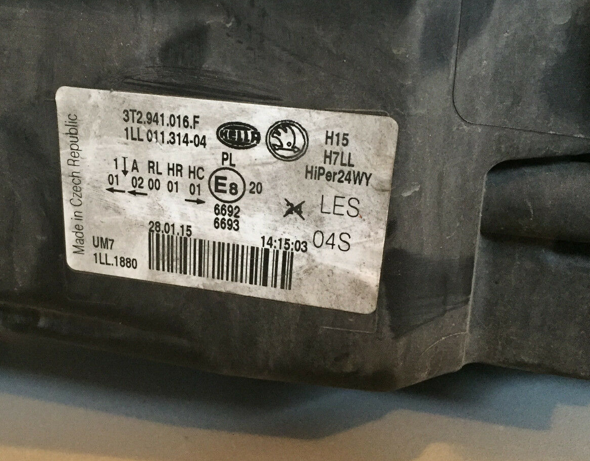

As for the MOT, your headlights have a series of ECE markings one them to show exactly what they've been tested and certified with. Below is an example of a MK2 FL Superb halogen headlight. The markings are A RL HR HC - it's the HR HC that shows this light fitting is only compatible with halogen main/dipped beams. These markings are probably stamped into the plastic body of the headlight and possibly the lens. If these headlights were fitted with a HID or LED dipped/main beam, they are not compatible and it should be an MOT failure as mentioned above.
The key word being 'should' in my experience many (most?) MOT testers are on tight time schedules and if the beam pattern gets a pass from their light tester then they will not search around for the relevant labelling.

5 hours ago, langers2k said:
I do a fare amount of driving and plenty in the dark at this time of year so the fewer cars with non-compliant headlights the better. I have no issue with people wanting better/brighter lighting but especially with headlights, it should be done properly. At the very least with a basic understanding of laws/regulations and the differences/challenges between lighting technologies.
While both halogen and HID options use projectors on a MK2 Superb, this does not mean the light fittings are the same...
There is a misconception that projector headlights are perfectly fine for HID/LED drop in kits because the cutoff is good. Despite this, there will be changes in the light pattern under the cutoff. When designed for HID, the projector is tuned to move the extra light to where it's most useful rather than just making everything brighter. The motors used to move the projector are also different, halogen versions only move vertically and have no feedback to confirm the projector position. HID versions have two motors to move vertically and horizontally, both have feedback to allow the AFS/headlight controller to make constant adjustments.
