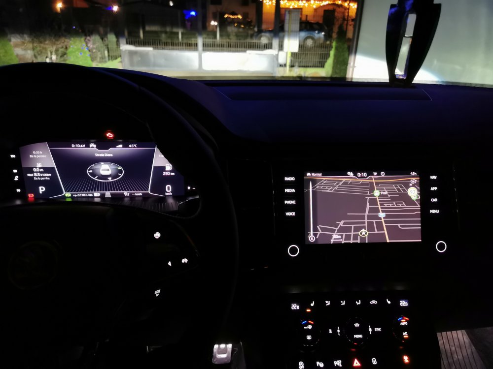

@Scot5 I really don't know what your problem is ,but you should respect more the other's around you.
Furthermore as  a MJ21 Kodiaq MIB 3 Amundsen owner i know what I am talking about.
picture 1 is for Map showing on Amundsen Screen and just compass on the VC

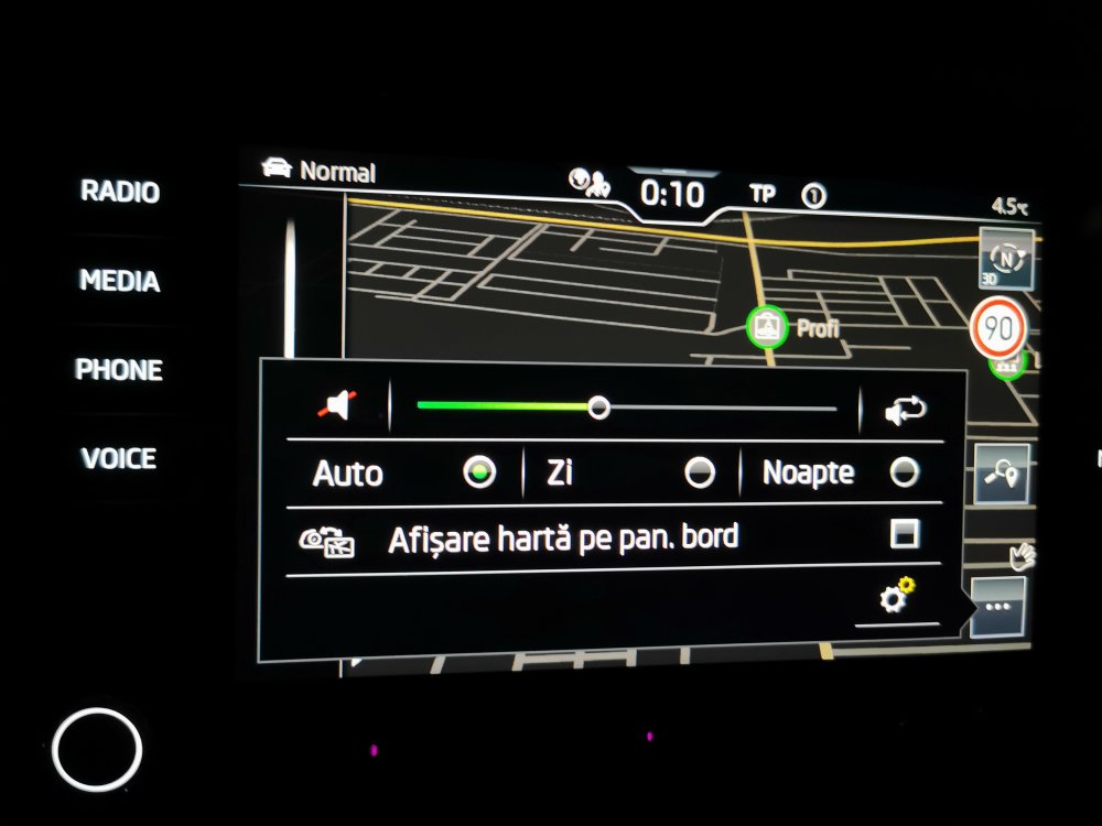

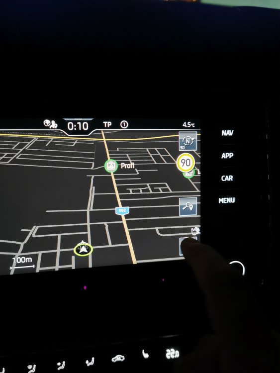

Picture 2 is when you go with your hand towords the screen of the Amundsen it will show you a "..." which when you touch will lead you to the menu in picture 3
Picture 3 is the menu explained before,also :"Afisare harta pe pan. bord"= " Showing of map on the virtual cockpit"

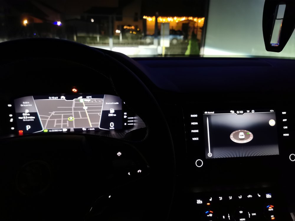

Picture 4 is the Map showing on the VC and compass on the Amundsen Screen.
Again as far as I know you with the Columbus will not have this option as the Columbus can show it's native map on the VC and the screen on the same time.
Do you need any other info ?
