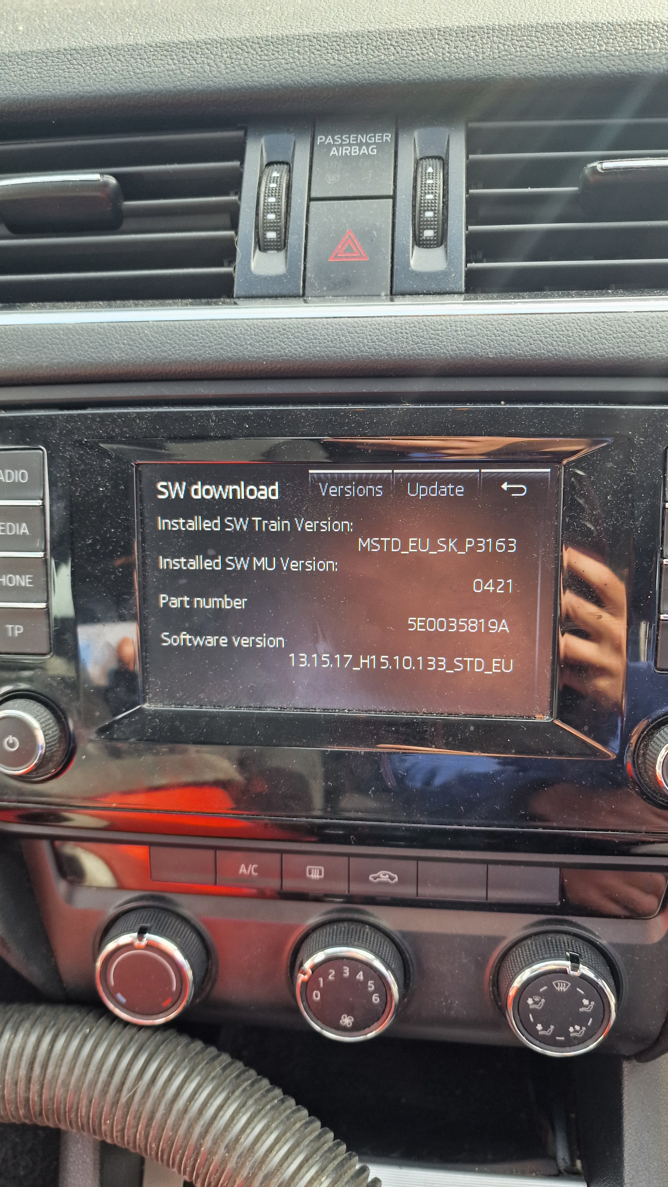

Good day, are there any firmware updates for mine? I did the maps update myself after this photo was taken.
Check your PMs for download link

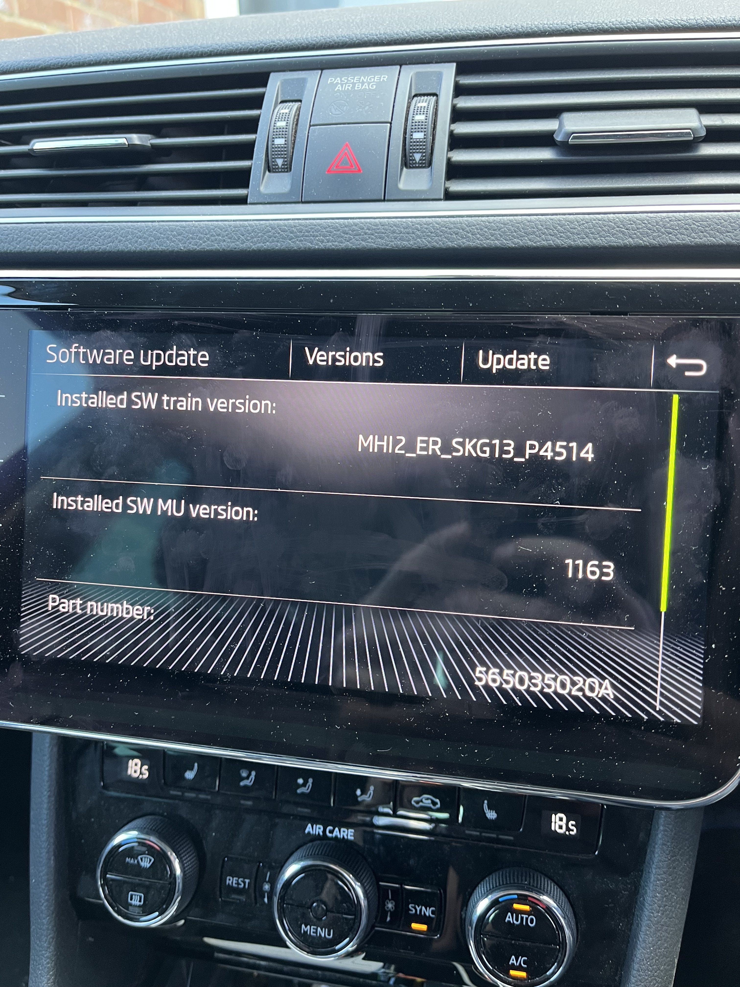

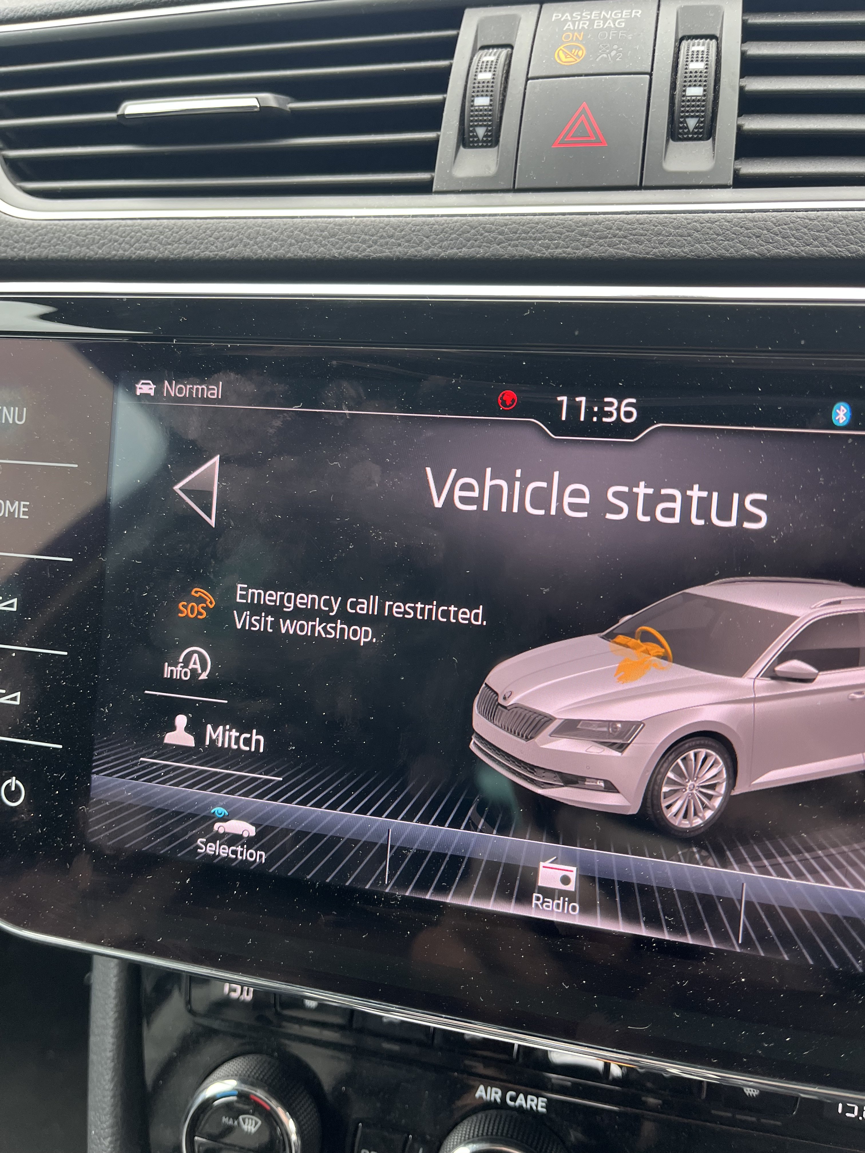

Hi all,
My Škoda Superb 2017, started having “Emergency call restricted, visit Workshop” pop up. SOS light is always green and calls through to emergency without issue.
There doesn’t seem to be any apparent fault yet this warning comes up on every start.
Hoping a firmware update will fix it, I am on MHI2_ER_SKG13_P4514.
Are there any updates?

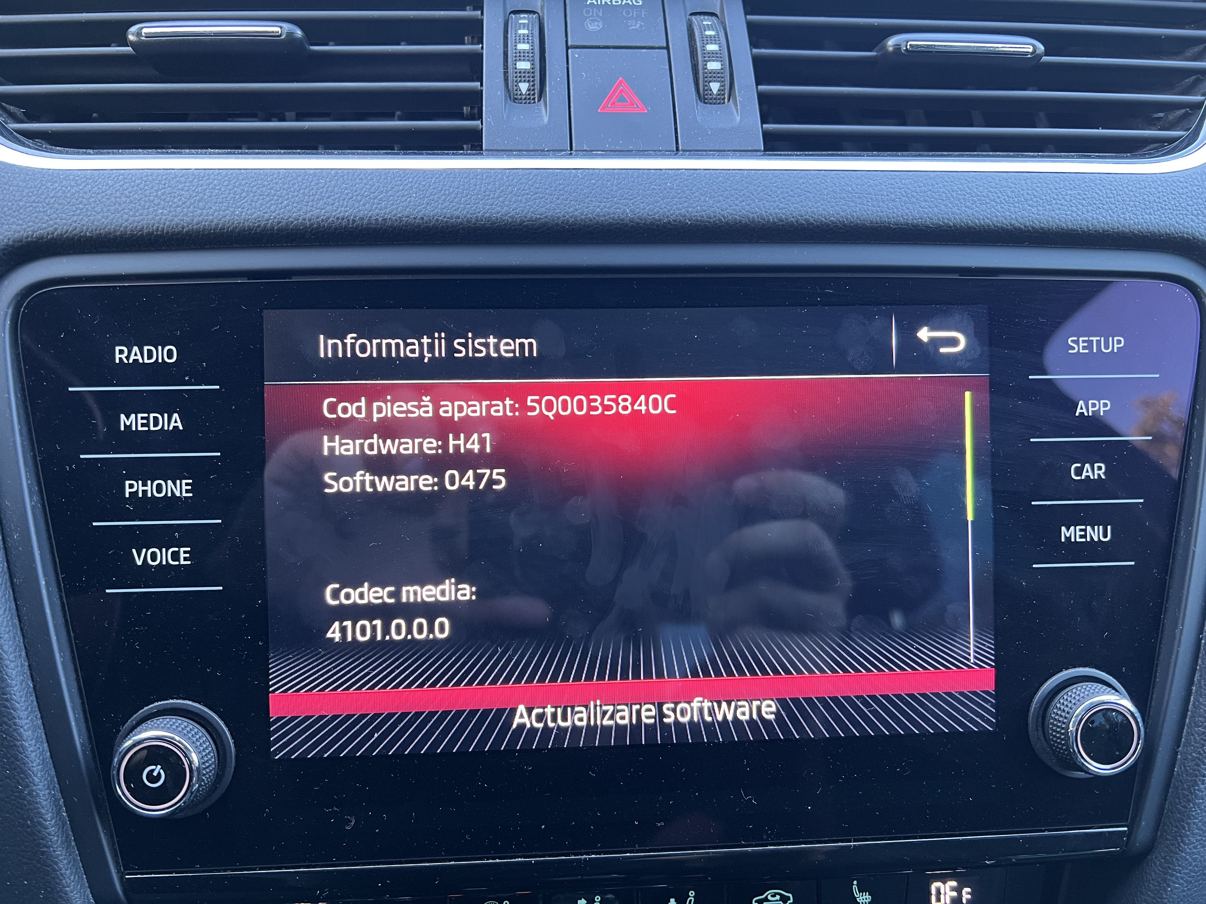

Hi @pab567,
If you have date firmware for me let me know, and do I also need to update RadioStationDataBase?
If there are more updates to check or to do let me know.
Thanks a lot

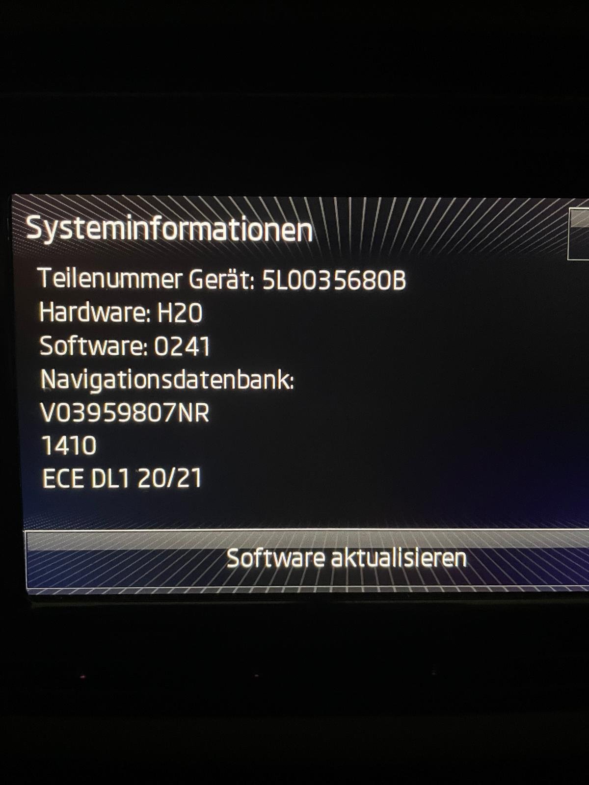

Hi folks, wondering if there is an update for my rig.
Thanks for any info.

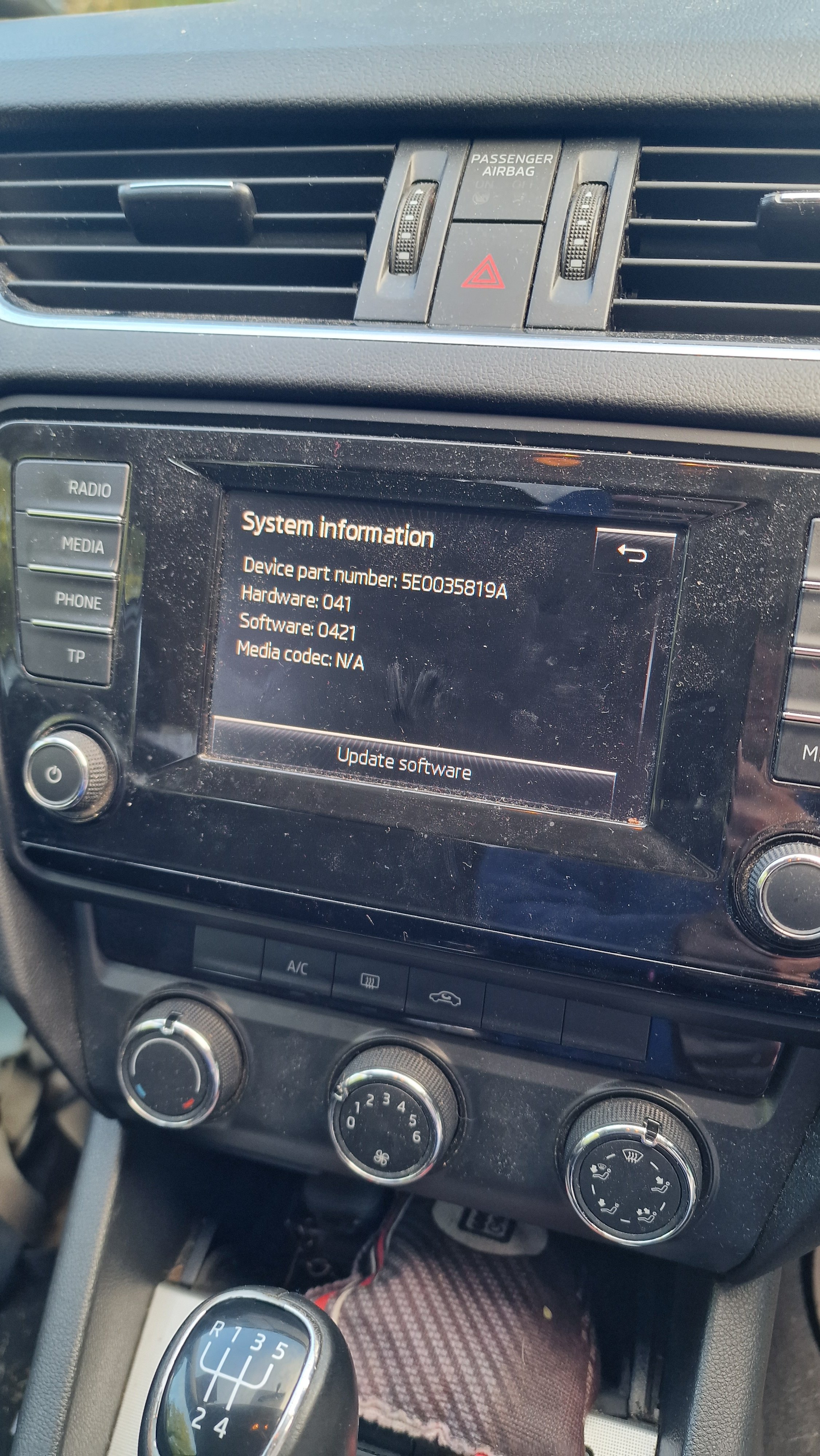

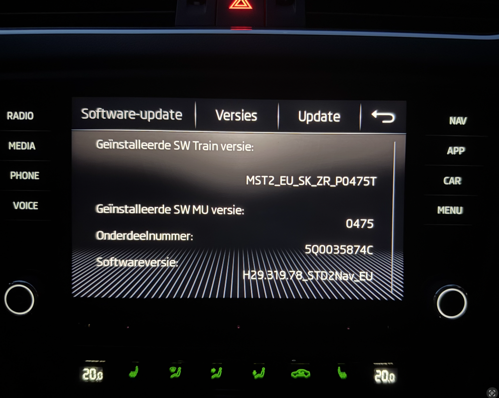

Hi,
if possible, could you please provide me the link (instructions) for my Skoda Octavia III from 2018?
Current system version is shown in the picture.
Thank you!

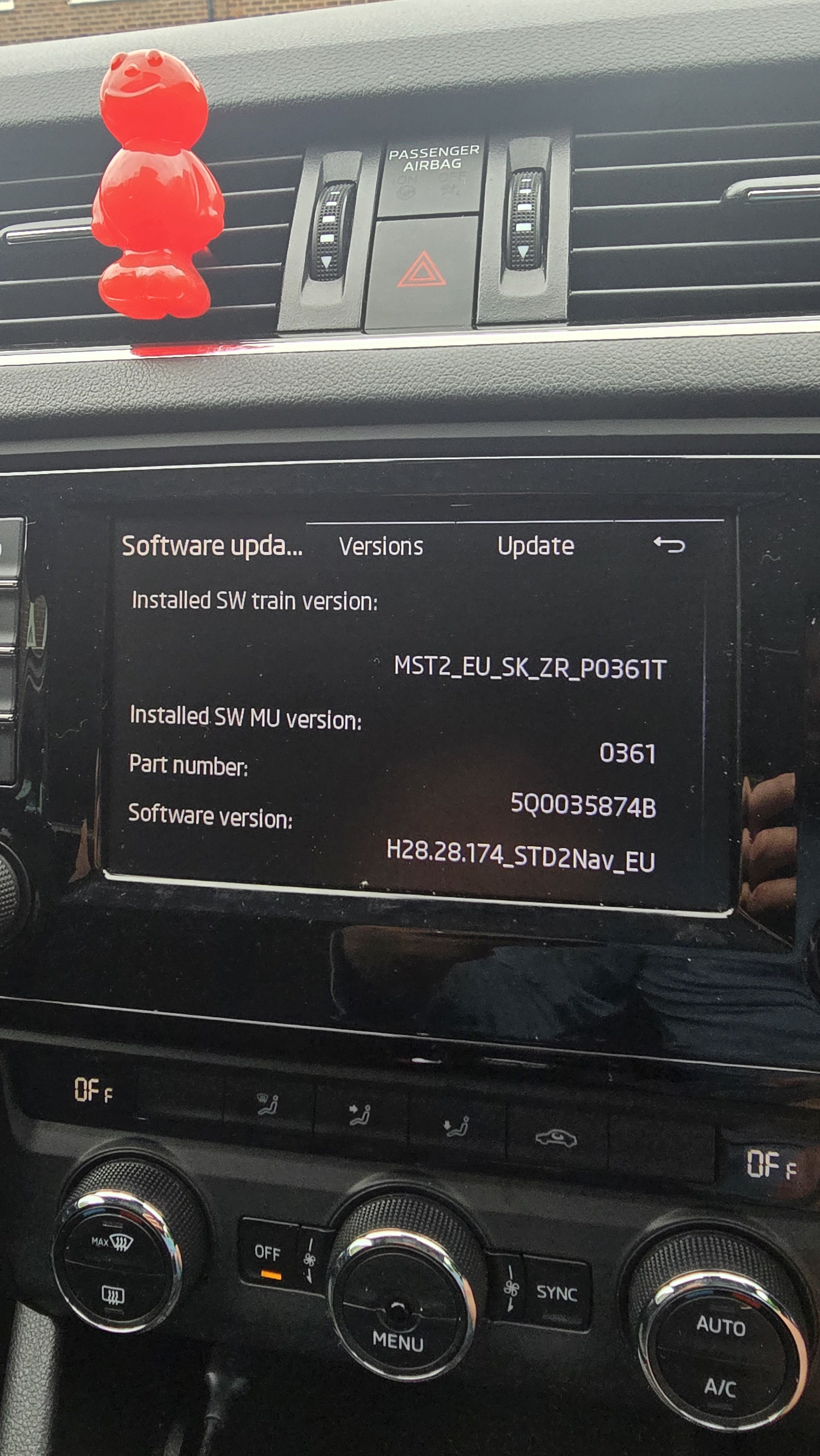

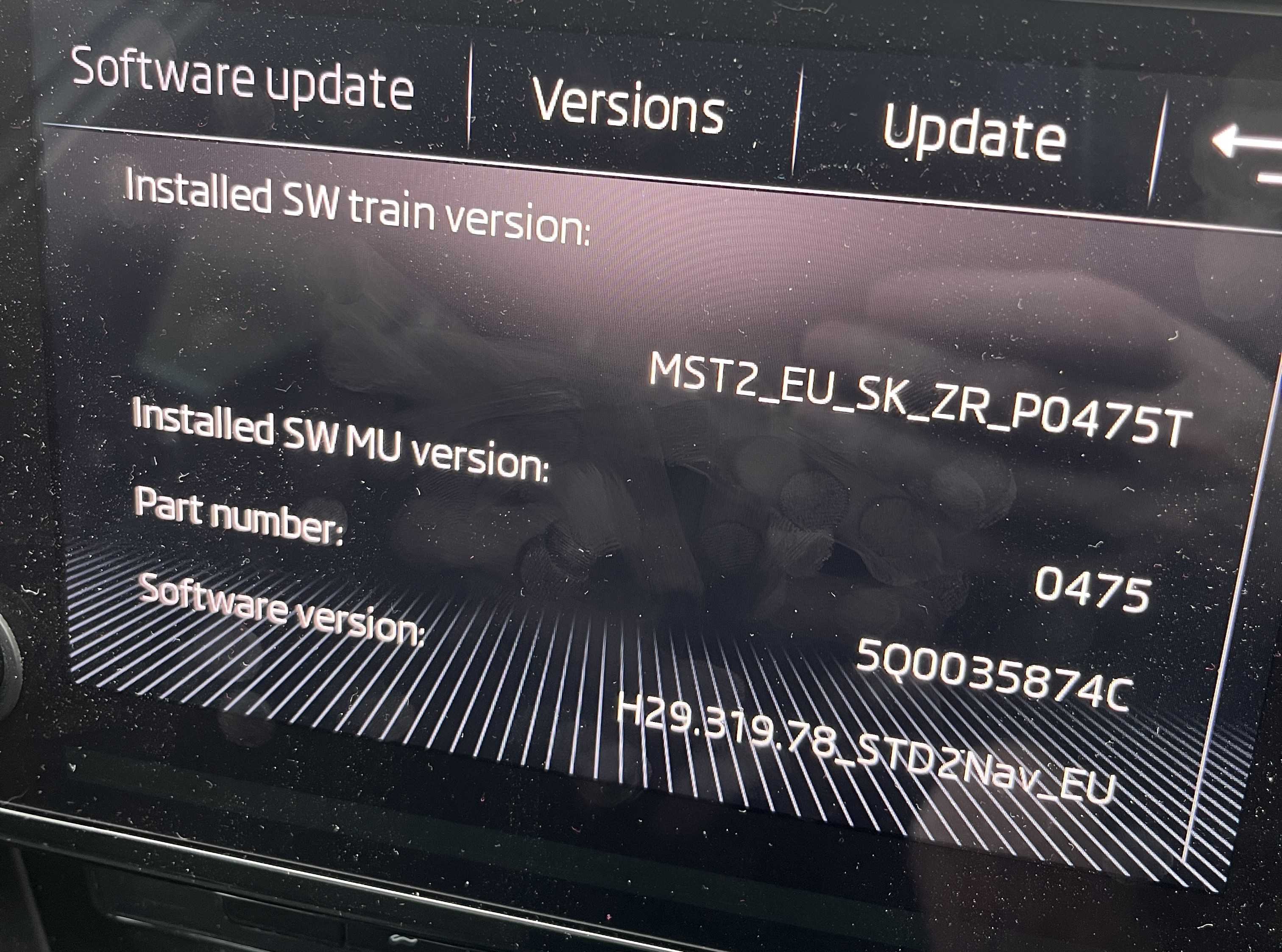

@pab567
Hey Pab, sorry to bother but would you have an update file for my headunit at all? The details hould be in the photos down below and any help would be appreciated

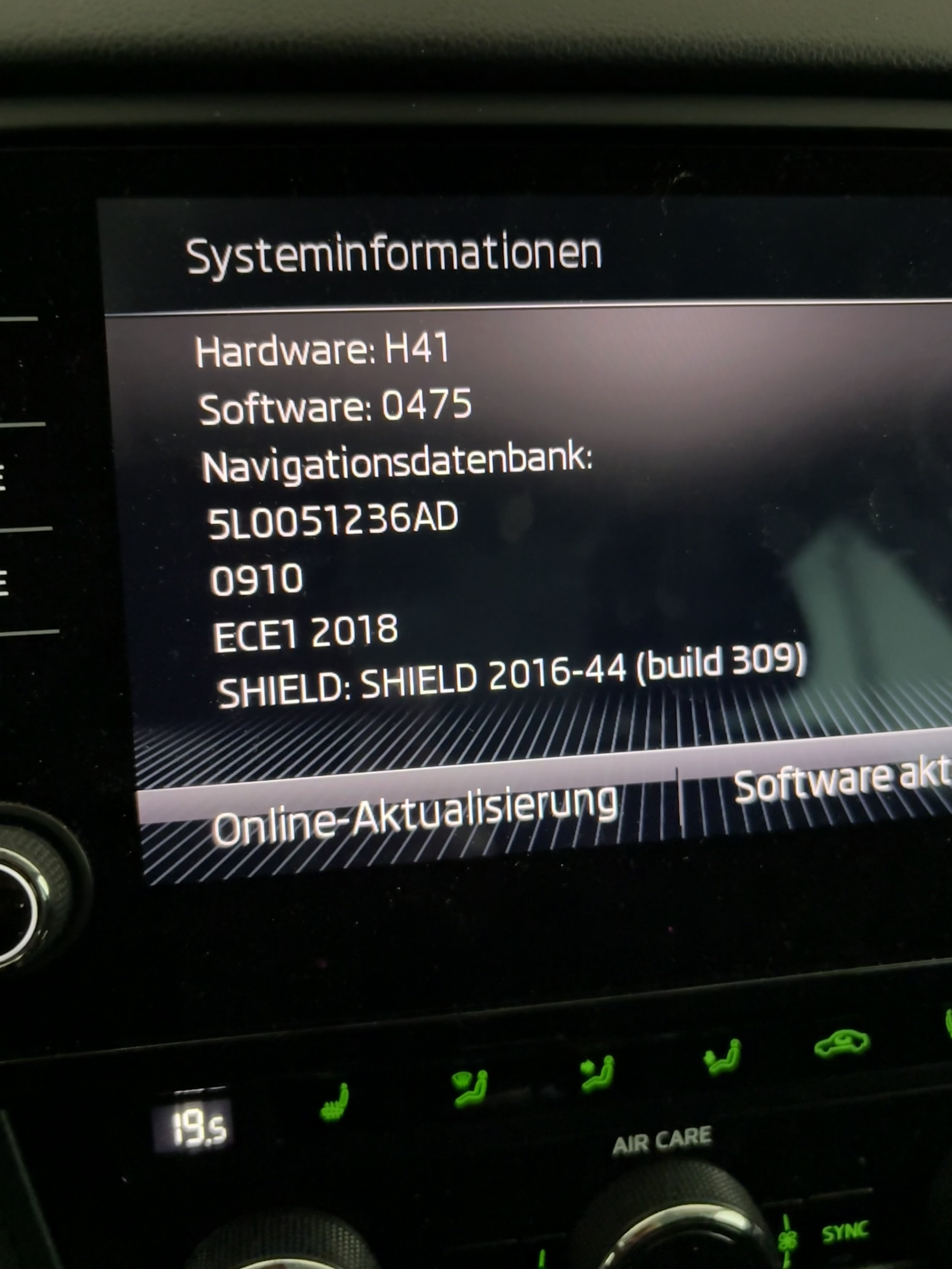

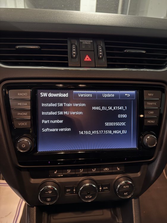

Hello,
I have this navigation with the sw displayed on it, can i update it to a recent one?
@pab567 can you help me please with my above navigation? Thanks!
