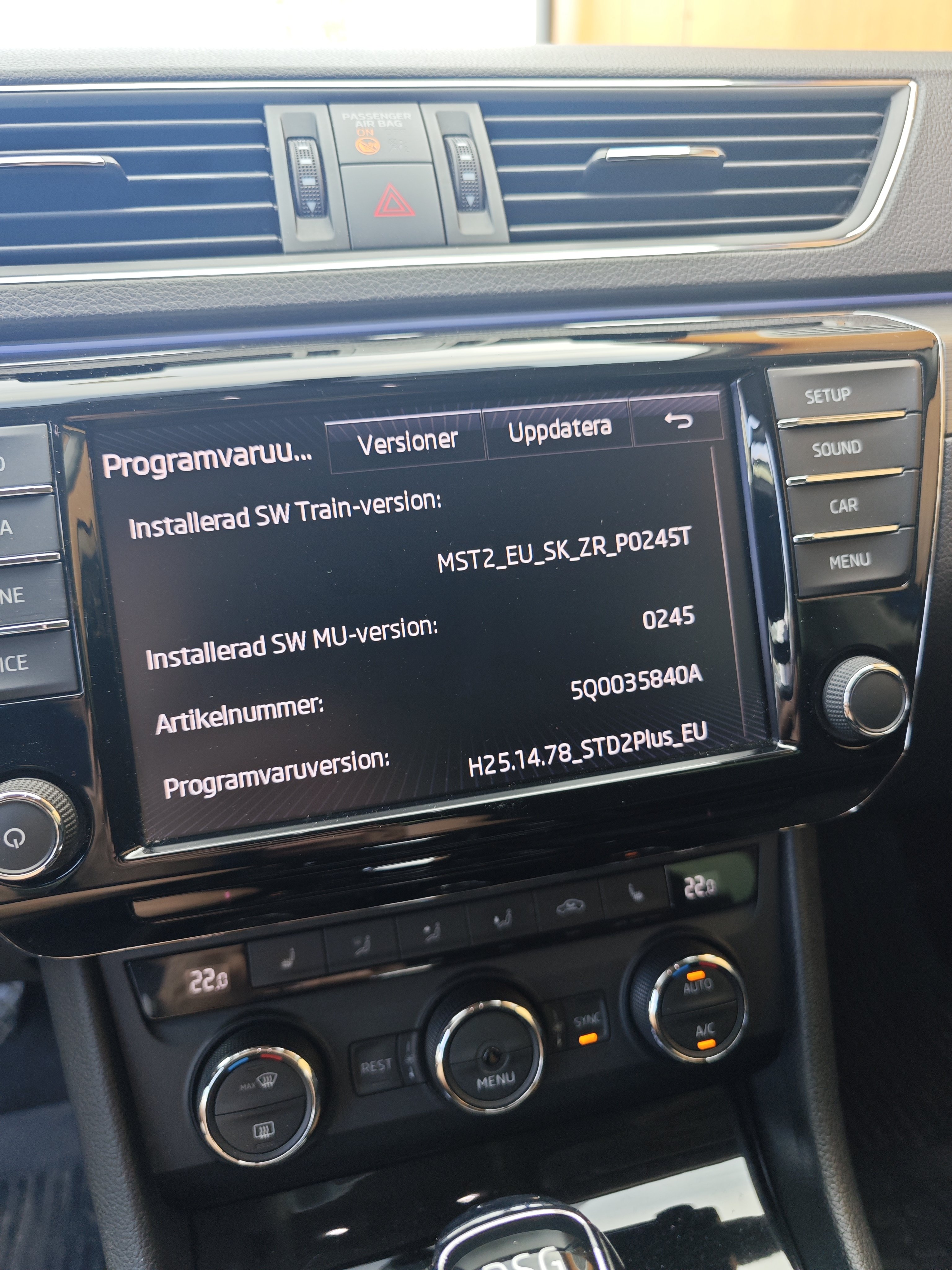

Hi there!
I'd love some advice on upgrading my firmware please... I am currently running MST2_EU_SK_ZR_PO253ST. My bluetooth connection drops out regularly, or the audio goes garbled, and it's very annoying.
A bit of internetting has me believing I could upgrade to MST2_EU_SK_ZR_P0480T. I see that a I'm far from alone now having signed up here!
I'd love some advice on if this would be a helpful upgrade, and if so where I might get it please?

@leeroykeys MIB STD2 TOOLBOX is your friend, google for it :)

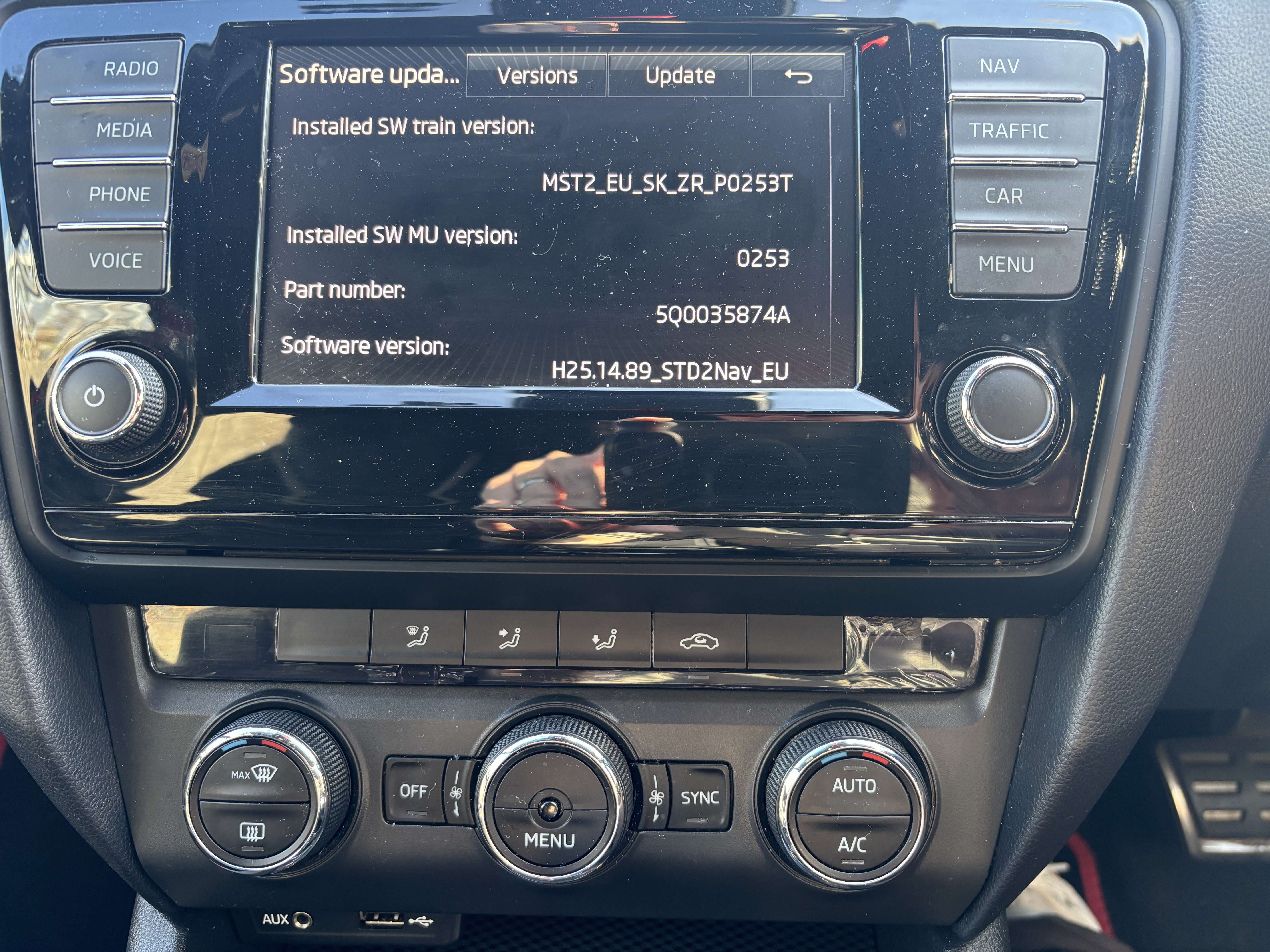

Hi im looking for the mst2_eu_sk_zr_p0253t uppdate if any one have it on hand. The webpage where it was downloadable from has been down for a long time now 🙁
Best regards// Sebastian

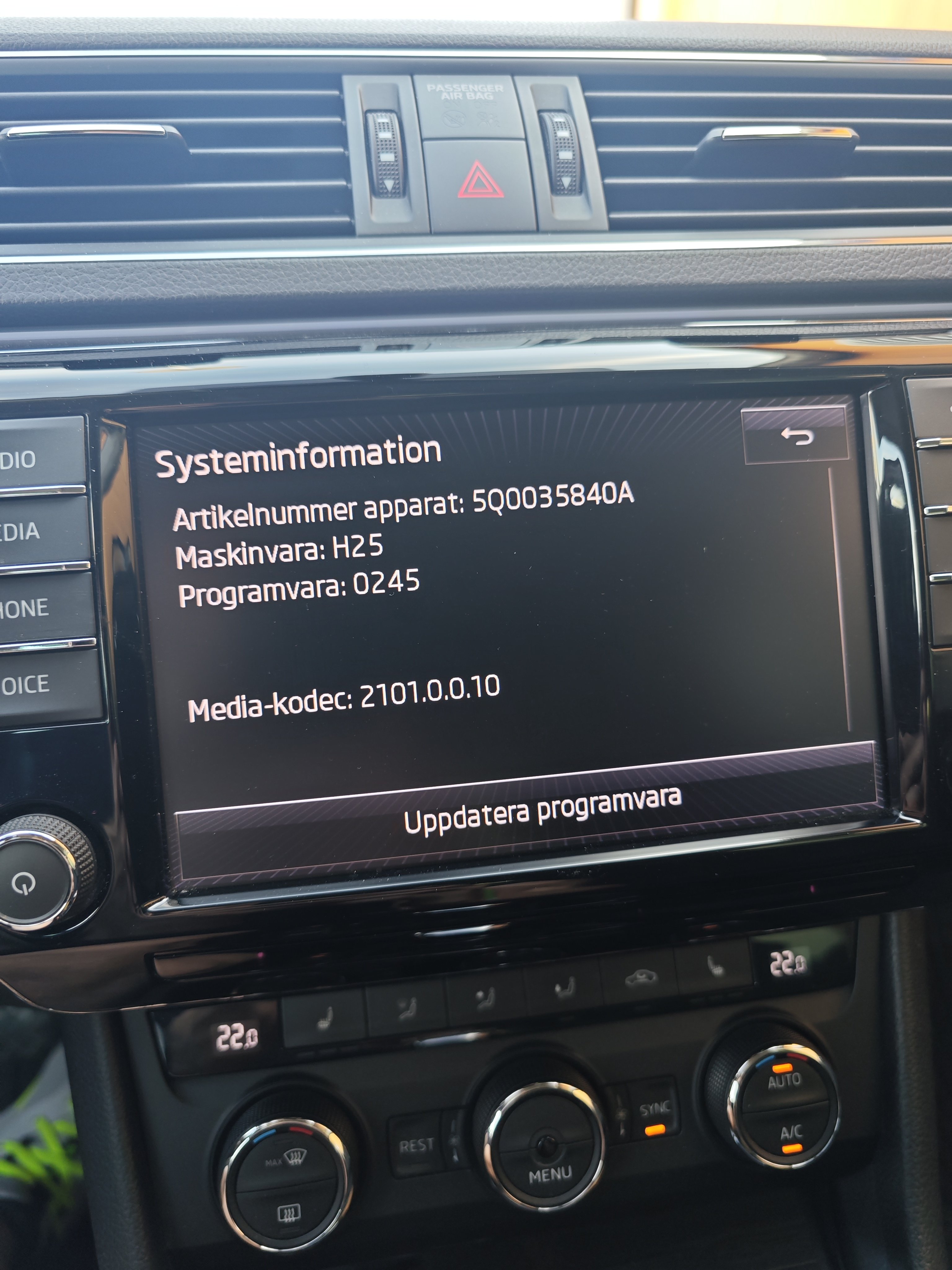

Hi i have a Skoda superb 2016 mib-helper says the latest official uppdate for my car is 0453 and possible uppdate is MST2_EU_SK_ZR_P0480T
Do you know if 0480 will work on my car also? I cant pm you yet since i am new member.

@Reqit It supports version 0480, but without knowledge and necessary things you can't do it. The maximum you can update it to version 0253.
