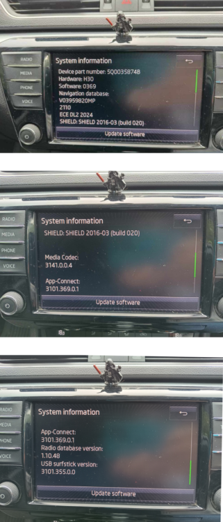

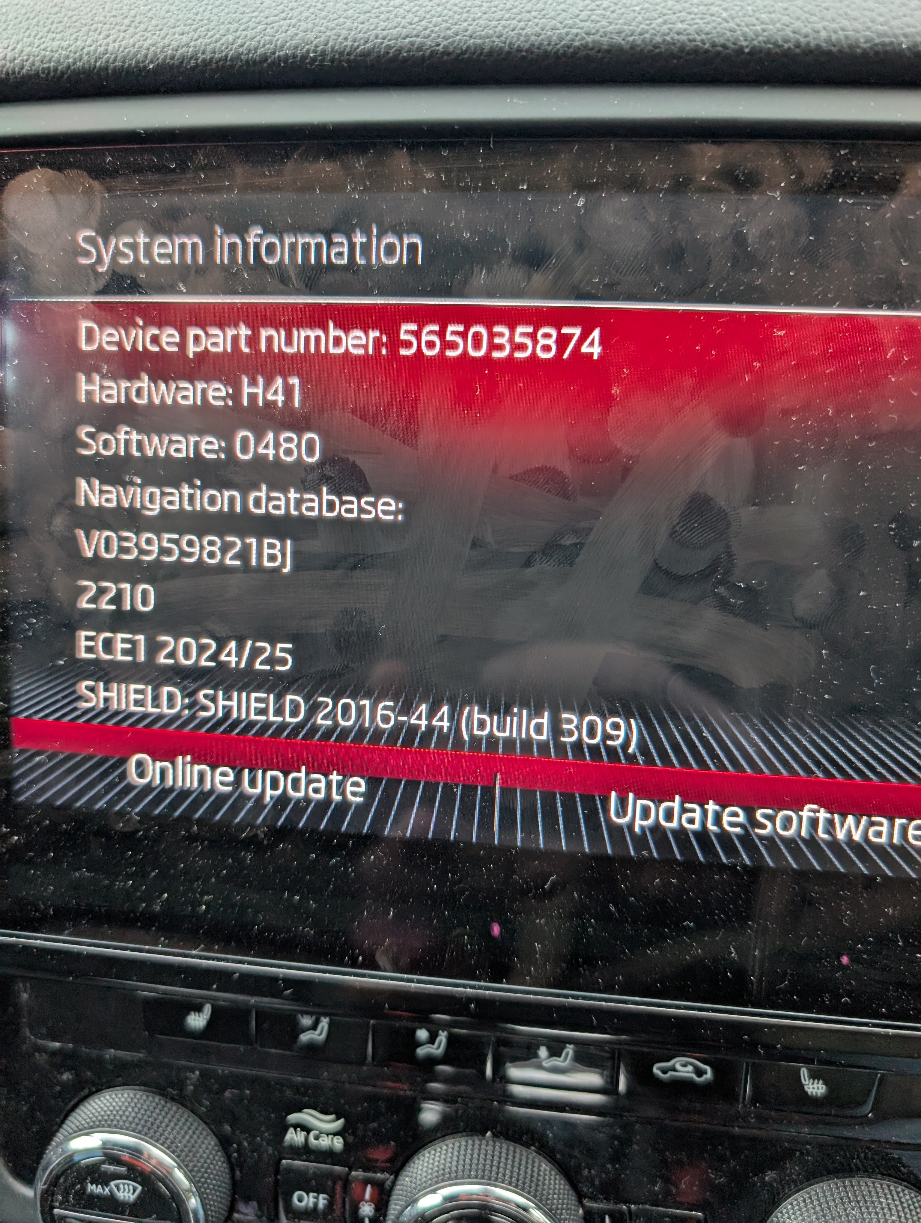

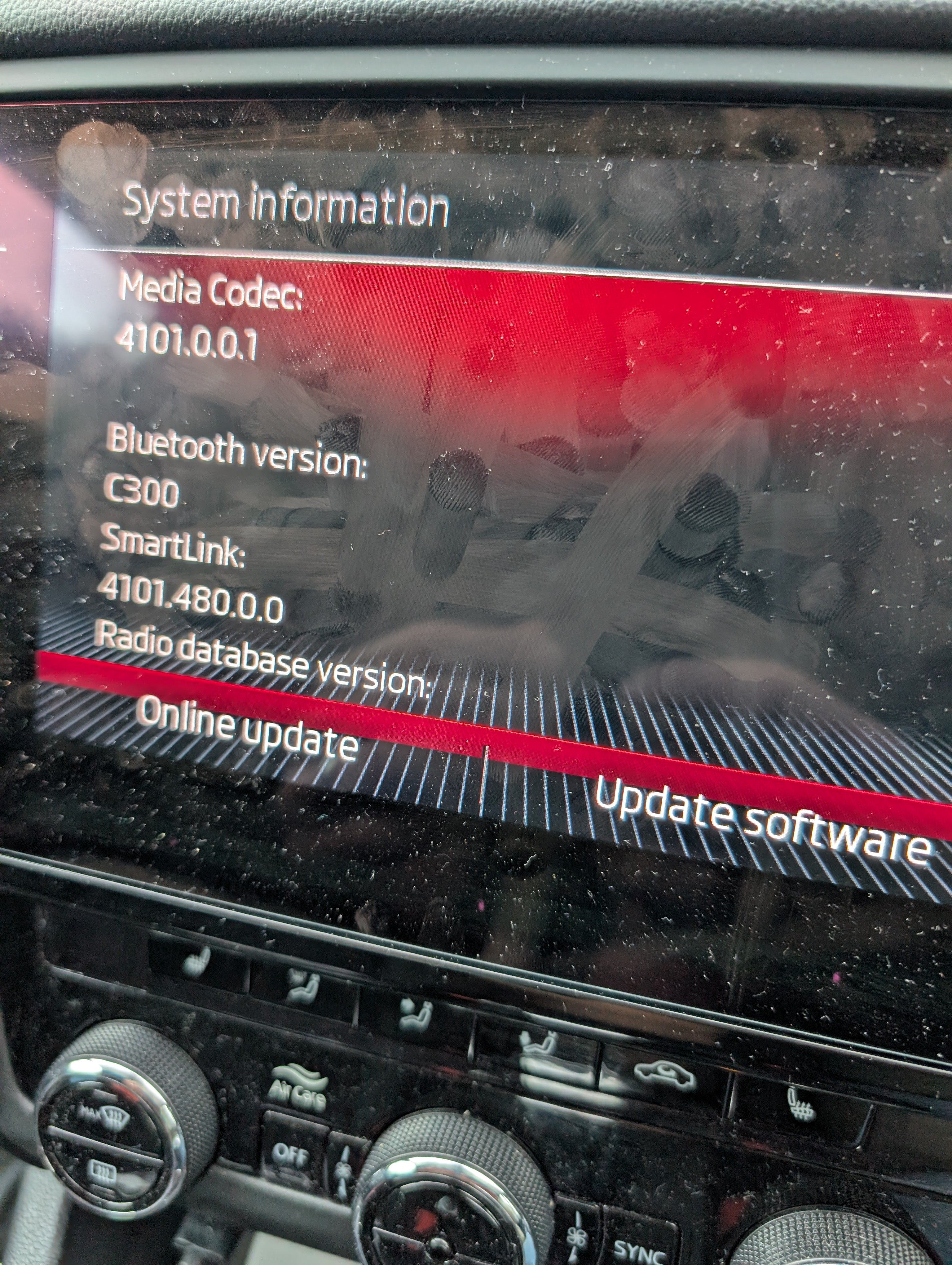

Hi @pab567, I tried to message you but not sure my messaging is working as I can't create one for some reason. I had previously updated my firmware with your help but wondering if this is now still up to date? Reason I ask is I have installed a couple of non standard mods (rear camera which didn't work and activated carplay) and now have an intermittent fault with cruise control sometimes not working so was looking to go back to stock fw. If no newer version exists is there any way to force an update with the same version as the car won't do it via the normal process as it's the same fw. Here is what I have

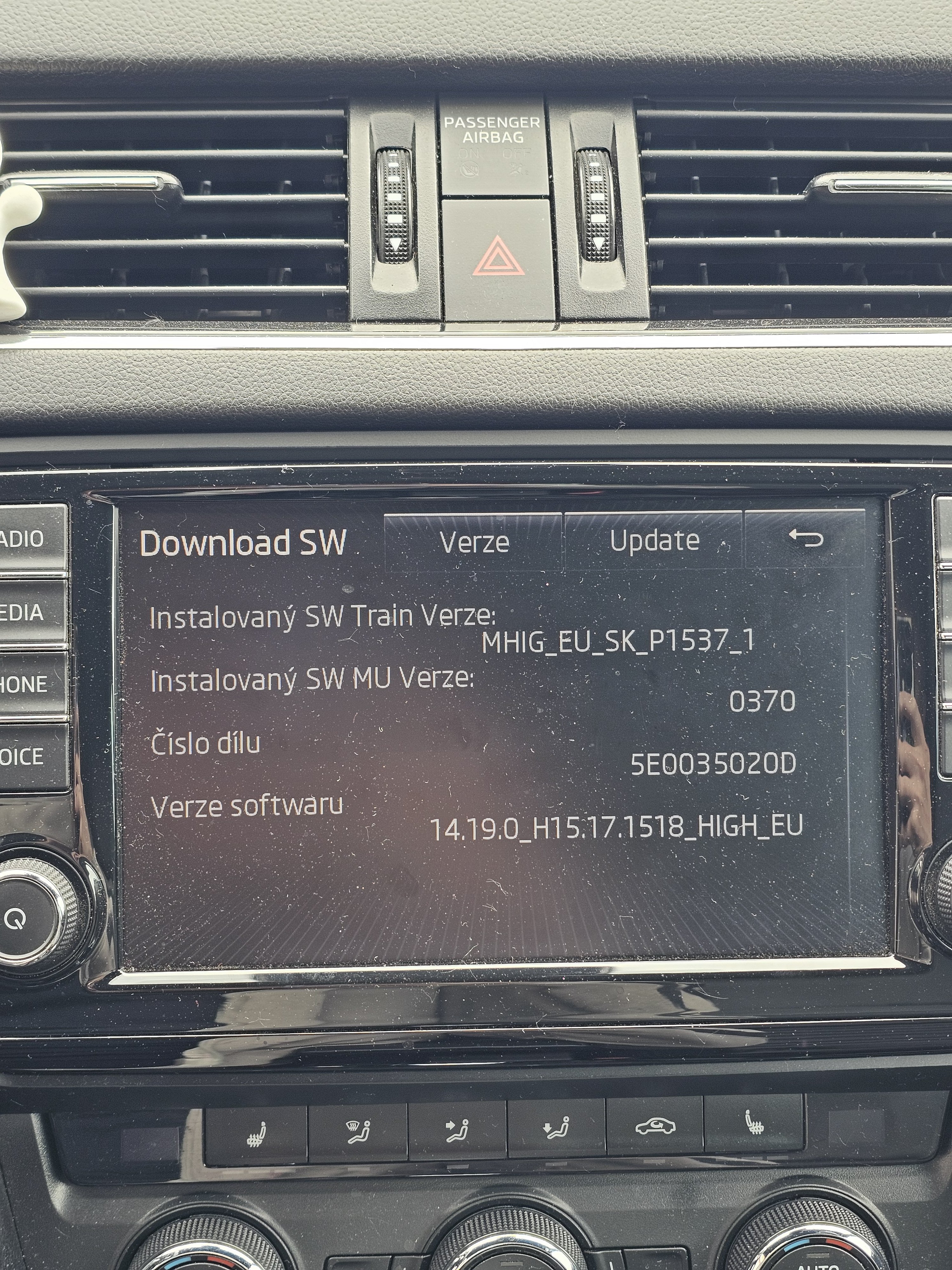

Hi @pab567 can you please let me know if mine needs any updates or if it's all up to date?
Skoda Superb 1.6 SE Tech 2017
Thankyou

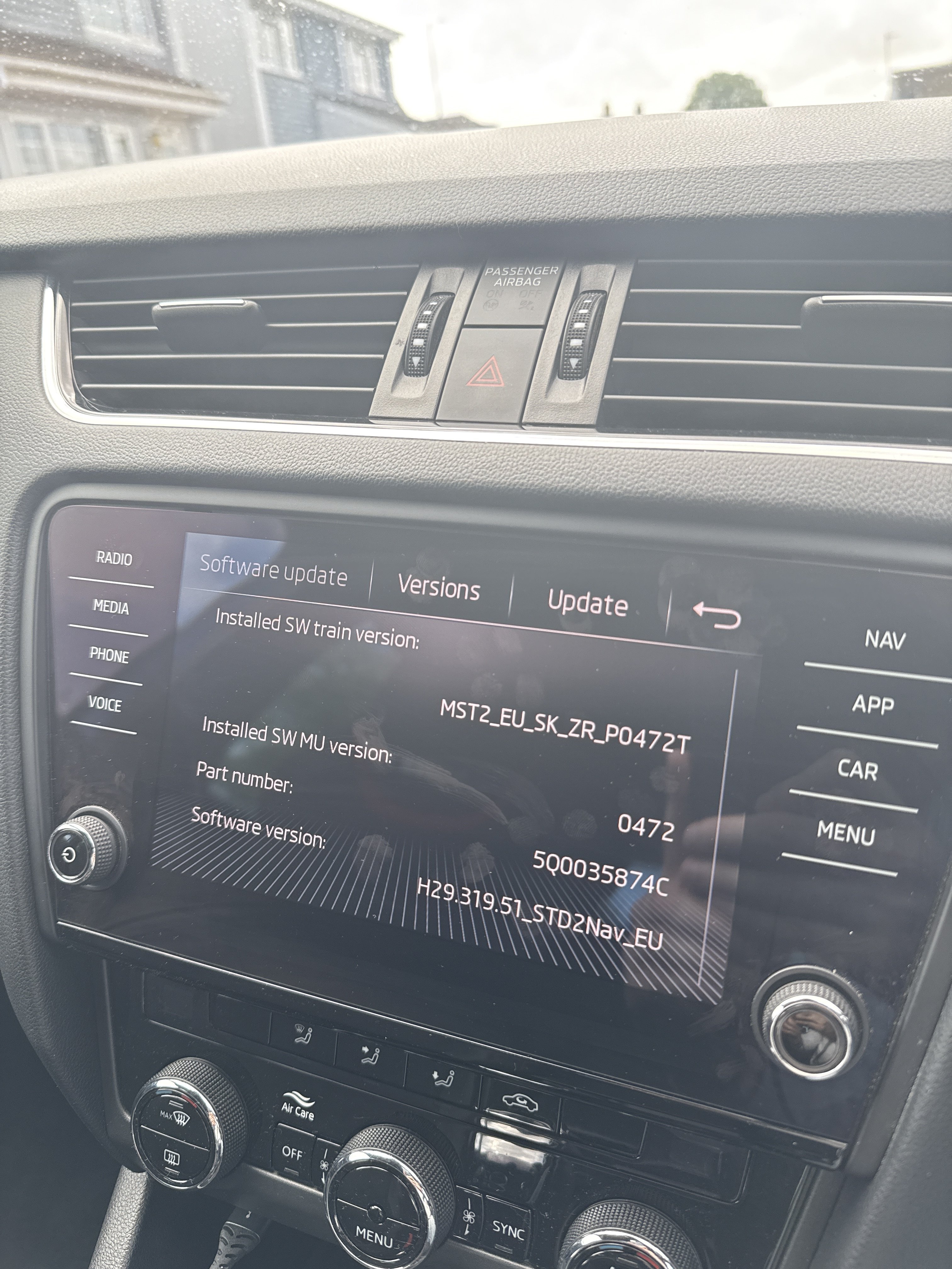

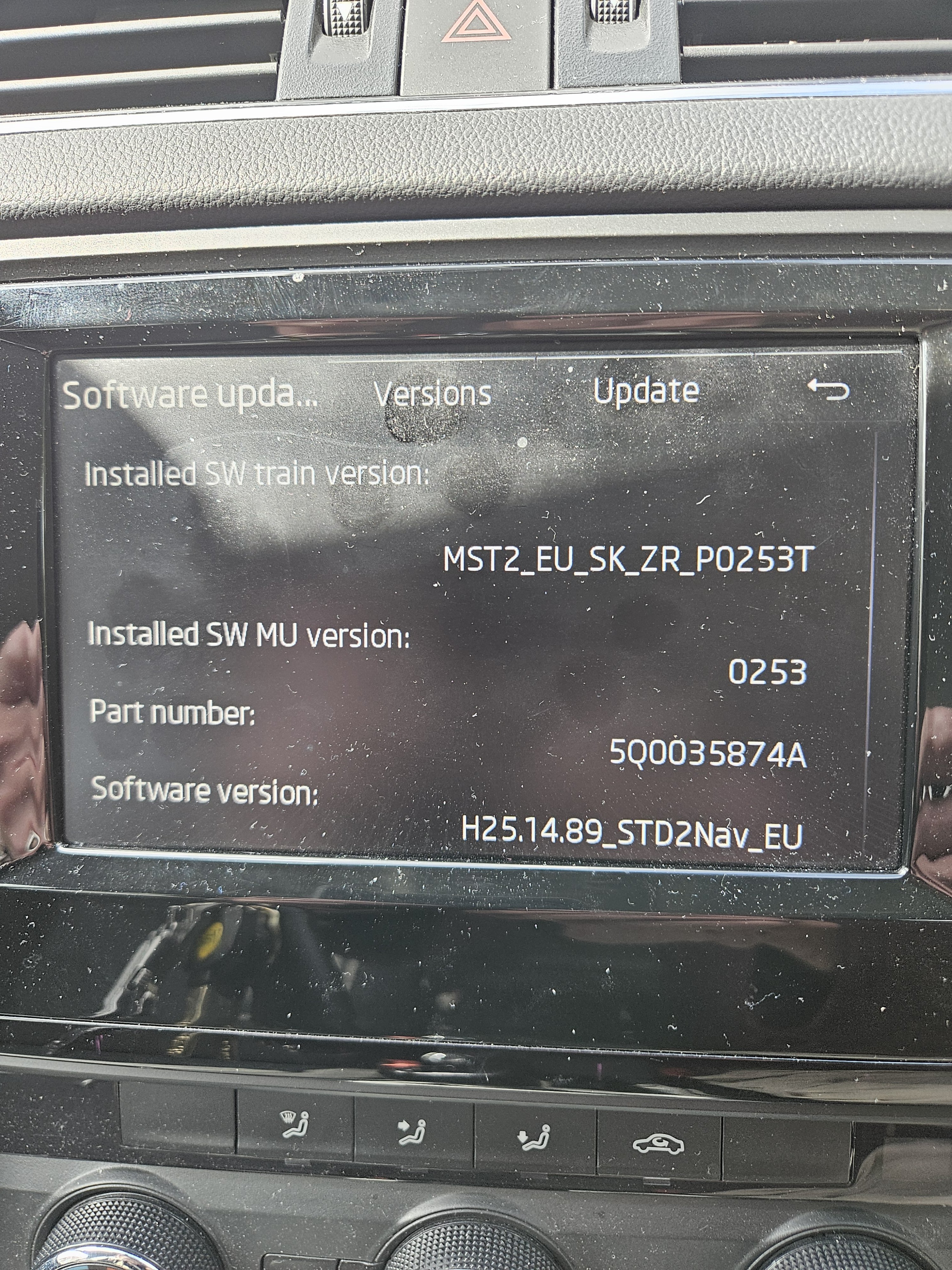

Hey @pab567 good to see this thread is still alive and thanks for helping us all out... Hopefully you can help with my system...
Any updates for the below available, Octavia VRS?
Thanks 👍🏻
And this is the most recent version for your unit. I don't expect it is the reason of your problems unless the mods you made are somehow buggy.
Thankyou
No, you have the most recent firmware for your unit.
Thanks 👍🏻
Nope, you have the most recent version for your unit.

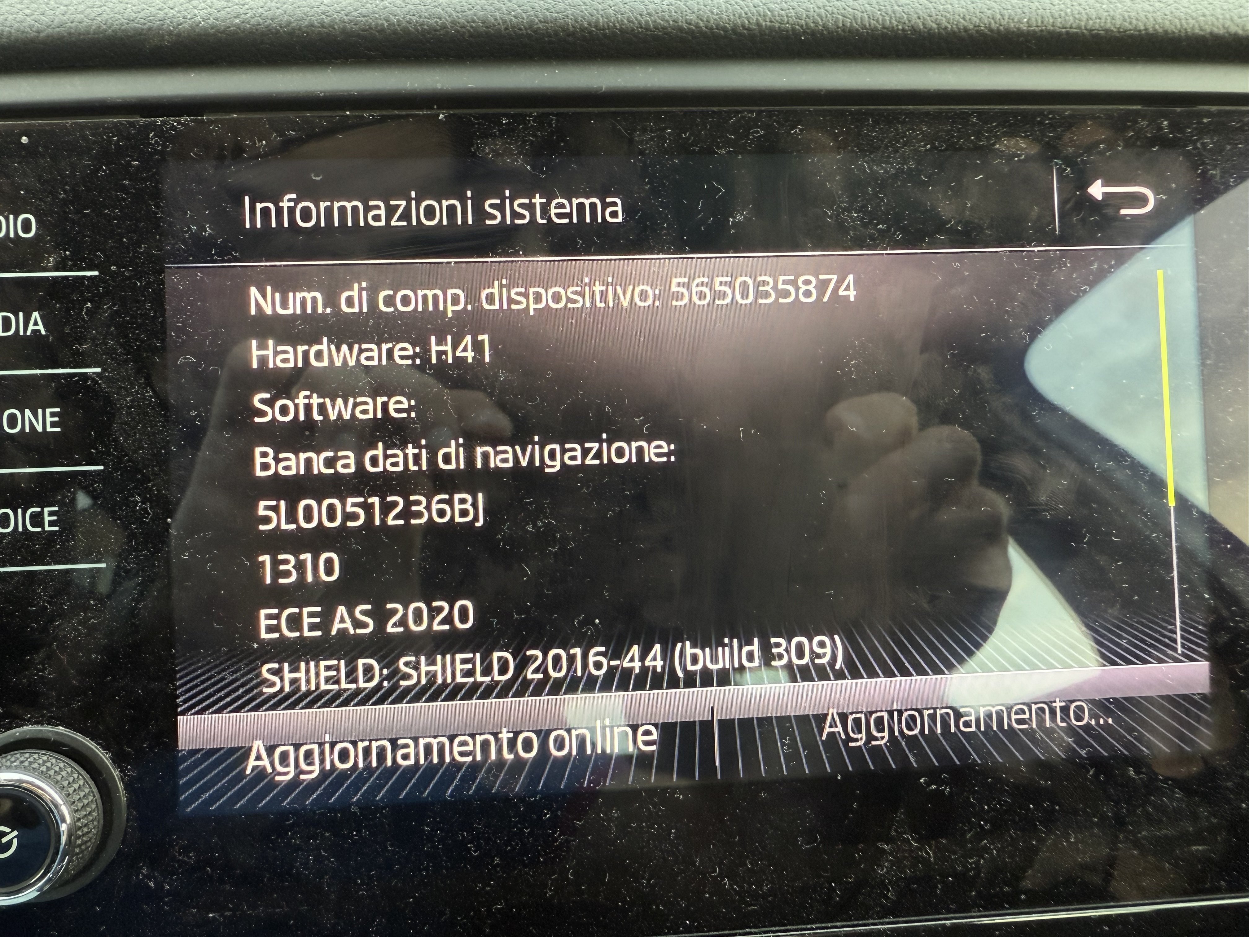

Hi all again
I have this infotainment system. It happens that it reboots and the screen is hot. Is there an update i can make.
And i used a phone app and a plug to Connect the car to the phone, but it will be discontinued. Is there a Skoda app on Apple car play but if i click it it crashes. Is there someting new?

Thanks. I am just assuming it is as its intermittent. Could be something else I guess but nothing showing up on an obd11 scan.
On a separate point, can I replace my screen with the larger one 5E0919605N

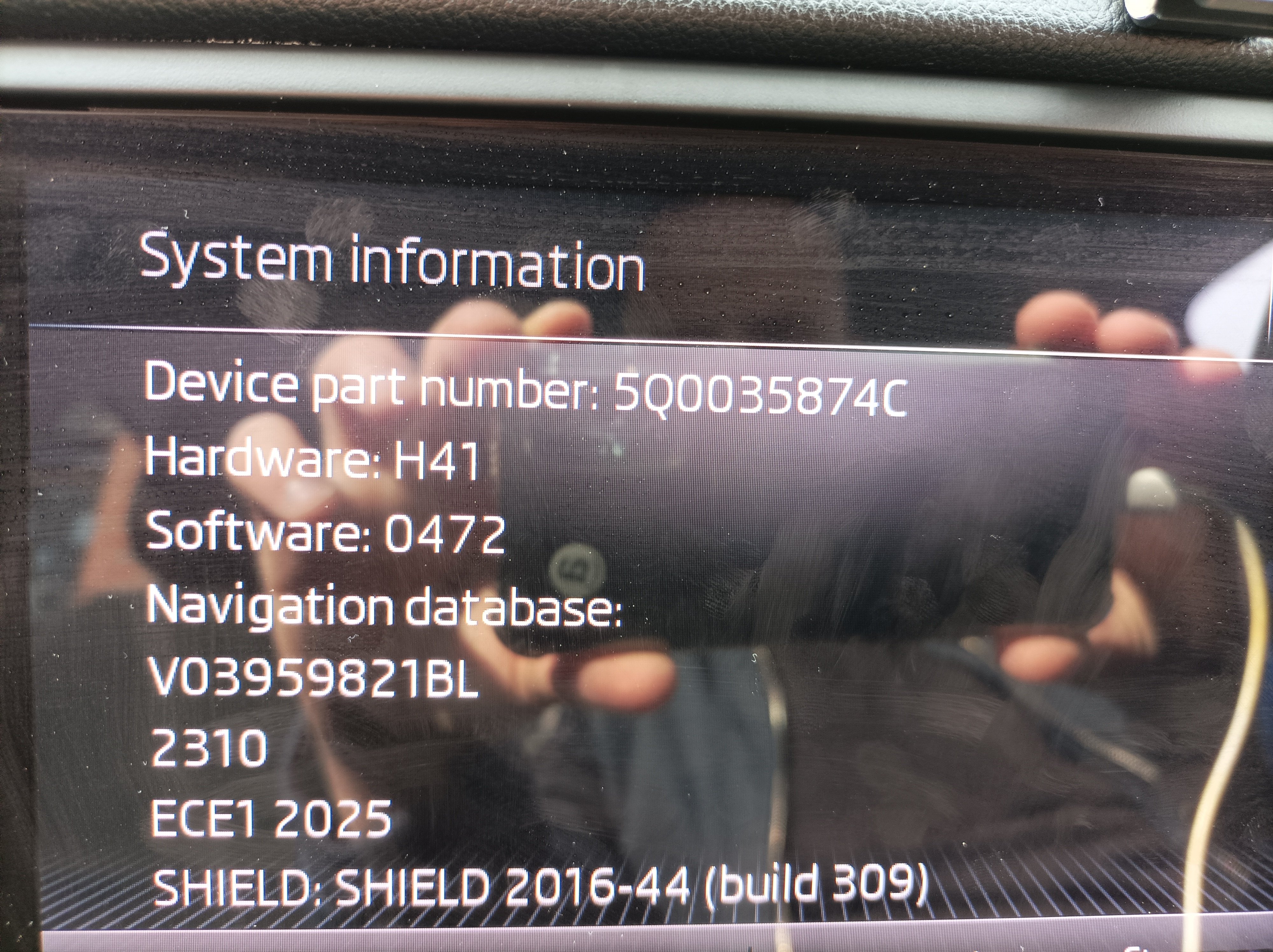

Hi @pab567, I have a Škoda Octavia with device part number 5Q0035874C, hardware H41, and software version 0472. Could you please provide the firmware update to version 0480 or the newest one? IMG_20250604_173908.jpg

Hi all again
Pla wait until "Software" filed contains data and post again
Yes, you can but APP button will not work

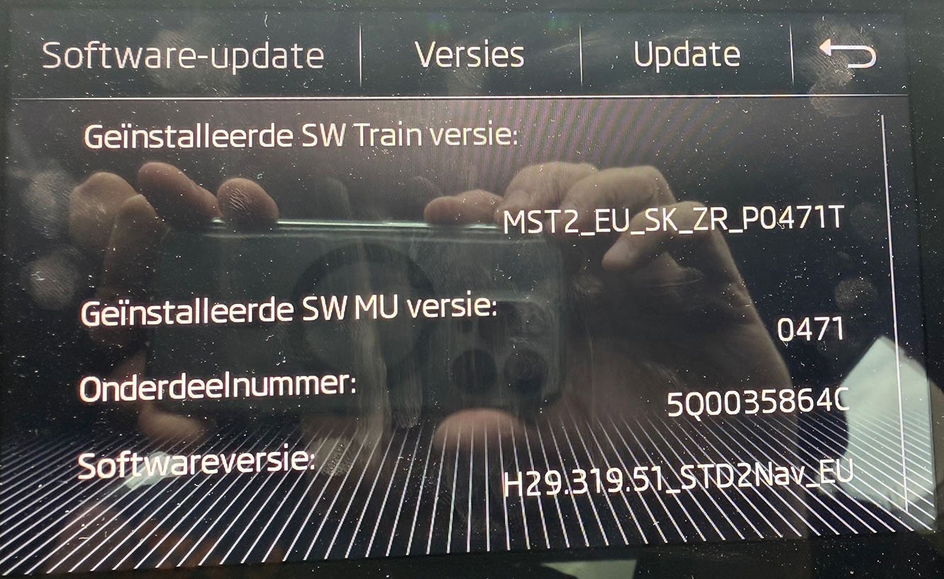

This is my system, Can anyone help me with the MST2_EU_SK_ZR_P0480T firmware to update to 480? Thanks!
