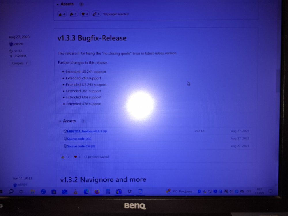

Yes yes I know github.
But I don't know how to download the Toolbox version.
I downloaded version 1.3.3 which I read should work with my radio.
But I would like to be sure.
Please confirm that this version is correct.
See photo
I don't use it at all so someone else has to confirm but if this is the newest version then IMHO you should go with it.

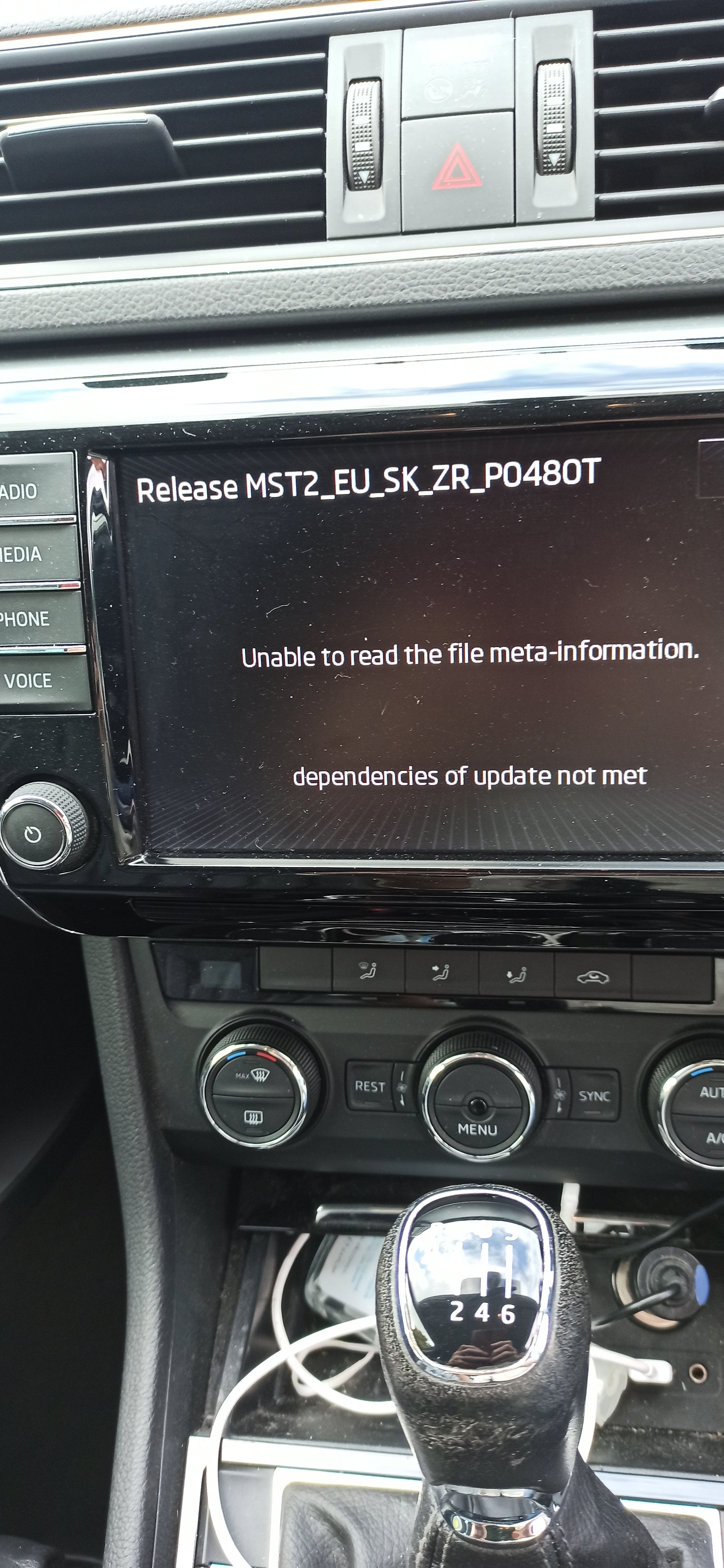

@pab567 Hi. Thanks for the file MST2_EU_SK_ZR_P0480T which I downloaded and put onto SD card this morning. Tried to update system but it came back saying unable to read metadata info.
I formatted SD card (quick format) with File system FAT32 and allocation size as default. Any thoughts?
It looks that you are trying to update from SW version 02xx or 03xx - this is not possible unless you patch your unit first.
Oh OK. I'll look into that then and see what I can sort out

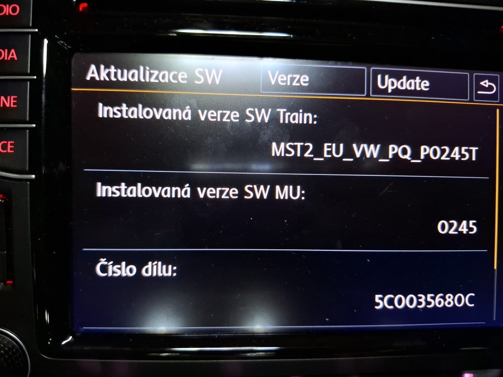

Hi everyone,
so I have confirmation that for the update from 245 to 480 you need Toolbox and even version 1.3.3.
Unfortunately I overlooked one thing.
I have version MST2_EU_VW_PQ_P0245T
And the downloaded 480 software from pab567 is for version MST2_EU_SK_ZR_P0245T
The problem is in the letters PQ (multivan t6)
And ZR (octavia for example.)
The difference is in the unit located in the radio or separately in the passenger compartment.
Please can someone give me a link to download the new software for Multivan? That is for MST2_EU_VW_PQ_P0245T
Thank you very much
