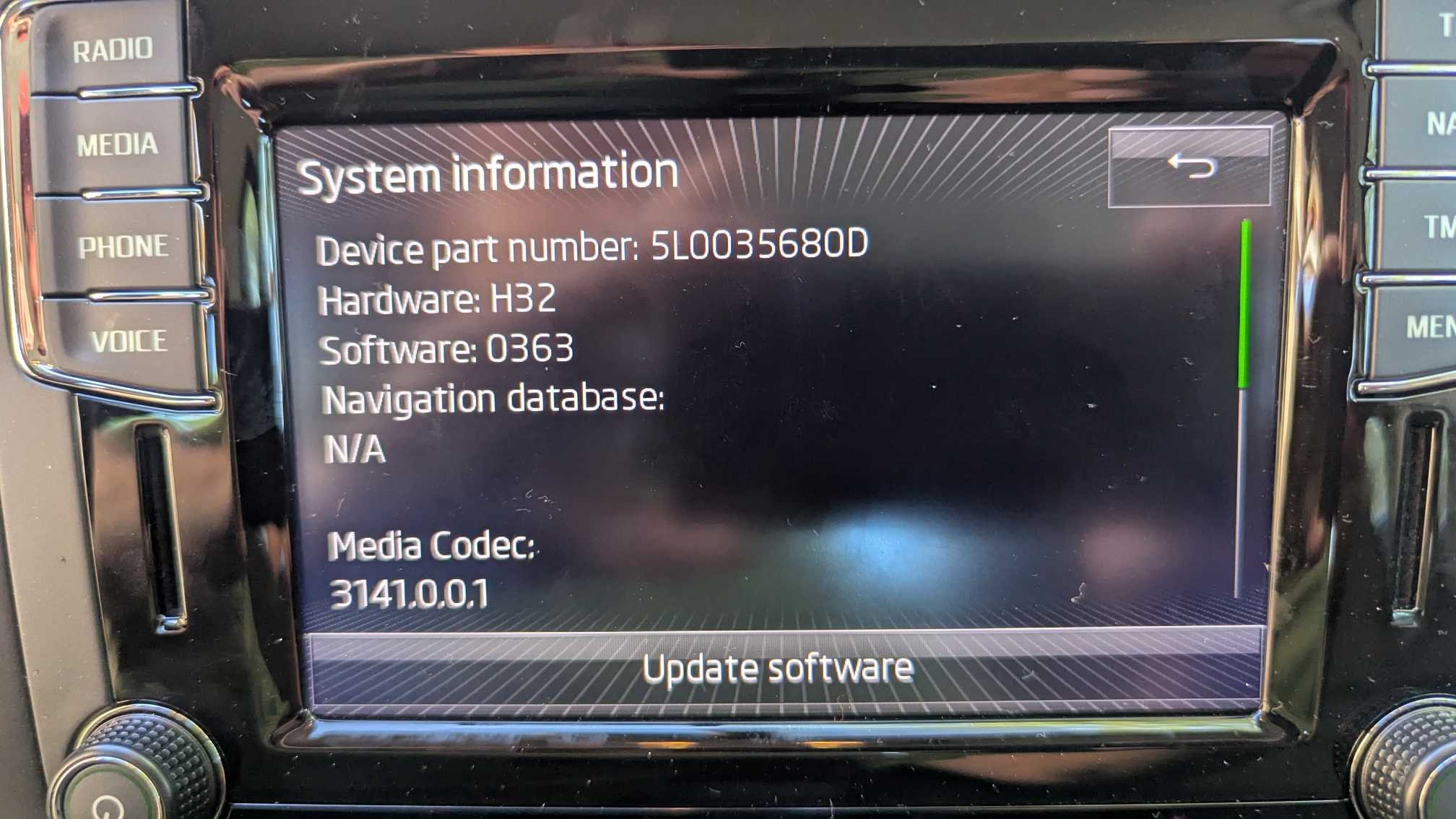

Hi @pab567 im looking for firmware update for my newly purchased used VW Caddy, the software details are as below
Hardware: H41
Software : 0475
Device part number: 5K7035200L
Media codec: 4101.0.0.0
I would appreciate your help, having problems connecting apple car play using Baseus Wireless CarPlay Wired to Wireless CarPlay Adapter
Sent in PM

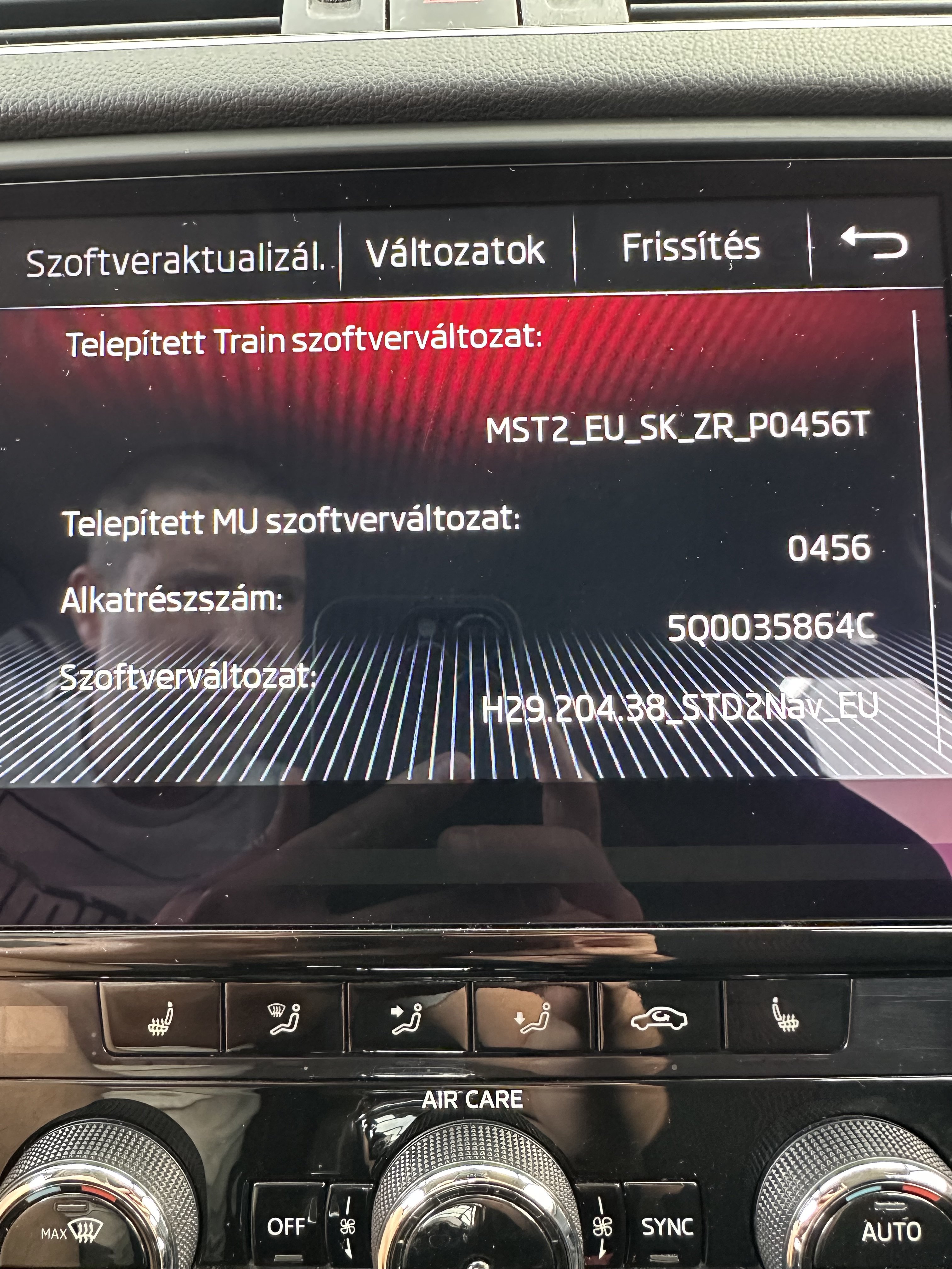

Dear @pab567,
I’d like to update my 2017 Octavia I just bought, as I am aware the latest software is 0480, my current is:
Hardware: H41
Software : 0456
Device part number: 5Q0035864C
Train: MST2_EU_SK_ZR_PO456T
I would appreciate your help, my software seems to be old+sometimes airplay drops connection
Are some detailed instructions available how to perform the update? Don’t want to brick the unit, I love this car
Thank you in advance!

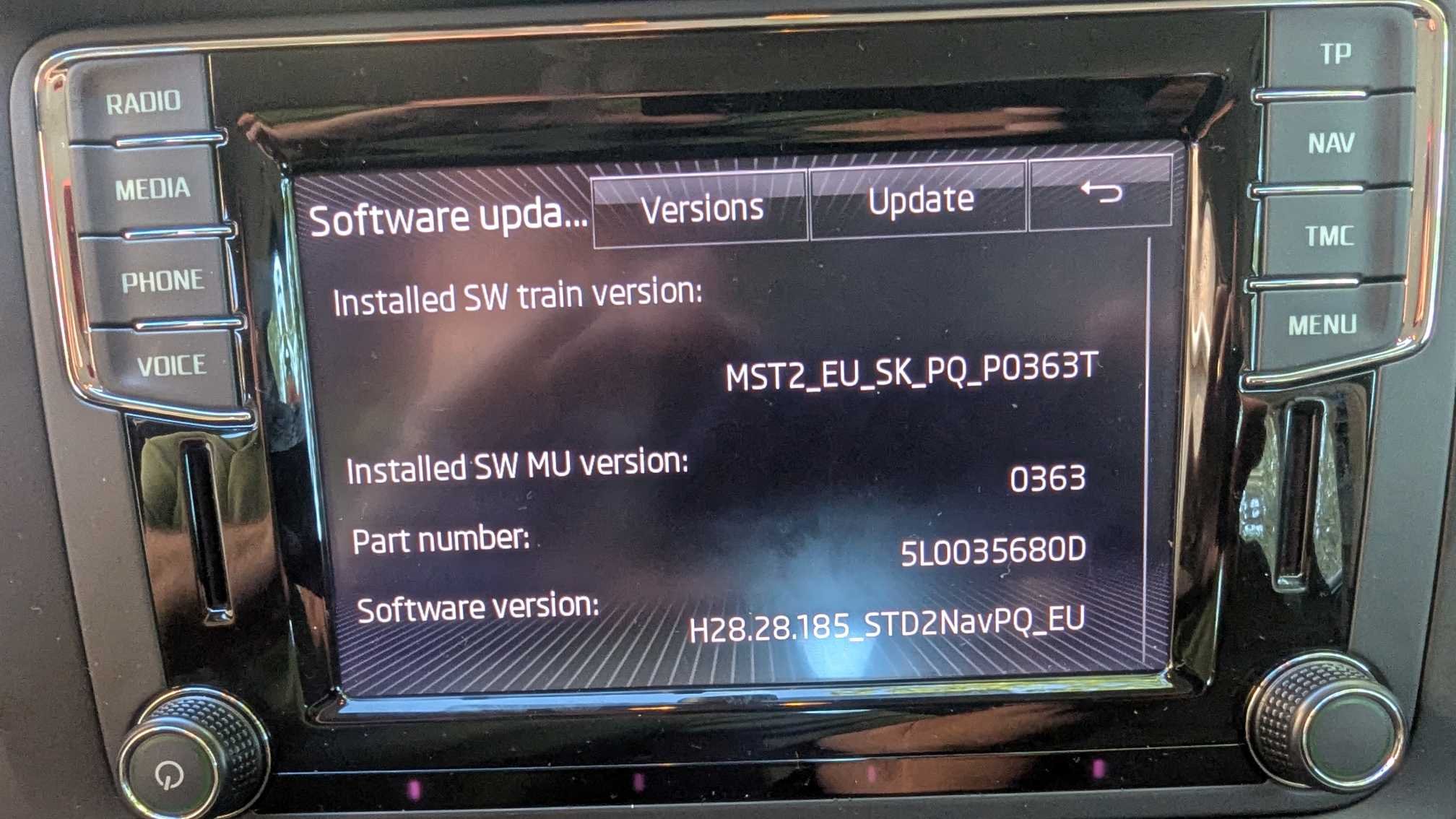

Hello pab567!
Have just bought a 2017 Yeti with the following firmware.
Is there anything to update?
Also, not got Smartlink on the options - is is possible it's not even capable or just needs activation.
Thanks so much for what you do here.
All the best
Jon

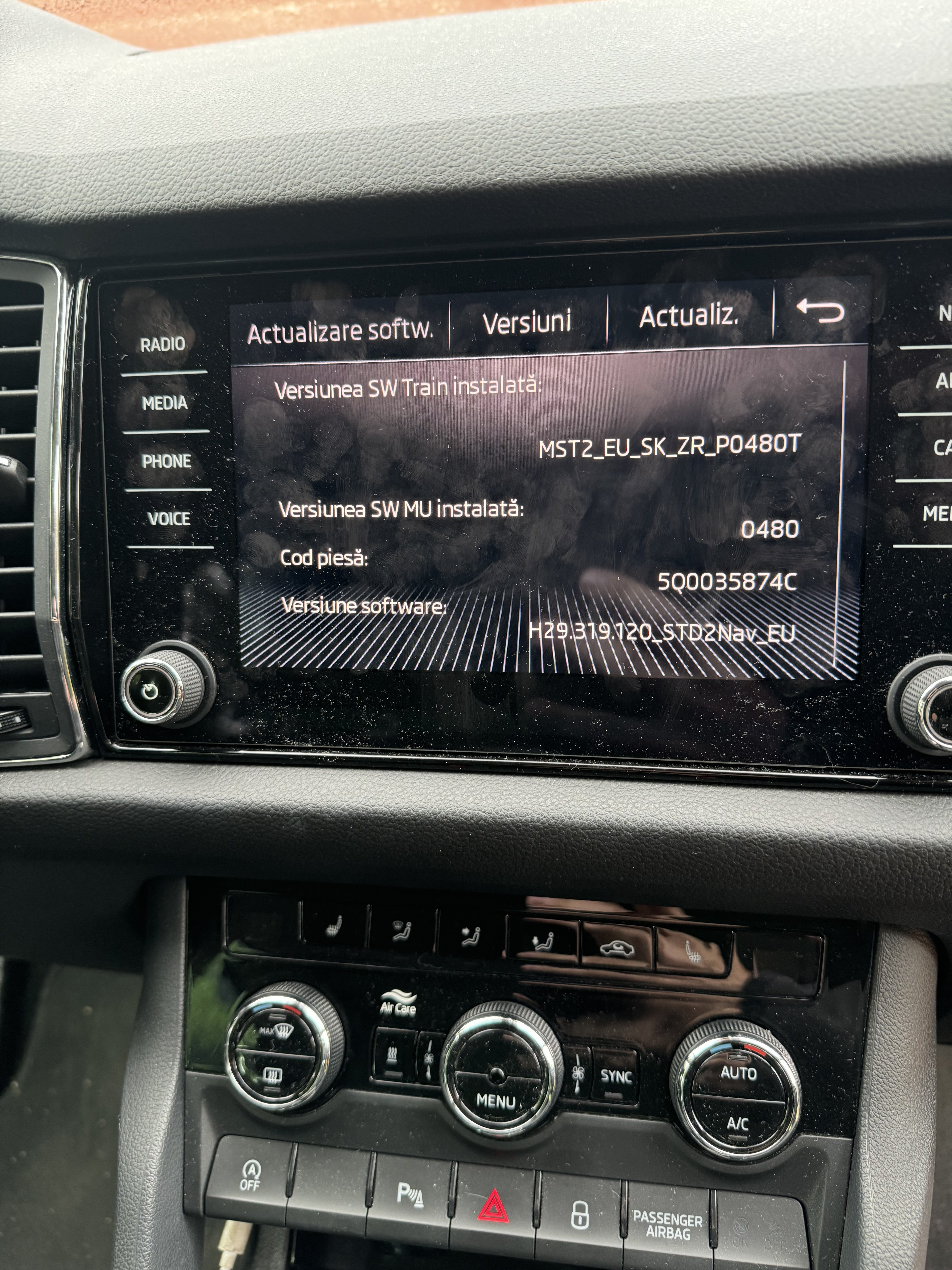

Hello @pab567,
I have an Kodiaq 2019 with an Amundsen that have the following Specs:
Hardware: H41
Software : 0480
Device part number: 5Q0035874C
Train: MST2_EU_SK_ZR_PO480T
Software version: H29.319.120_STD2Nav_EU
Is there any update for it?
This is the latest Version
Nope, you are already on the latest firmware available.
It is capable of SmartLink and you can do it by yourself with MIB STD2 Toolbox.
