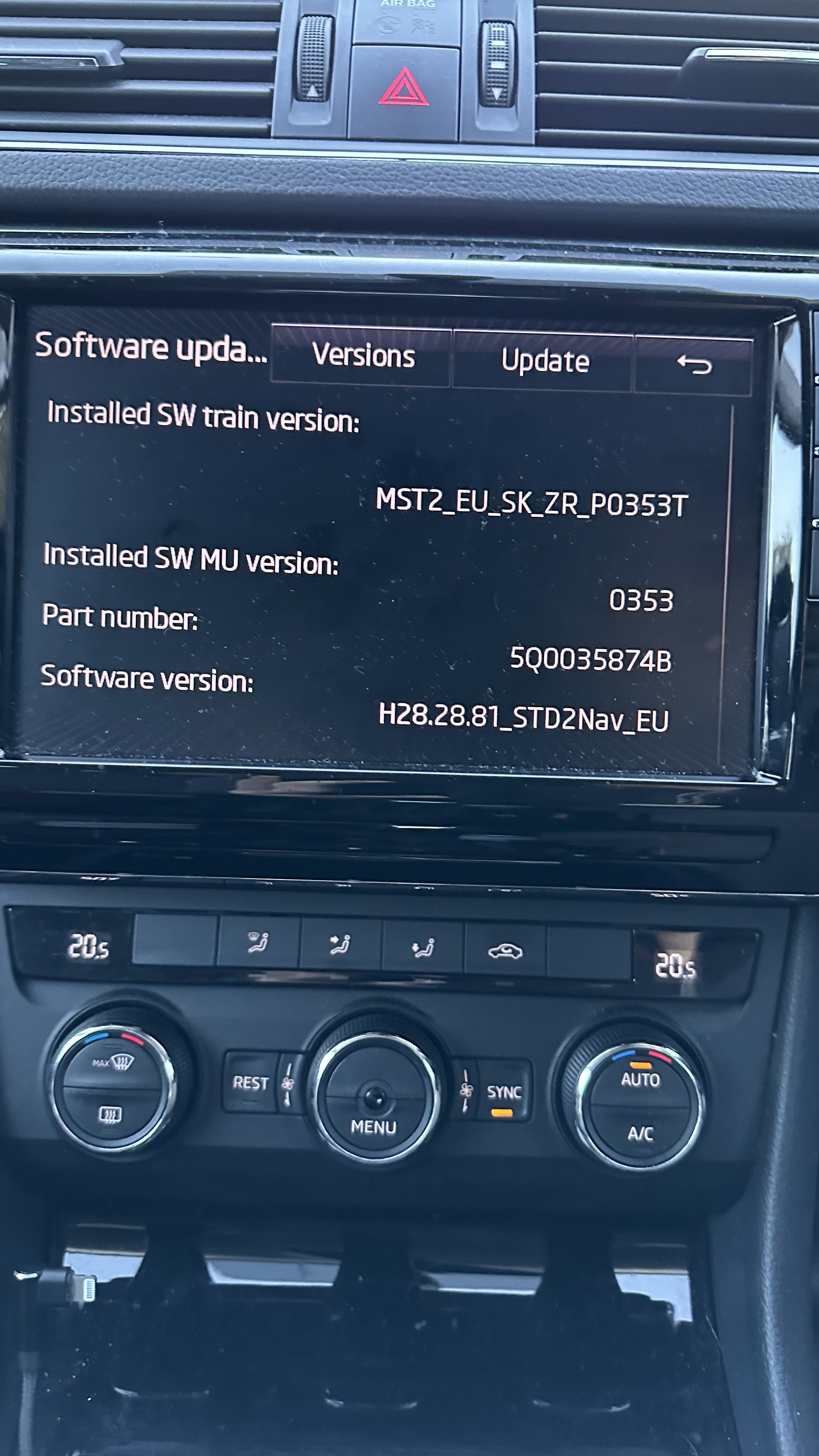

38 minutes ago, Kingbrit said:
Is this the correct screen?
Thanks in advance!
Yes I will send along 0369 version in PM
Use this location to update firmware

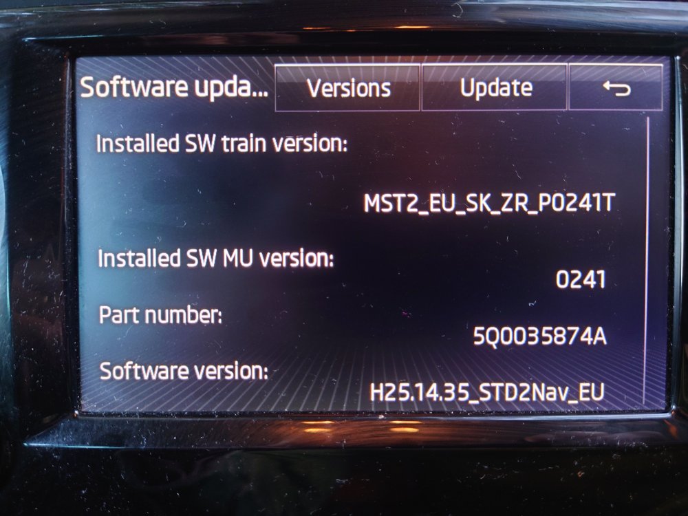

Hello all!
Is there an update available for my Amundsen? See picture.
Thanks in advanced.
17 minutes ago, ThomBrink said:
Hello all!
Thanks in advanced.
Morning, press and hold down your Setup/Menu key for about 10 seconds to get into the engineering menu, this has Software Train, and also the correct firmware update button.
Odds are, you can update to 0369 version.
Thanks! Can i download the 0369 anywhere? Menu say "... nothing found on sd-card ...".
I can send you 0369, but ideally you should verify your Software Train information first.
Yours should be
MST2_EU_SK_ZR_P0359T
Available
MST2_EU_SK_ZR_P0369T

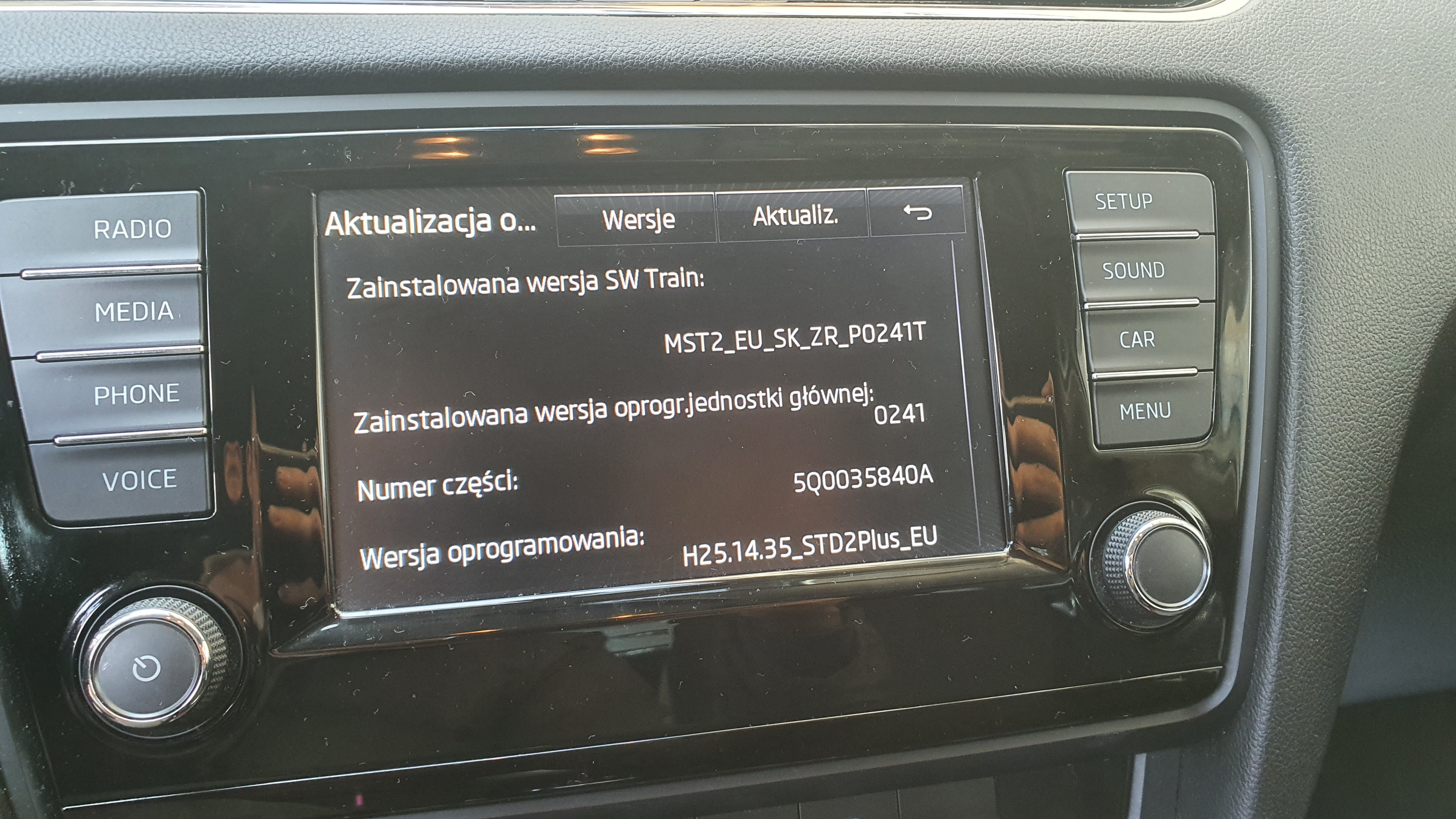

Hello all,
I'm having various freezes on my Amundsen - any idea if an update would help and if so does anyone have a link to a newer version?
I'm on SW 0241, train version MST2_EU_SK_ZR_P0241T.
Thanks!

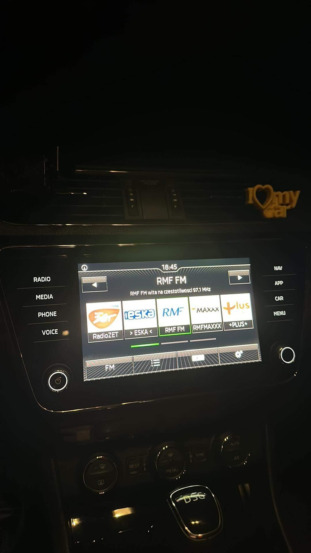

Hi.  I recently changed the display on my superb.  Apparently it should show 6 radio icons.  Is there any soft or leave it as it is?  Soft radio 0253

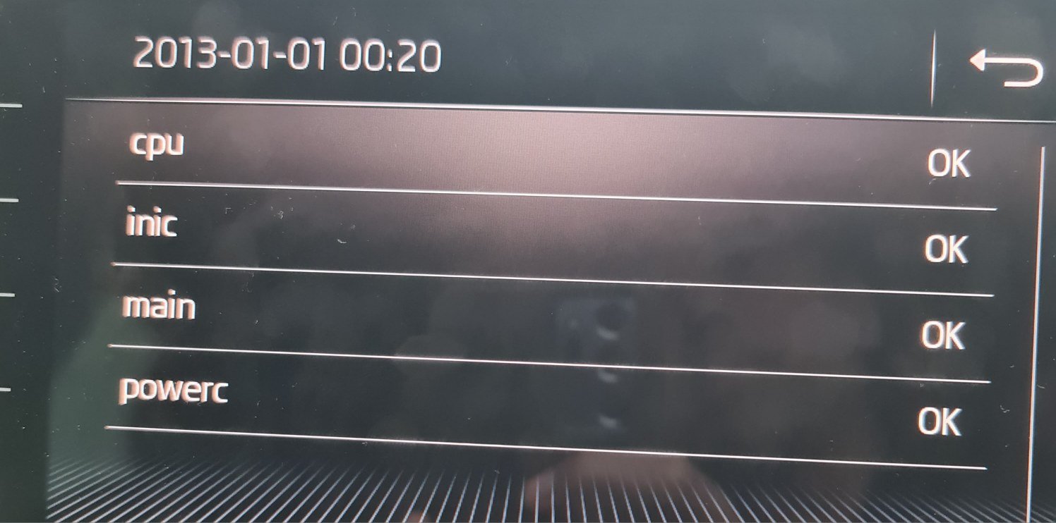

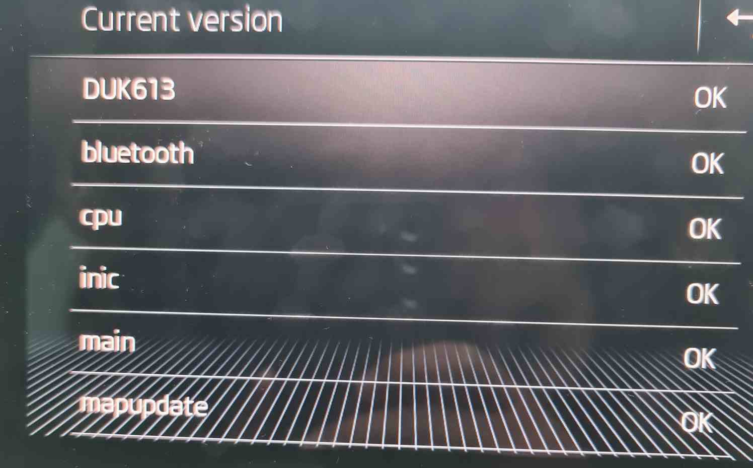

Hi, in engineering menu when I press 'versions'
I uploaded the picture
Might this help
Thanks
On 20/11/2022 at 11:54, London_Jock said:
Hello all,
Thanks!
I can send you 0253 version for you
Check your PM's
Might this help
Thanks
Sorry was taking a weekend off for family time.
Remind me what media you are using for the update?  SD Card or USB?
In theory you could use FAT32/exFAT/NTFS format for the firmware update, though I usually recommend the first two.
Have you got a picture of the files on your update media?  If you have a folder called MST2_EU_SK_P0480T then that won't work, only the contents of this folder should be copied to media.
I use sd card FAT32 and exFAT
When press 'MST2_EU_SK_ZR_P0475T(0475-1)
Only 4 files showing
Cpu
icici
main
powerc
Cpu
icici
main
powerc
When pressing current version
MST2_EU_SK_ZR_P0475T(0476)
On 17/11/2022 at 18:16, banderboy said:
Hi, I am new to briskoda
There's new software update for my skoda karoq 1.6 se technology
Many thanks
This is the screen you should be in for updating, the other menu you're referring to is the history of updates applied.
Might be an idea if possible to send a screenshot of your SD Card contents, in the 'root' you should have a single text file, and then about 30 or so folders.
