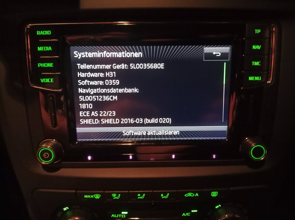

mst2_eu_sk_pq_p0359t is there a new software?
What is the difference between PQ and ZR? Can we use them alternately?
None that I can see

VW Seat have one which is PQ_P0369 can I use this one?

So VW and Seat both have PQ_P0369T why Skoda don't? Any chance that I can use their firmware to update my?
I would not recommend sticking on the VW/SEAT firmwares.
At the least the skin would be different, though that's not a big issue... but no idea what else has been changed under the hood.
Chances of bricking your unit would be high IMHO.
It might well exist but that doesn't mean it's freely available online. Skoda don't publicly publish the updates so it relies on someone with a copy redistributing it.
The best way to check is to sign up to erwin, buy an hours access and check the TPI against your VIN. If there is an update it will show there and a Skoda dealer should be able to apply it :)
If they are friendly, you can always ask for a copy so you can help others.

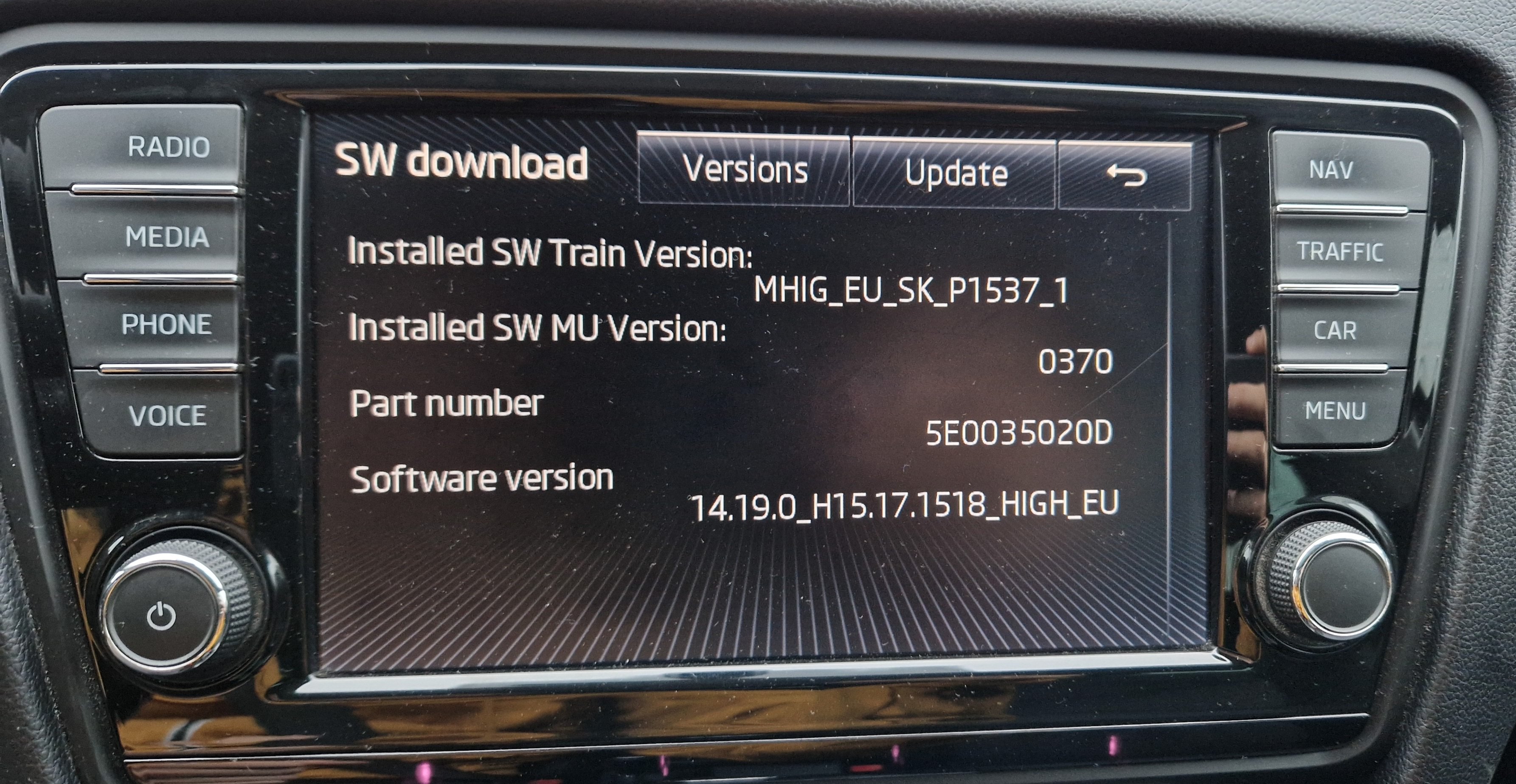

Is there anything to update this?
Hello!
Can I ask for latest firmware version:
39 minutes ago, DomelisK said:
Hello!
S00.1000.17.99
release = "MHIG_EU_SK_K1552"
MUVersion = "0411"
I will send you a link to this update
