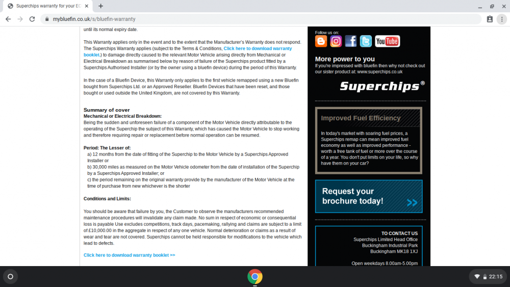

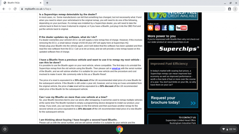

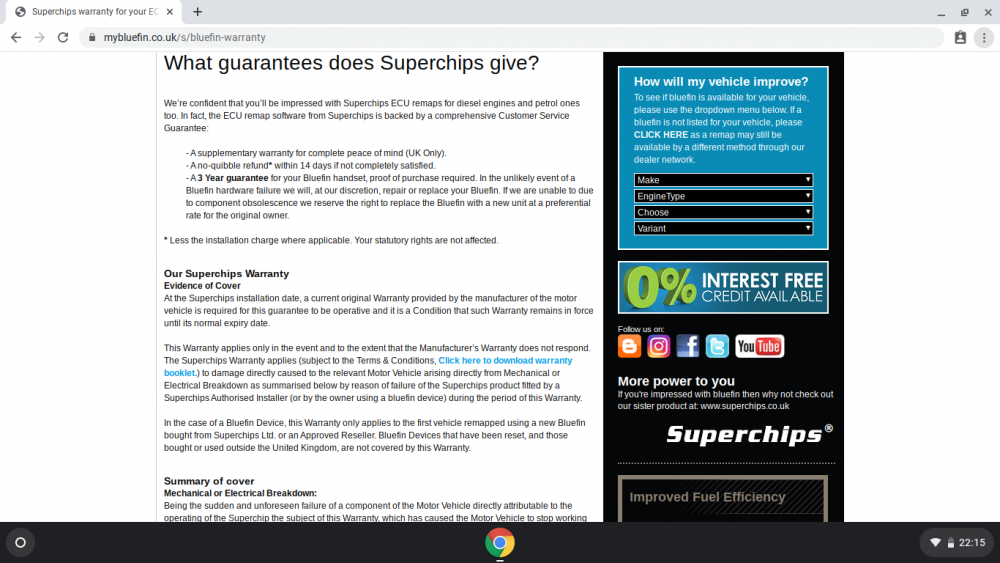

I think I'm gonna try a remap by Bespoke Remapping Ltd who use Black Code maps. Discussion with them suggests I can get a much improved throttle response using the 'Economy' map for greater torque. It's got a 14 day money back guarantee so looks like I can't lose. Will probably get it done early March so will update on this thread later with the outcome.
