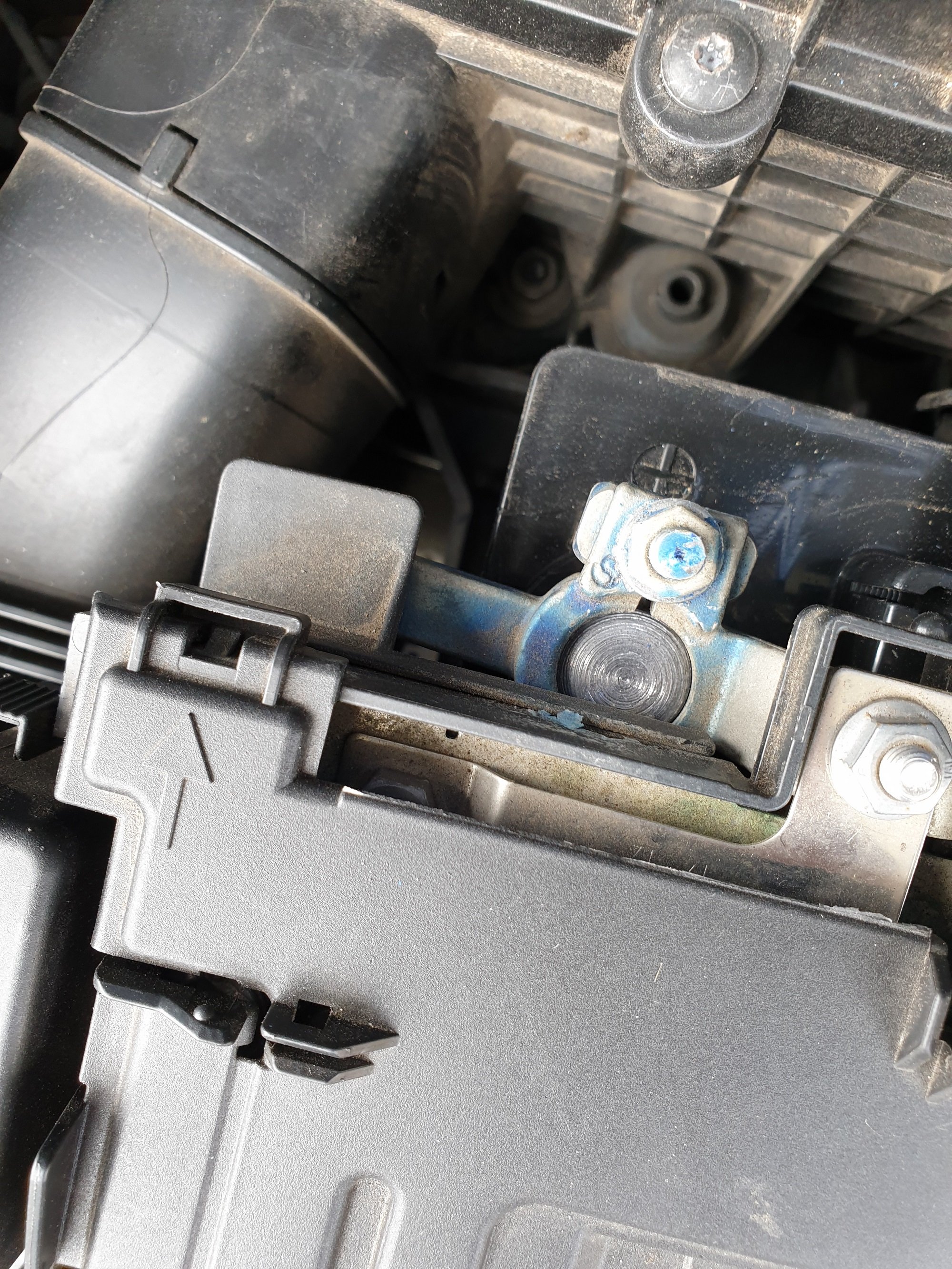

How do I remove this thing on my battery?

But I'd still like to replace the battery in hopes that that's all the issue is. I'm just not sure how to go about removing the plastic stuff covering the terminal with out breaking it.

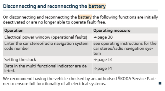

got a copy of the owners manual as a pdf. and had a look though.
You would only need to remove the two battery terminals and the plastics will come away with them.
Remove the earth (-) first, re-attach last is the golden rule. The positive (+) on the left of the photo, just behind the black plastics, once loosened by its nut, will just pull up and off, along with the fuse panel etc.
There will then be the retaining bolt, in front of the battery around the centre and at its lower edge/foot, that clamps the battery to the car. A bolt head with a small bracket. Thats what stops the battery from flying forward when you brake hard!
BTW, where all your plastics are, just where you can see the positive terminal, there should be a small black hinged cover, too. It looks there like it is missing. You would flip that up to actually get to the positive terminal and then flap it down, to prevent accidentally touching it with metal tools, etc, when working in the engine area.
They are replaceable and quite cheap from a main dealer, if it bother you. (Didn't but now it will)!

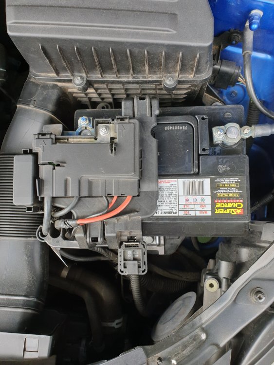

I got a new battery today and just got finished installing it.

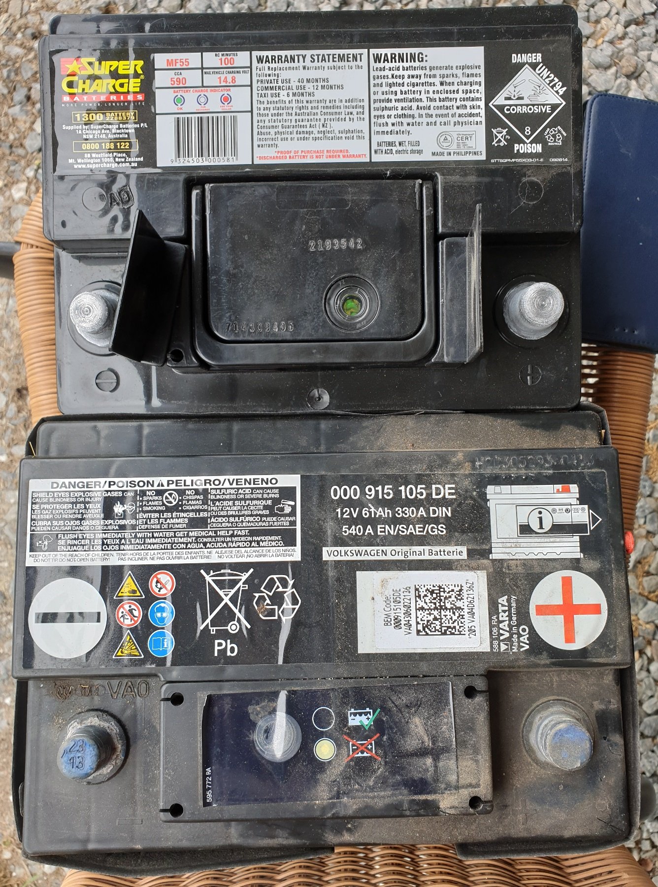

The battery is smaller than the one I removed but according to multiple sites it is the correct battery for my car.
the plastic clips don't connect to the battery like they did to the last one.
the positive connection doesn't fit as snug as it did on the previous battery either.
I also couldn't get the battery blanker/cover to fit around this new battery.

That positive battery post/clamp doesn't look right.
You might need to have another go at that, as that could possibly overheat as it is.

That positive battery post doesn't look right.
Yeah, like I said.
I'll have another go tomorrow trying to push it down a little further but it really didn't want to go on in any other way.
  • Sponsor
Looks like the two parts of the clamp aren't correctly engaged on the side opposite that nut, somehow.
