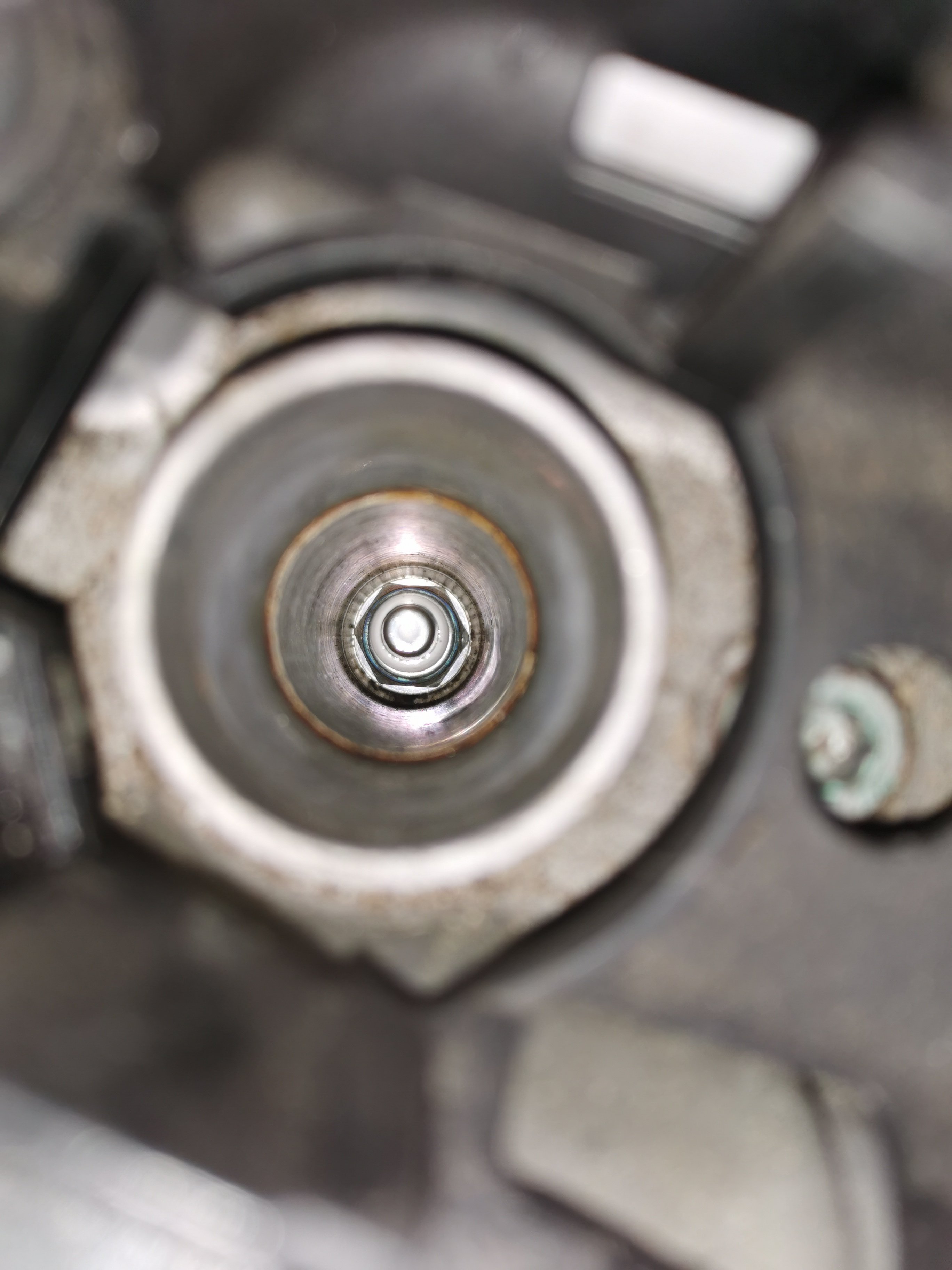

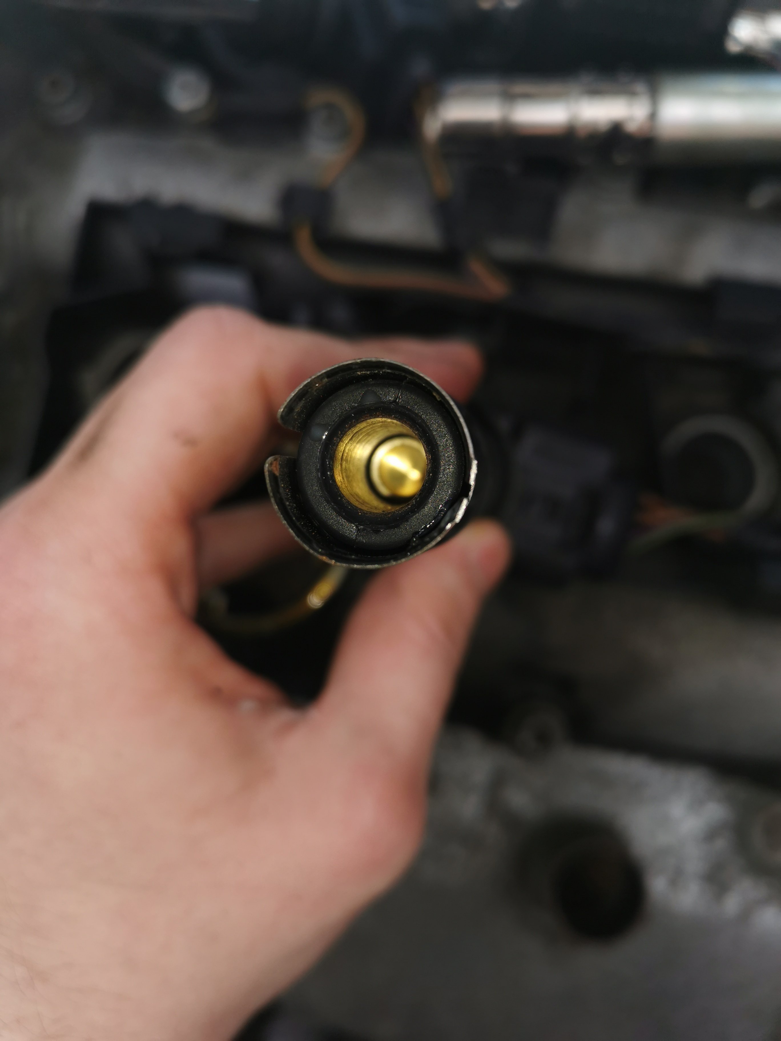

Think this could be it ?
Compared to the other three

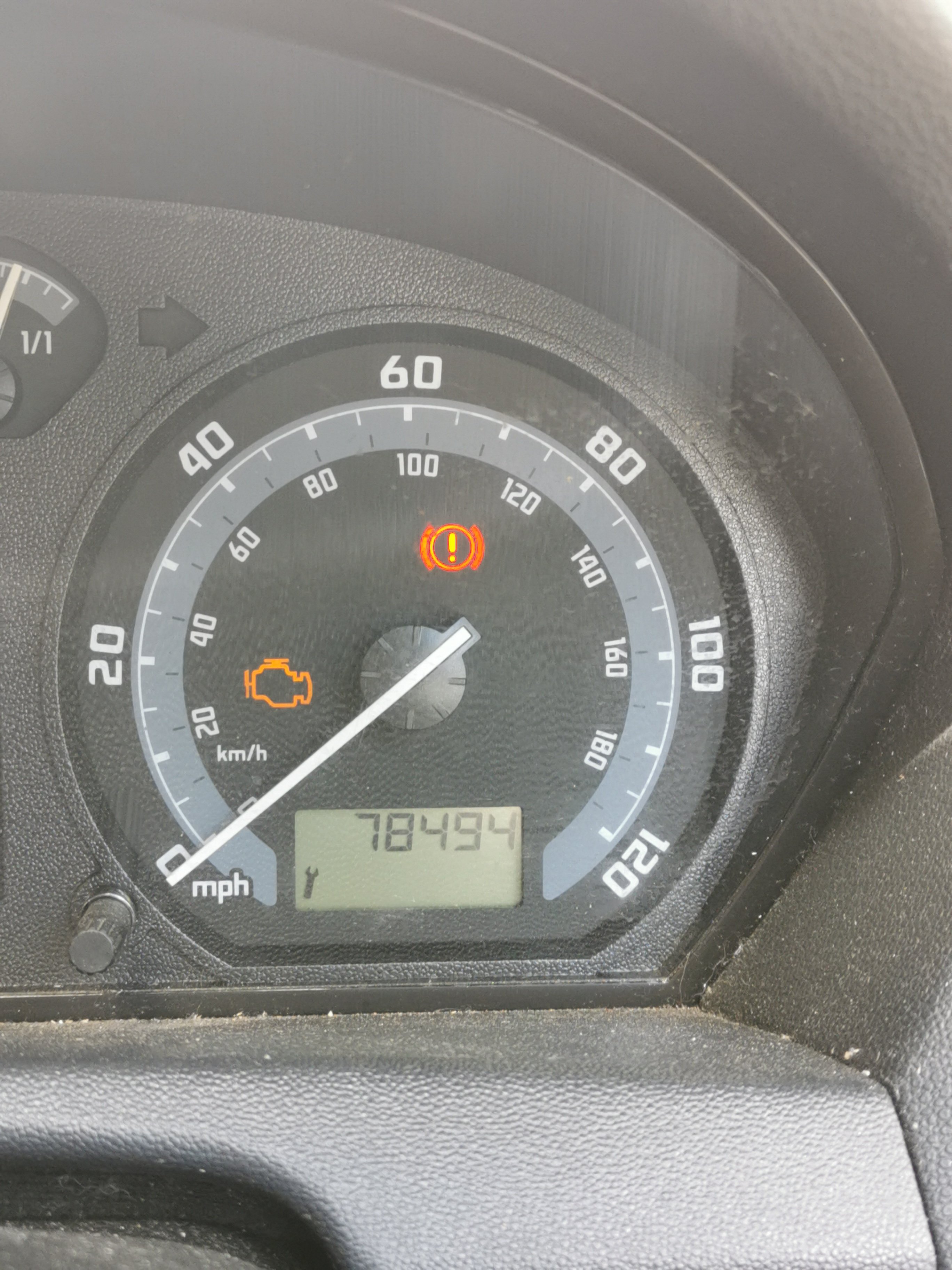

Seems fixed now normal noise , no vibration , but the exhaust system light still on?

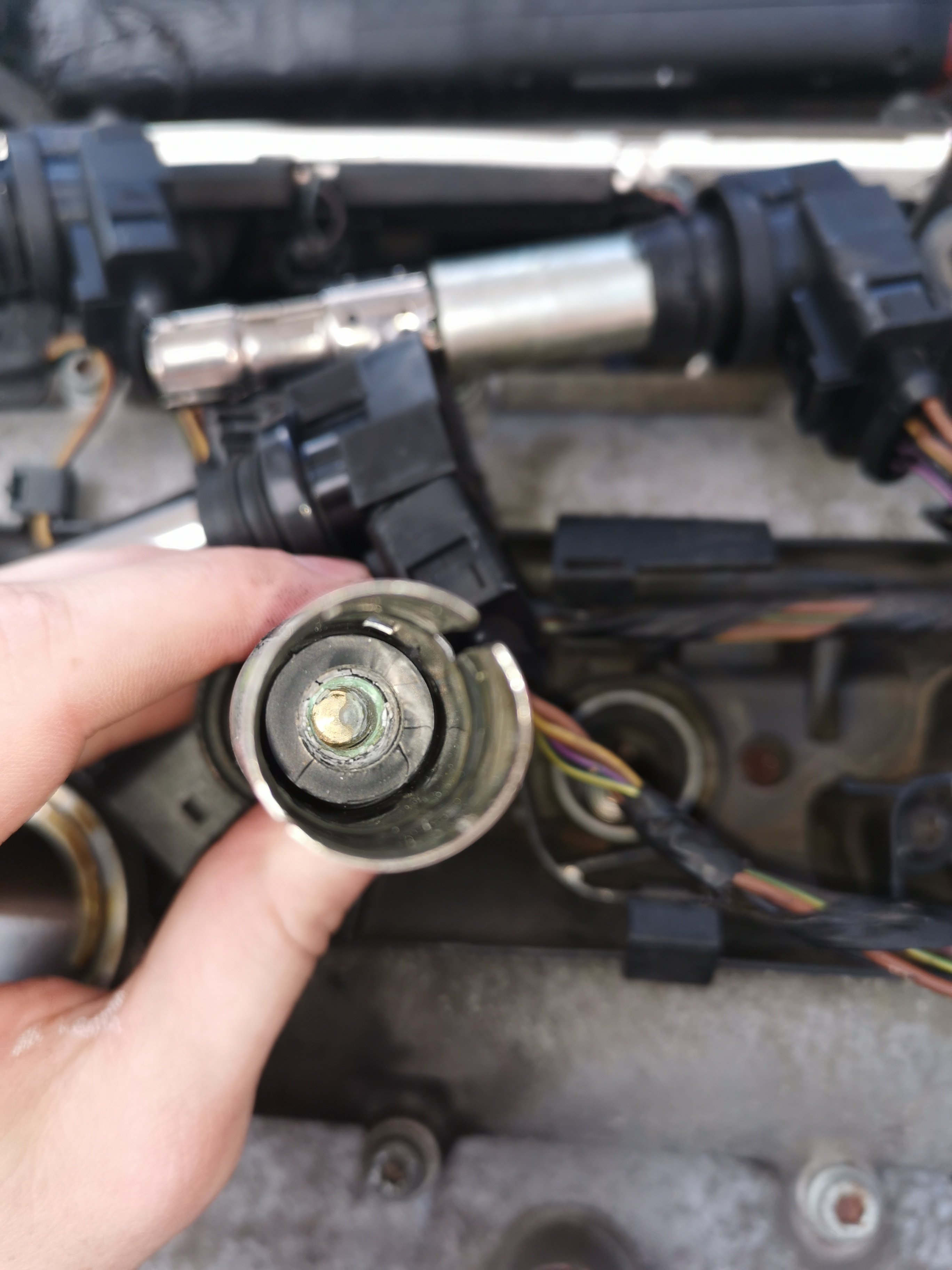

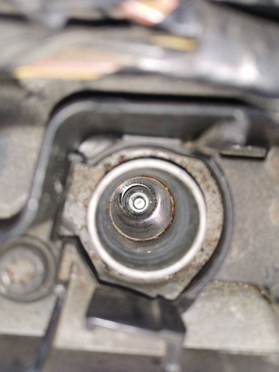

All fixed cheers, thank you !
