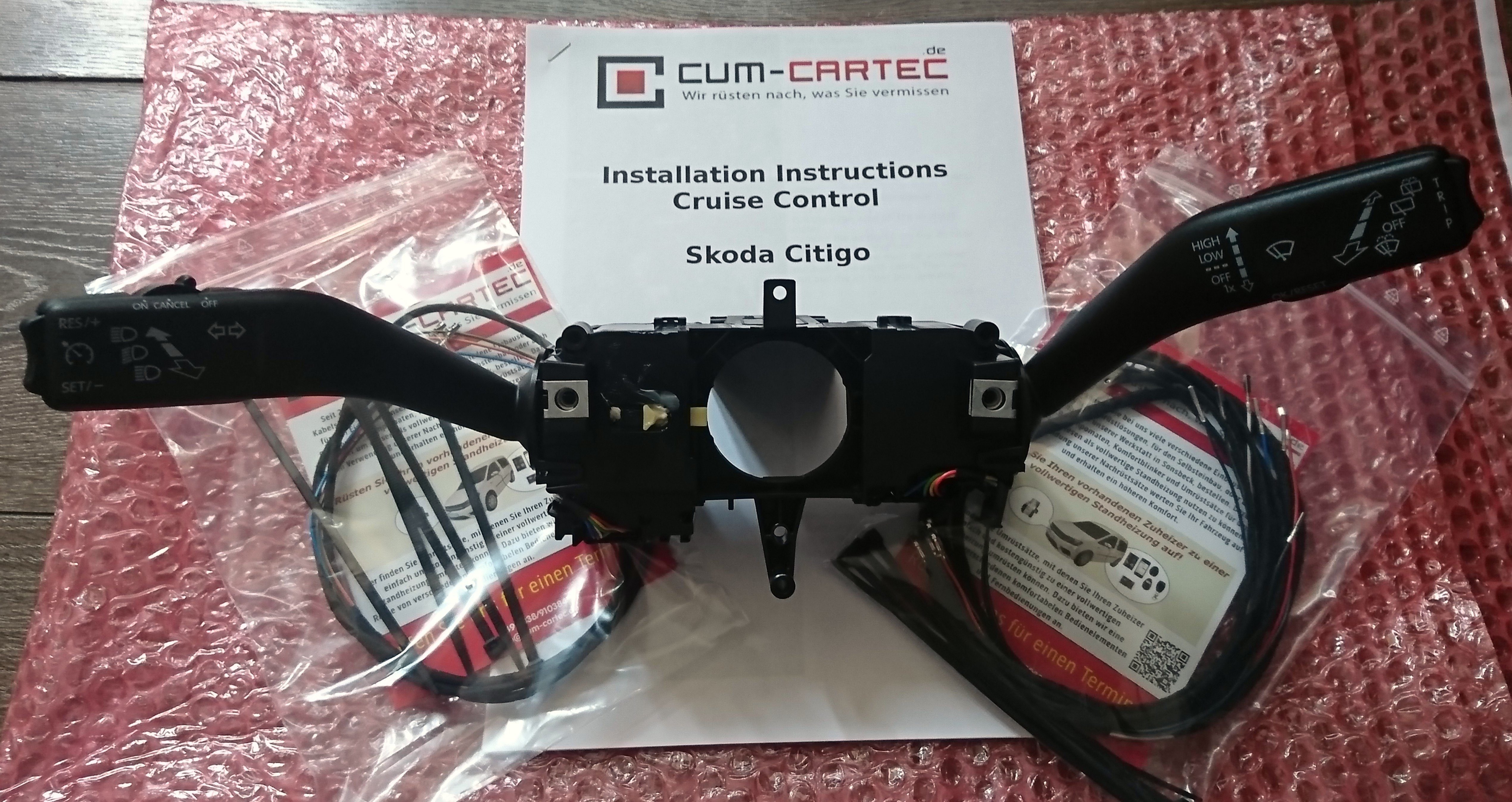

As mentioned earlier, here it is a write up on how-to add CCS to your Citigo.
Before you start your retrofit, You need to establish if you want to also add a stalk for your vehicle mutlifunction display. Its only 4 additional wires running indepentedly from Your replacement wiper/multifunction stalk to Your instrument cluster. If You will decide to add a full multifunction steering wheel buttons - you dont need those extra wires as it will be covered by the controls on the steeringf wheel. As mentioned in one of the previous post it will display additional information on your Speedometer such as current speed/average speed/current fuel consupmption/average consumption etc.
At this point it would be handy, to double check if Your Speedometer is supporrting additional information to be displayed. In order to do so, You will need a VCDS. You can check it simply by going to Your Instrument Panel and running your display test. It is not required to upgrade to maxi-dot display (white-on-black). You should get something similar after running the display test.
uc?export=download&id=1MIU0OtYZ9SIDrPdTu
Once You established what You want to achieve from Your installation below You will find major steps which needs to be performed in order to achieve fully operational CCS/MFA.
Once Your kit arrived, You need to start from removing Your airbag and steering wheel. There is plenty of Youtube tutorials on howo to remove the airbag, so I will post only brief description.
uc?export=download&id=10YLSuFJ9W0fdlhILz

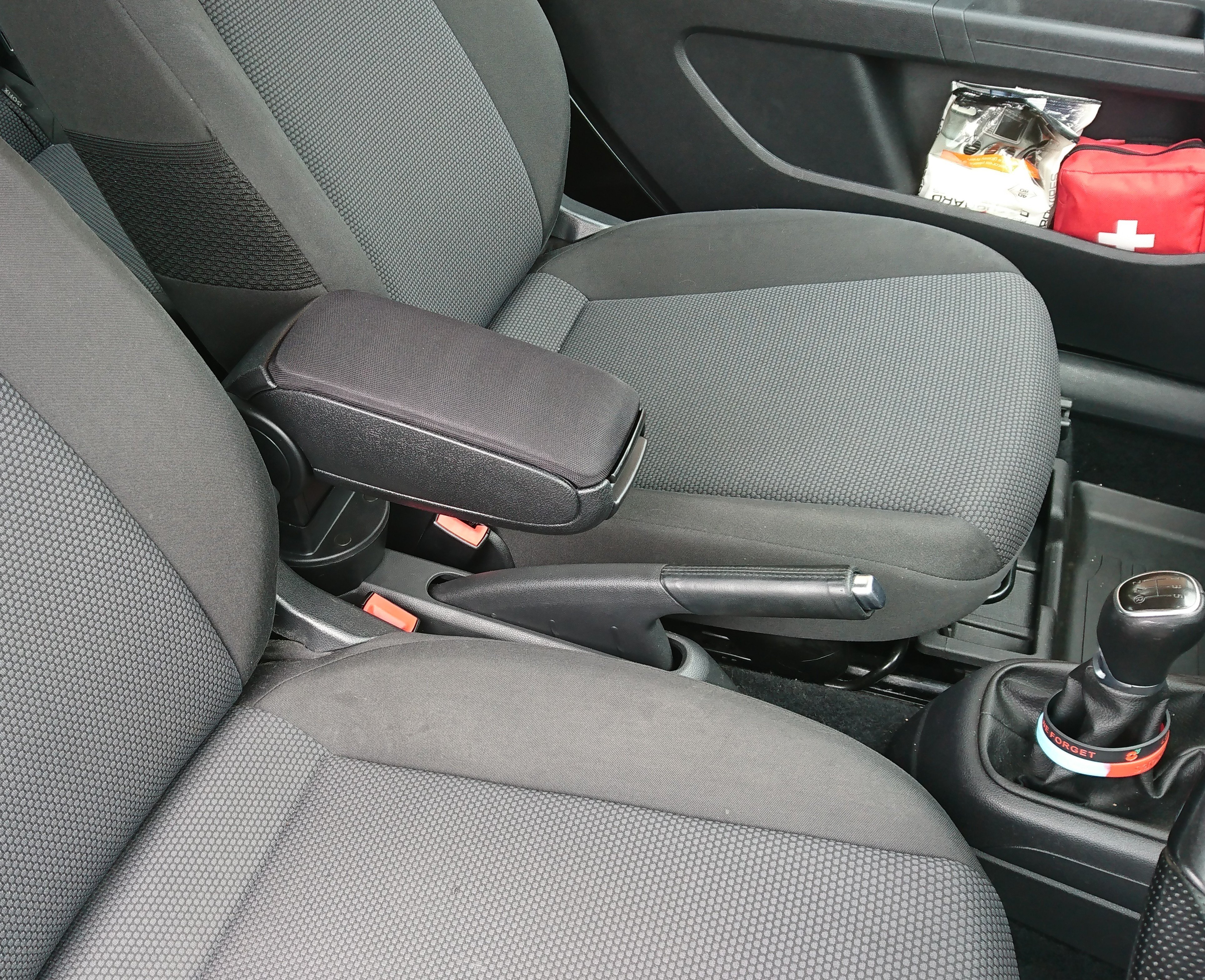

For further life improvements I can also recommend an arm rest. Goes nicely with CCS, so we can relax while driving 😉
Great shout!  That was the first thing I added ha!  Best £139 I've spent on the car,  really great quality of life upgrade, cant imagine driving without it now.  I'm even now looking into an if a mk3 Fabia seat would plug n play fit into the car for even extra comfort.

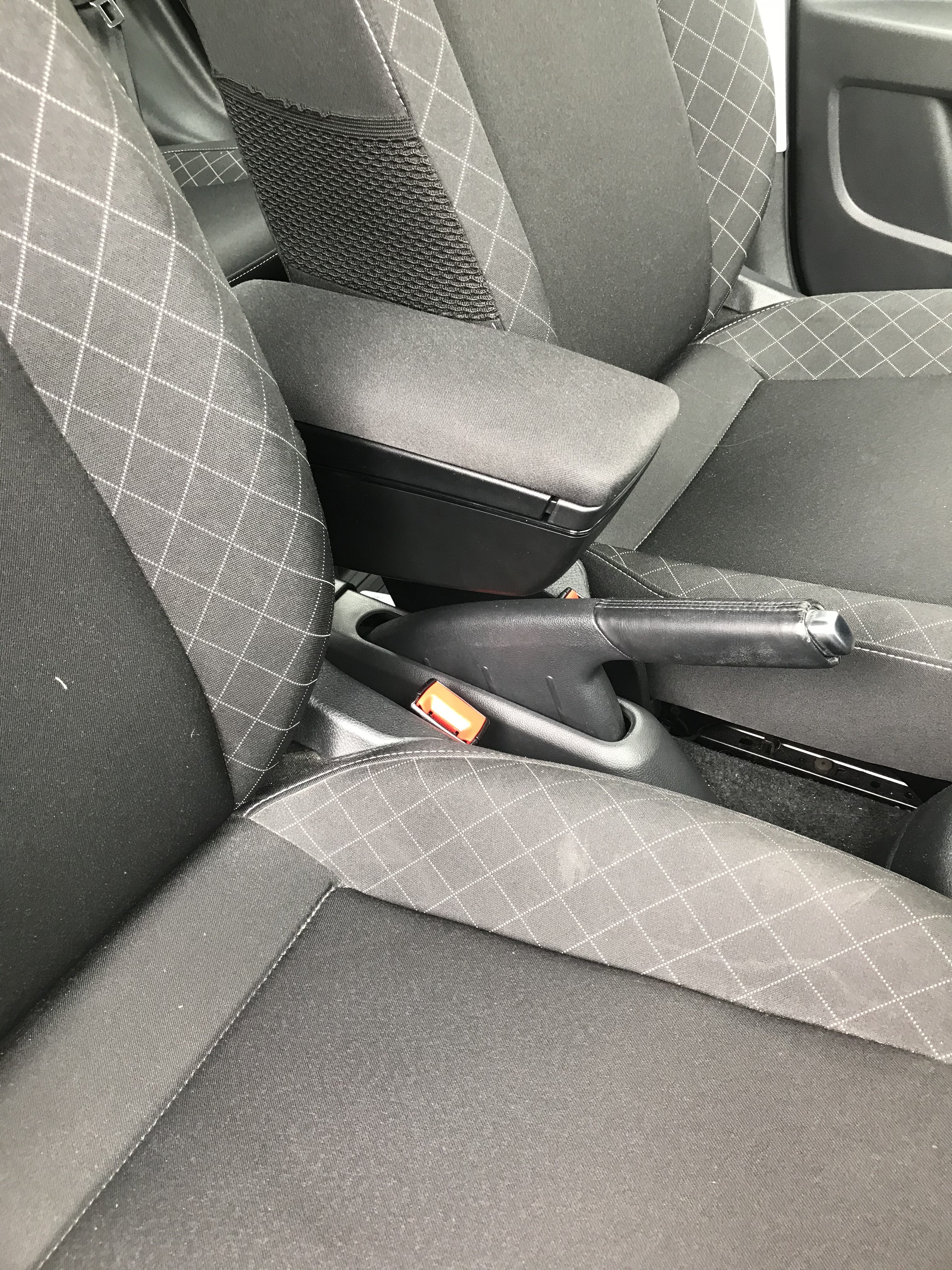

5D59508E-492E-4008-B3EA-820492EA4CECL0001.thumb.jpg.59c86decd613aeff9ea3a4a5a5a89ff4.jpg
@maxychatmy one costed me £49 and does the same job. And there was no need to chop the original center part in order to fit it. Its not as sturdy as the OEM armrest although it's supporting my arm quite well as I'm not a big bloke. 😂
