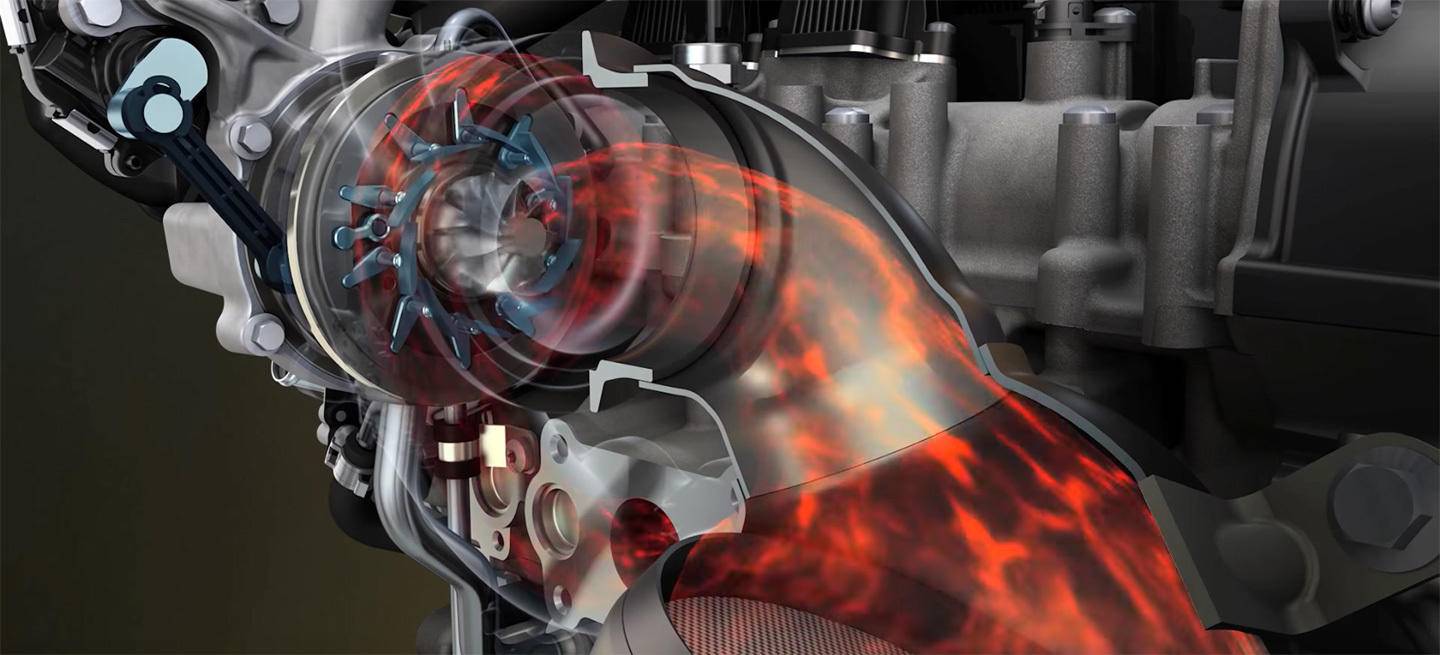

For now, I think all the problems mentioned here could be solved by a variable geometry turbo, as someone suggested earlier. Shouldn't our efforts focus on that?

1.5 TSI Variable Geometry Turbo. Shouldn't be too complicated to adapt it mechanically. To have the electronics handle the extra actuator properly, probably much more complicated, but at least in theory, possible.
