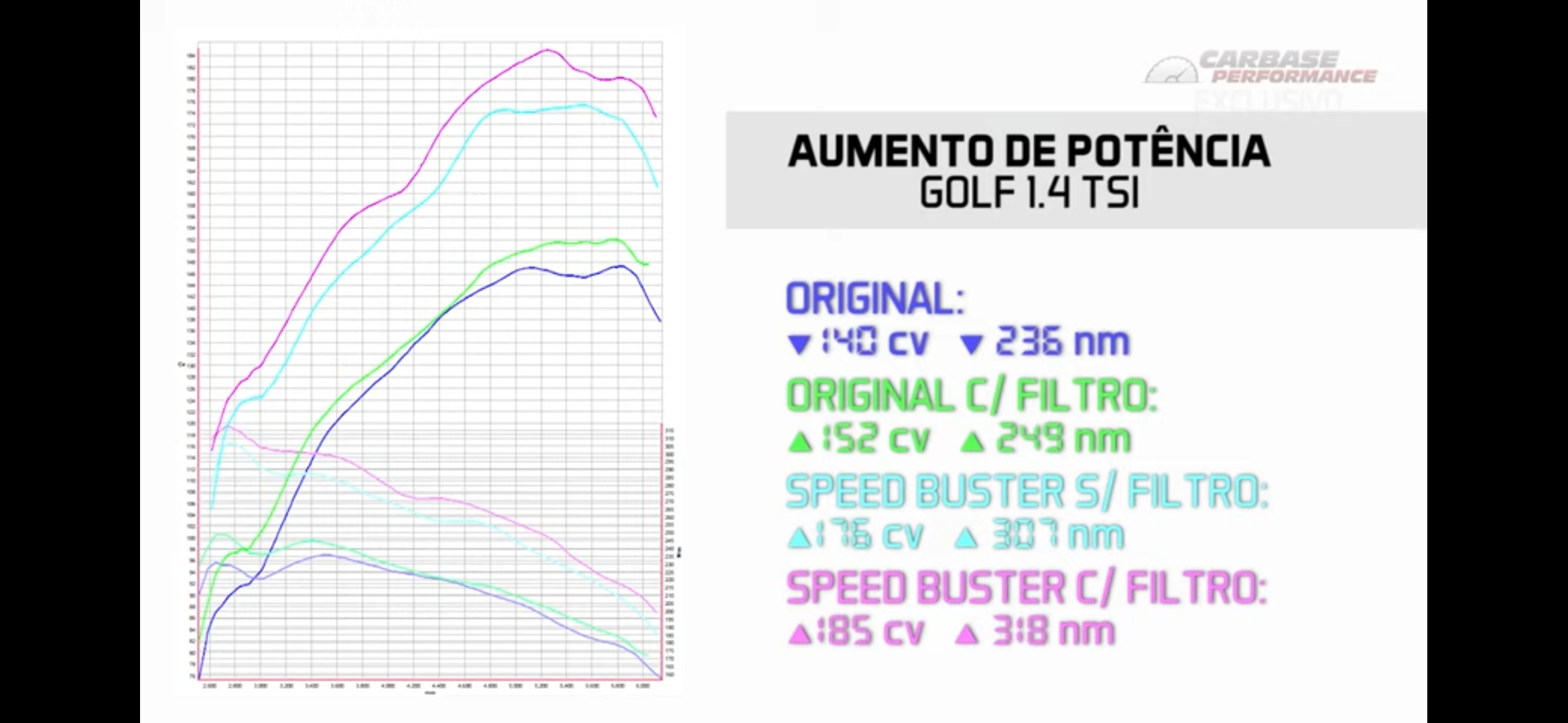

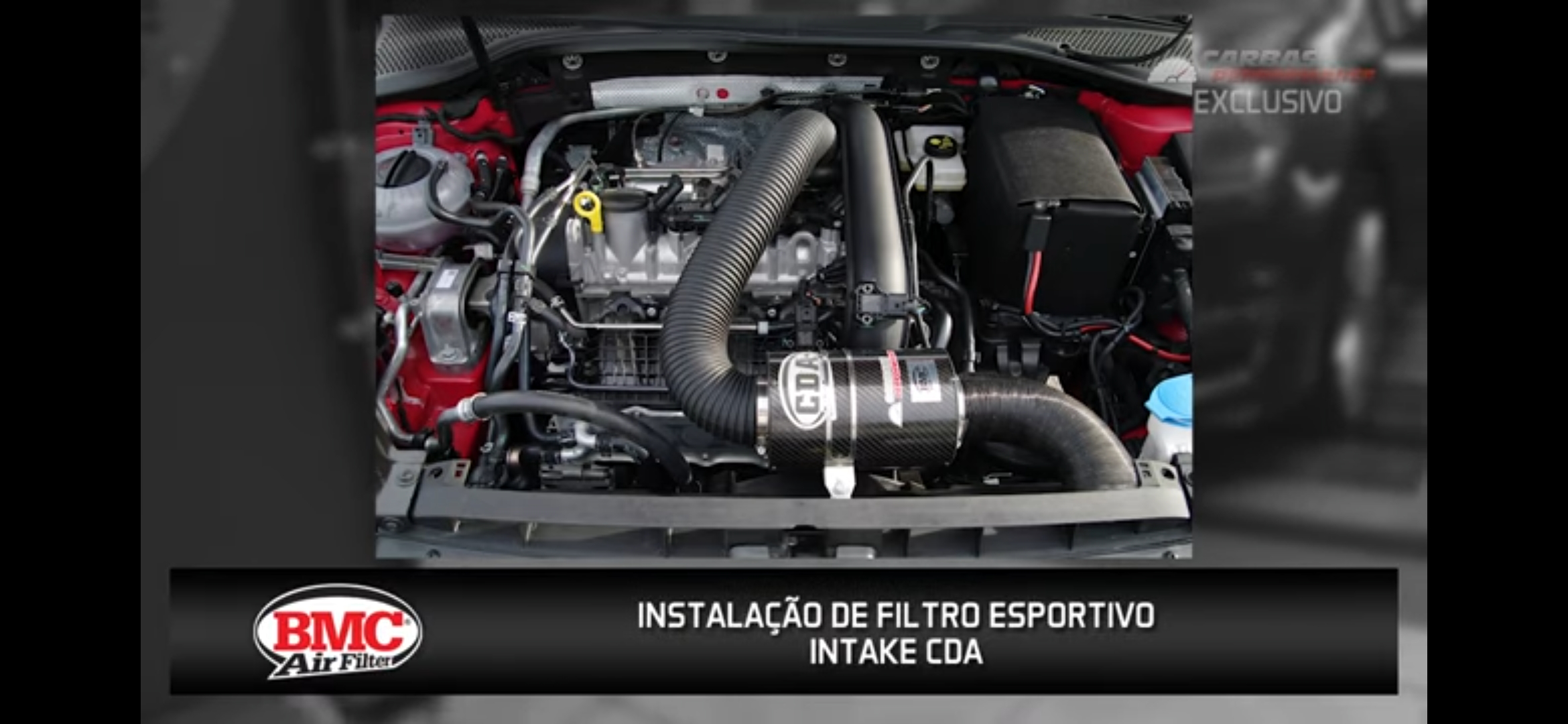

There is no way i'm getting those fancy and expensive kits :rofl:
I found this +10hp BMC CDA, there is a cheap chinese knockoff i can afford :notme:

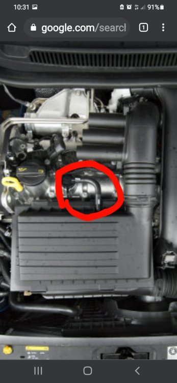

I cannot seem to understand the function of this piece, is it a pcv? I already connected an oil catch can to the pipe that goes to the turbo.
Can i just put a breather filter instead of plumbing it back to the intake?
This one only needs a breather filter, fresh air goes in this bit from the filter housing.
The foam covered pipe that goes into the side of the turbo is the bit what needs a catch can.

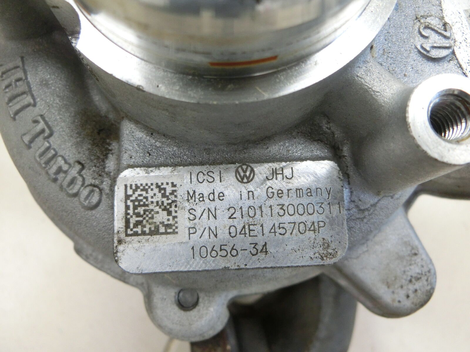

Hey guys, I'm new here! I'm driving 1.2 tsi cjzc polo mk5 5 MT
Today I buy 1.4 tsi turbo (04E145721B).
I'm planning to do next things:
- decat
- custom downpipe
- installing 1.4 turbo
- remap
After I read this topic I found out that it have some issues with 1.4 large turbo but dont understand what's the problem actually.
My target is to achieve around 150 hp and make car running with enough boost all the way. (I dont like the way car running in stock especially after 4500 rpm).
Can someone explain what issues I can face with 1.4 turbo and is it worth to install it if I already buy it.

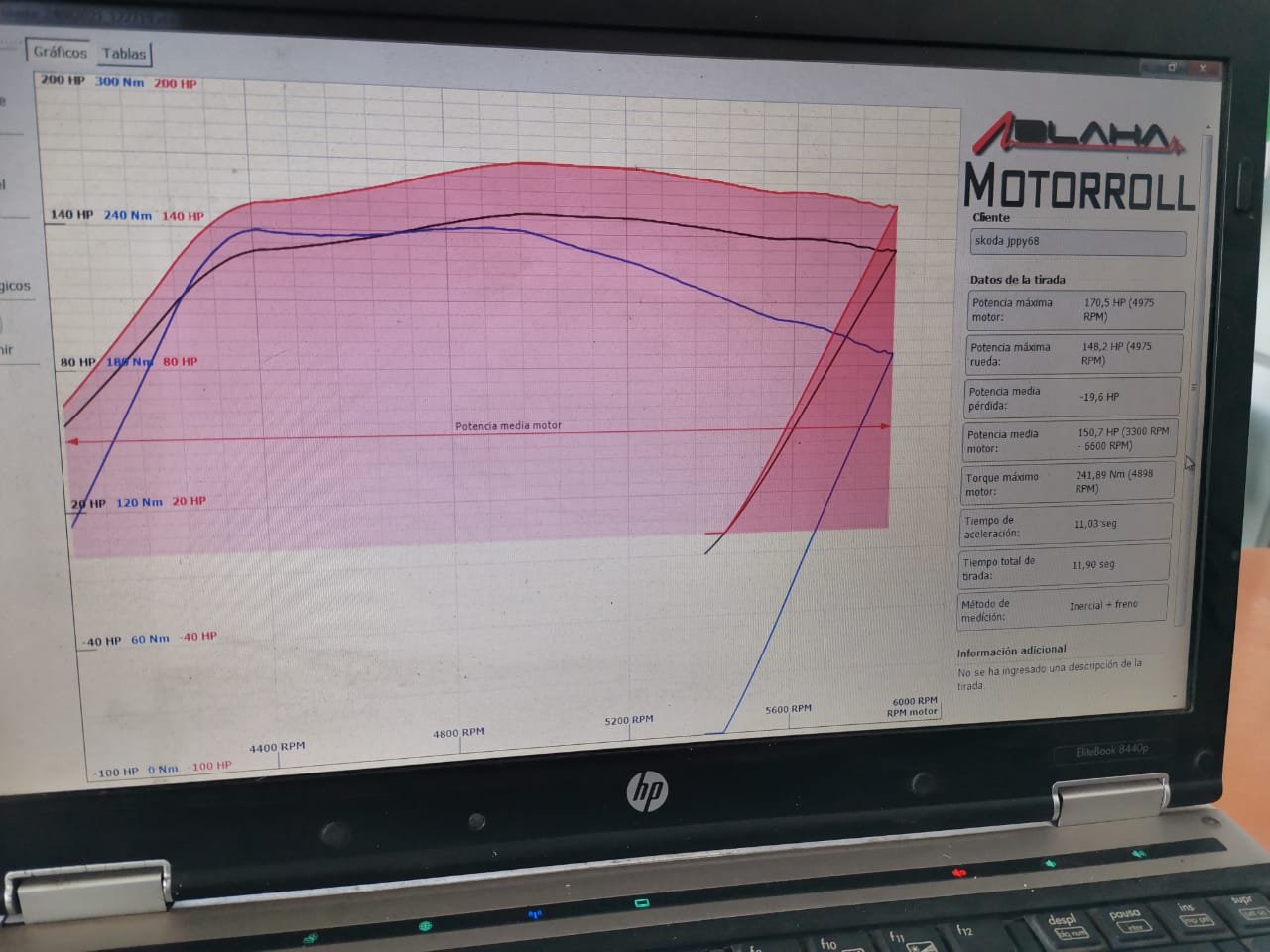

I have the 1.2tsi and I installed that turbo plus downpipe, apr coils and I'm with stage 1 revo and got 170hp and a good torque line.
How long u drive thi setup? (How many miles\kmh?)
U drive MT or At transmission? Any issues ?
Mt and 45000km

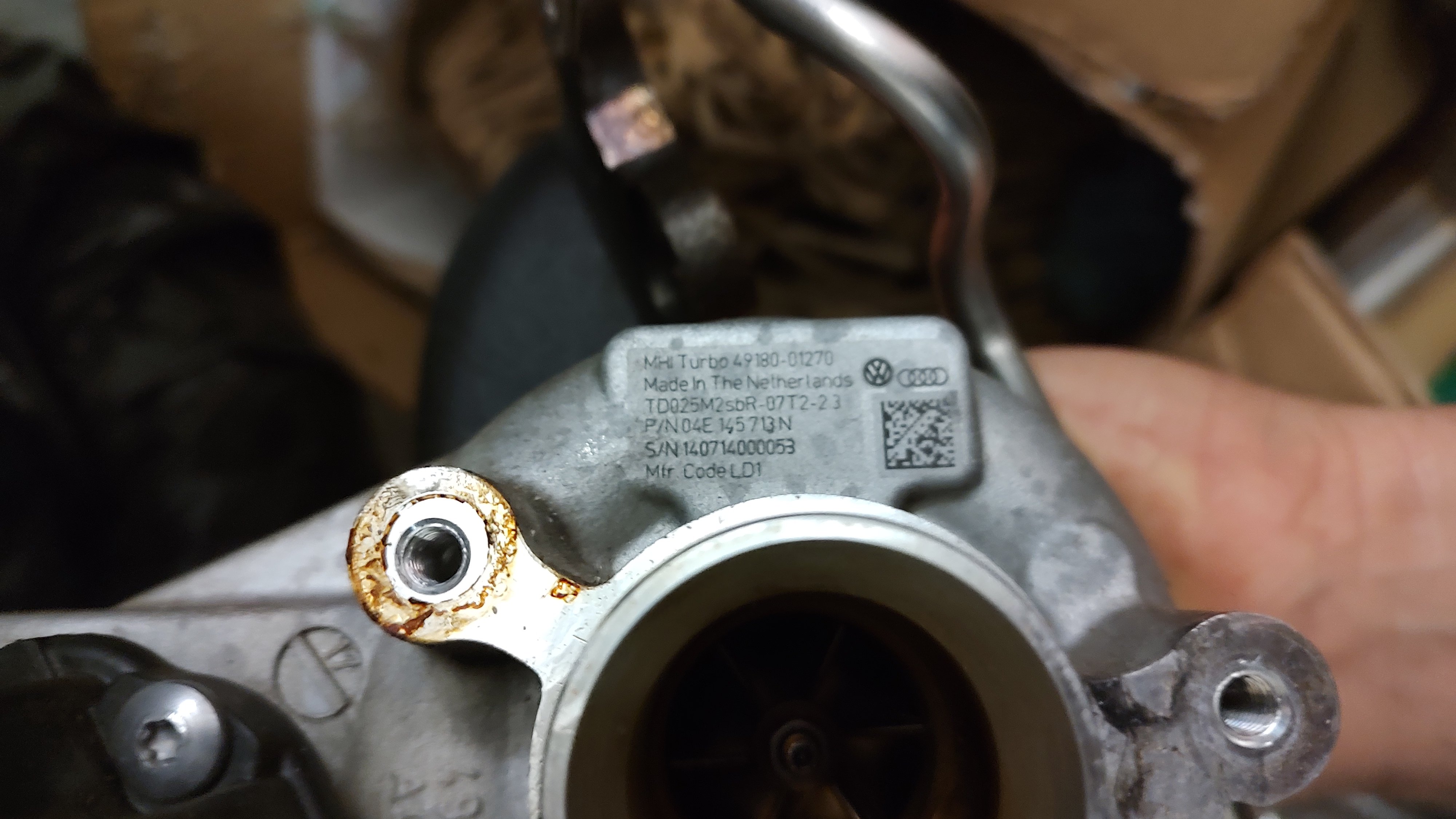

Hi all guys I am new to the group, I have a Skoda Fabia 1.2 tsi 2016 1 month ago I bought downpipe and turbo taken from a 1.4 TSI 125 hp ... unfortunately I have only now read the list of turbos ... So if I mount this turbine does not change anything from the original?
I leave turbine code: 04E 145 713 N
Thank you
